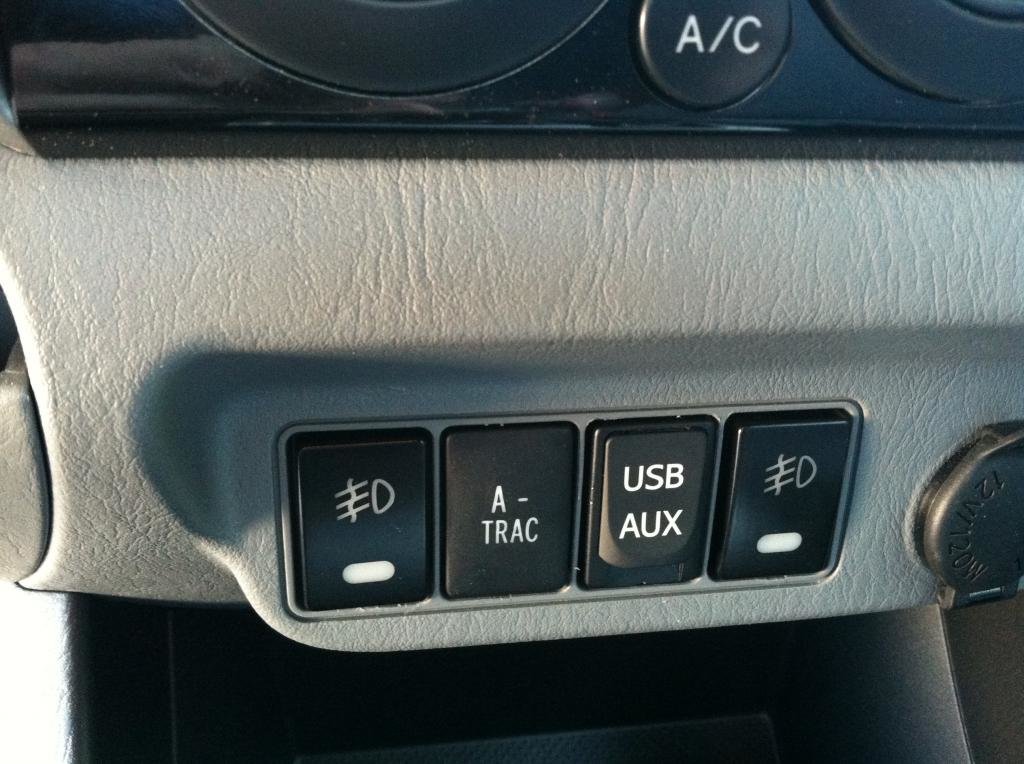

    You can purchase the fog lamp switch from Toyota and use that as an auxiliary switch if you are running extra lights.
    I have these from www.tundrapart.com under my HVAC.

    Those are Tundra switches ?

    Not OEM Toyota, no. They're part of an aftermarket kit for Tundras. I've posted elsewhere my experience with the pieces. Other members have figured out the actual supplier and ordered through them.
    I have one switch for my roof lights and intend to use the second for whatever I decide to run in front in the future. They fit in the blanks under the HVAC like they're OEM though.
