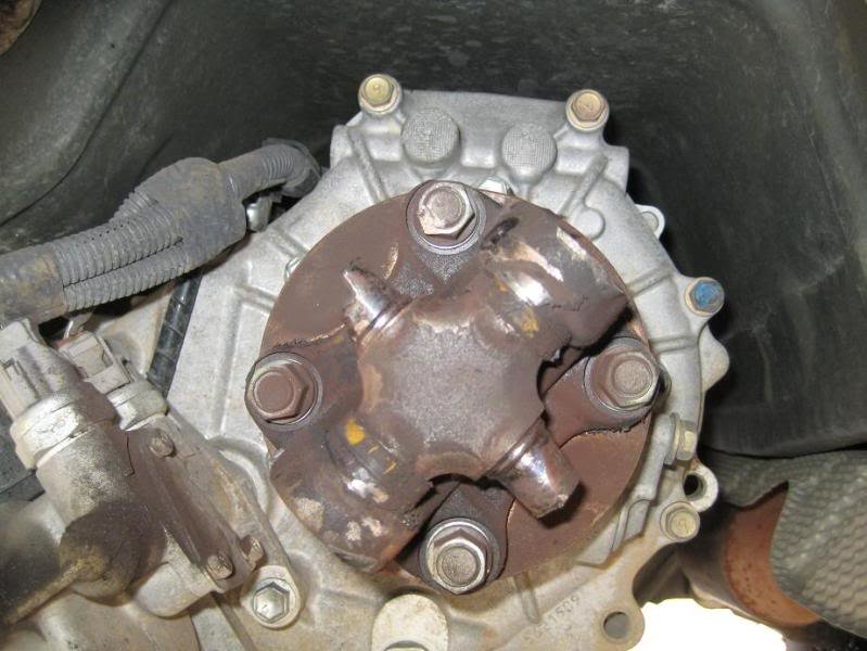

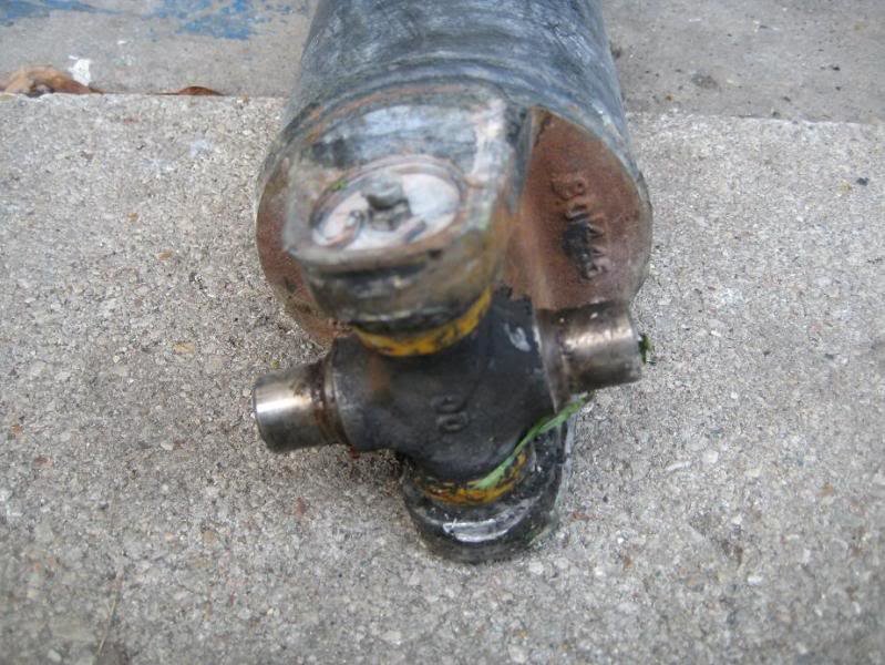

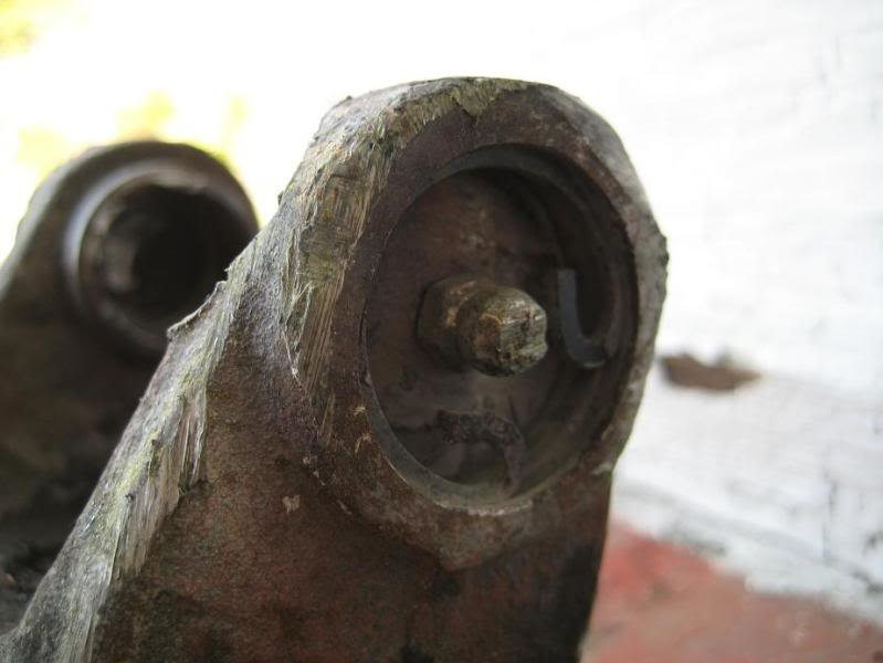

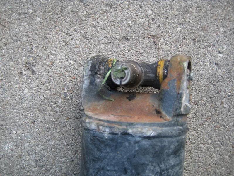

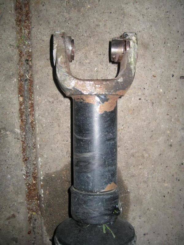

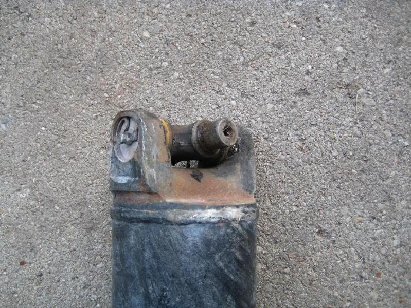

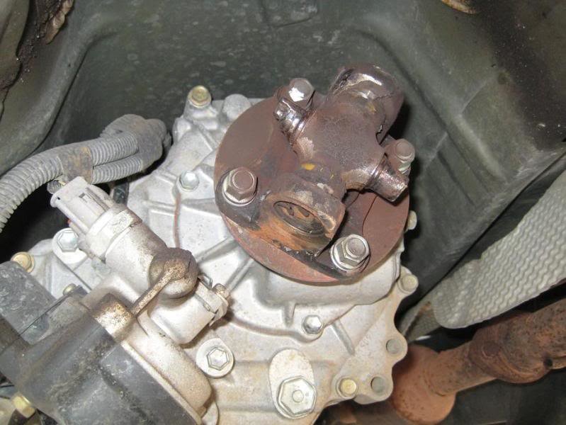

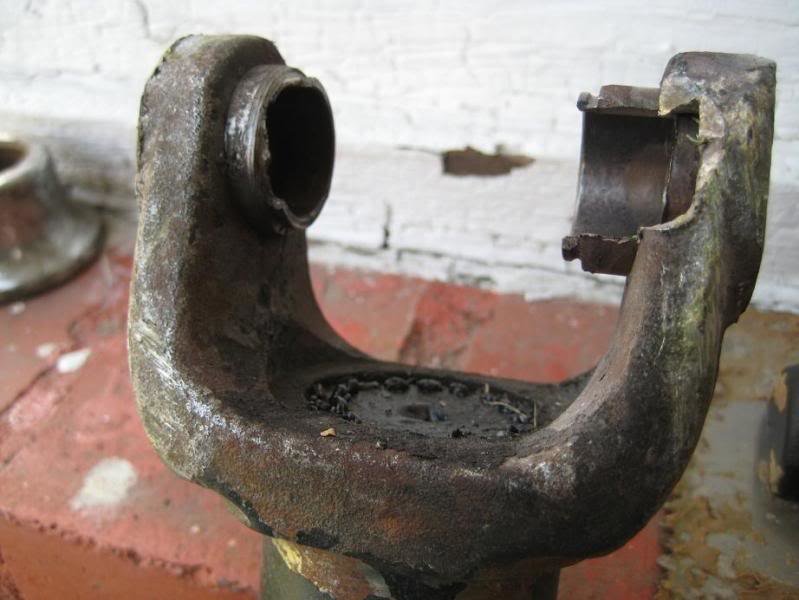

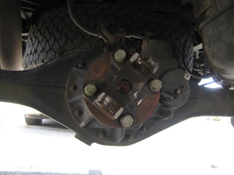

    Title pretty much explain everything...
    Driving home on the highway going about 70mph, truck started vibrating and then shaking and then BOOM! Once i heard the boom i looked at my rear-view mirror and saw the driveshaft blowing off of the truck and flying off to the side of the highway. I immediately pulled over and parked the truck, after doing so I called for the truck to be towed. Now i am home and honestly don't know what to think, the driveshaft has been on for about 2 years now with no problem until today. How bad does it look do you think? easy fix? I'm so lucky that the driveshaft didn't fly off and hit someone's car to cause a major accident.
    Anyways here are some pics...

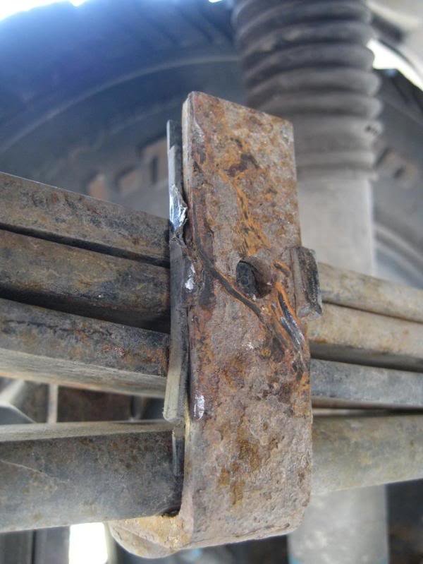

    might have to get this replaced too, i guess when the driveshaft broke off it hit this before flying off...

    the last picture that piece doesnt need replacing but your driveshafts and u joint do need replacing

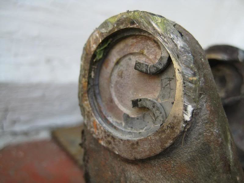

    Looks like the u-joints have been bad for a while. It's evident by the amount of ground metal that's accumulated on the TC

    parts look pretty rusted...and i noticed by your sig that you like to drive in water...do you grease regularly and check torque?

    yeah i also noticed there was no grease in any of the pictures actually

    +1 on the no grease diagnosis. Everything looks REALLY dry to me.

    Agree w/ previous posts. All u-joints look dry (no grease)...and it looks like there was a lot of heat build up. Probably would have been fine if grease properly maintained in the joints.

    drove through that creek once awhile back, had it re-greased a year ago.. but im guessing you guys are right. I honestly wasn't thinking about that just too pissed to think right now. Thanks all.

    oh yeah glad your ok and nobody is hurt. but i think the causes of it breaking is lack of grease

    It ain't the shaft that went batshit on you bro', its the lube-lacking U joints at the root of your issue, you can easily see that your drive line hasn't been maintained as well as it should've been
    Guys ya gotta make the time & lube, lube , lube anything with a grease zirk, & try to be religious about it, make it a regular routine...
