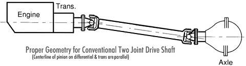

    This is some information I received from Tom Woods about their Drive Shafts.
    Hope it helps solve some driveline vibration issues.
    Please keep the following in mind:
    Vibration problems with the Toyota Tacoma are common even on unmodified vehicles and especially so on those with a lift kit. I wish I had a “one size fits all” solution. The truth of the matter is; we have had mixed results with any version we would send out. Should you purchase one of our drive shaft and it does not meet your expectations, you may return within 30 days for a full, product purchase, refund.

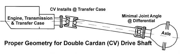

    With that said. We have two options available. A conventional, 2 joint drive shaft or a double cardan (CV) drive shaft. As a general consensus, the conventional two joint seems to work well in most vehicles having up to 3" of lift. In vehicles with greater lifts, the double cardan seems to work best.
    With a conventional two joint drive shaft you need to keep the output of the transfer case & the pinion parallel within 1 degree.
    To use a CV drive shaft, you will want to pitch the differential so that the pinion points directly at the output of the transfer case (maintaining 3 degrees, or less, a joint angle at the differential end).
