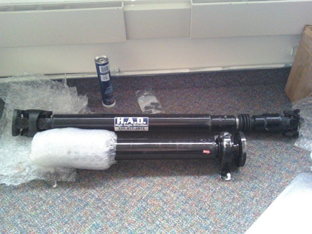

    ^ This. When I upgraded I went with a High Angle Driveline 2-piece setup with double cardigan joint and superduty carrier bearing.
    The only downside is that the new carrier bearing mounting holes won't match the stock one so a new mount needs to be fabricated. I knew that going in so it was no surprise.
    Crappy cell pic:
    My truck's going in for another round of fabrication in a week and half. I'll know in about a month how it works and if there are any vibrations.

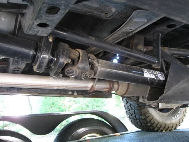

    224
    mjp2
    What was the outcome of this set up? Did you get it installed? Did it remove your vibrations? Could you give an analysis on going this route and would you recommend this drive line?
    Thanks!
  19. Oct 5, 2009 at 10:44 AM
    #19
    mjp2
    mjp2 Living vicariously through myself Moderator
    Feb 16, 2007
    #924
    22,016
    Milton Juevo Portimous II
    NJ
    Current: '21 Bronco Badlands. Previous: '06 TRD Access Cab, v6, 6-speed
    Came out awesome. You'll need to cut/grind off the stock carrier bearing mount and have a new one fabricated and welded in place, but that's the only modification needed. I moved mine lower so the driveshaft clears my driveshaft skidplate with the long-travel rear suspension fully drooped.
    The setup works great and I have no driveline vibrations. I still have the gear noise from the rear axle but that's something I'll live with until I swap out to a wide Ford 9".
    If you can afford it, I highly recommend taking this route.
