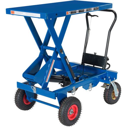

    So it's for a telescope structure that's expected to weigh about 150lbs. So I don't need it to be very heavy duty: I'd rather have a lighter duty gate that will weigh less (so I don't have a 300lb extra tail weight), but I can't seem to find any on the market. Does anyone know of any?

    Why not just leave the telescope in the bed? I mean as far as on site as opposed to at home.

    For getting 150 lbs in the bed a lift gate seems way overkill. Could it be disassembled? Put on wheels and ramped up?

    I have a canopy :) and too much vibration. So that'll introduce a different set of complications! :oops:
    Not a bad idea, if I can find a larger one. The footprint will be about 3' x 3'.
    This is for the disassembled form. I believe it's hard to get the heaviest component below 150lbs. And yes, you're right, it's overkill.
    The problem is getting a 3' x 3' box that weighs 150lbs for someone with a smaller (5'8") build can be challenging, unless the ramps are really long; by really long, I mean something like 16ft long. So I'm starting to wonder if I had a pair of electric winches mounted in my truck that could share some of the weight off of me, perhaps that might work. I could slowly control the winches to feed out while I guide the box down shorter (~10ft) ramps. Of course, pulling it up should be more straightforward. Have to make sure the system is failsafe so it doesn't come crashing down on me and RIP, but that shouldn't be hard if I drive the winch bolts into the truck bed.

    They make truck bed cranes for cheap, kind of similar to a wheelchair hoist. If you can fab up a platform with lifting hooks, you'd be in business.

    Is your structure on wheels or casters? If so, I vote for atv or motorcycle ramps and a block and tackle anchored to the bed up front. How often and on what kind of terrain are you loading and unloading?
