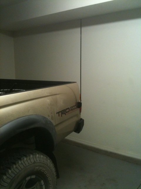

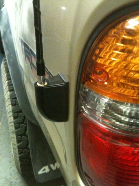

    Working on mounting the antenna. Can't put it where I originally wanted to. Here's about as good as it gets unless I want to put it smack dab in the middle of the TRD sticker:
    The cable was actually pretty easy to run. Just need to zip tie it in place.
    Yay or nay on the antenna mount location?

    Personally, I'd have to say nay on that particular location. Tuck it up behind the back glass and the bed. That far in the back and you're likely to catch something and of course there's the drilling into the bed thing... Just my $.02

    This is where things get confusing. From what I've read, for xmitting, mounted behind the cab is a bad place. Too close to parallel surfaces and the SWR goes to shit. I've read the best is on top of the roof and the second best is the rear driver side stake hole. Why, oh why, does Toyota not believe in stake holes. Would've made this all very easy.

    Yeah, I used to wonder the same thing, then I got my camper so my bedrails became unusable. I do know that the parallel surfaces might interfere with SWR but if you are just using the CB for trail rides where the communication is very close by, you might be alright. I am by no means an expert with CB's just giving personal experiences.
    I used to have my CB antenna mounted on the back of my camper in the same location you are thinking about putting yours and it got caught by more than a few trees while out wheeling and I actually broke 2 before I figured I best relocate mine.
    As another option you could go up to the front bumper and mount it like BoxRocket and many others have done.

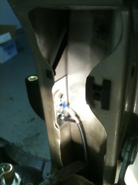

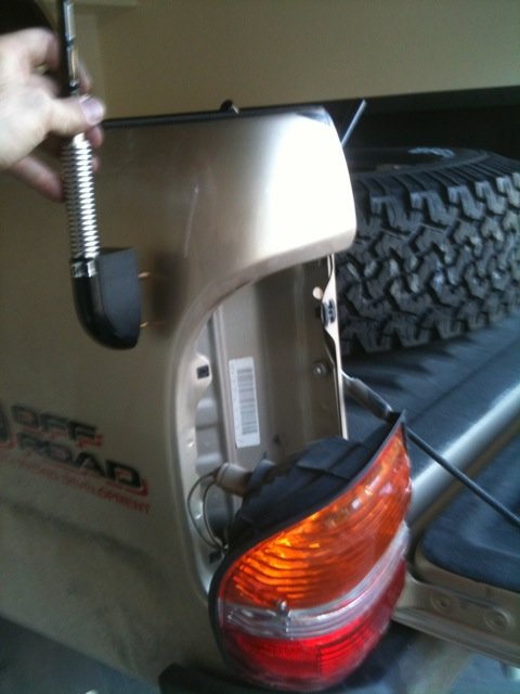

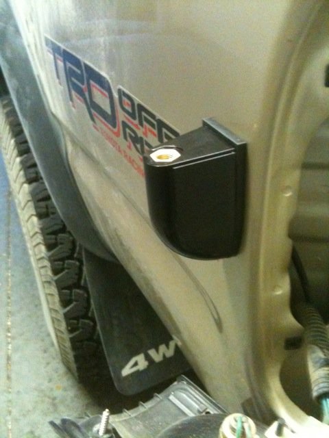

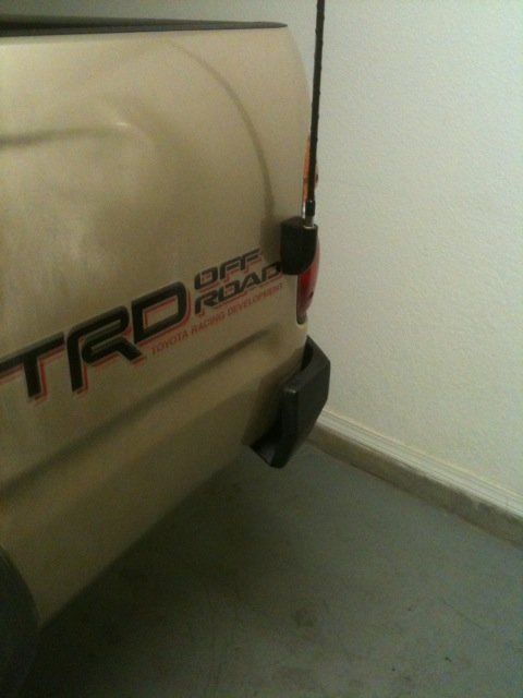

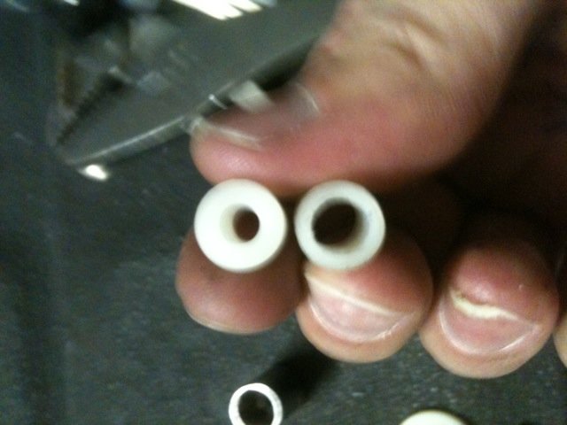

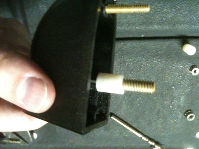

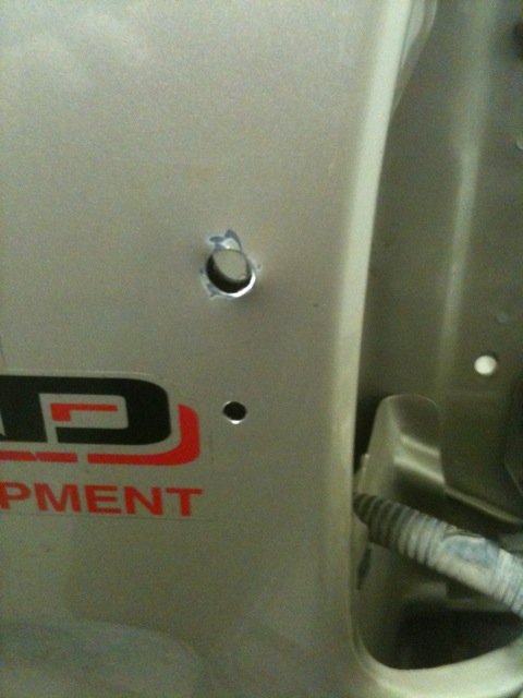

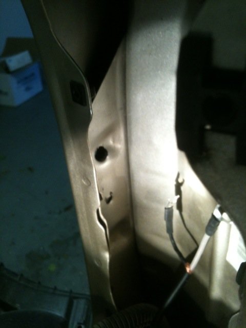

    Fixed! Did it with a $0.26 part.
    So here are the holes I drilled. You can see there is a ~3/8" gap between the outer and inner skin.
    Here's the inside of the taillight pocket
    So I got some nylon spacers to go over the signal bolt, snug it with the holes drilled and bridge the gap. The one on the left is stock, the one on the right shows how much I drilled it out to fit:
    Here it is mounted on the signal bolt of the antenna bracket:
    Mounted up with the rubber gasket installed. I found out this is more for mechanical isolation than electrical.
    Here's the inside all bolted up:
    And here it is with the antenna threaded in:
    Feels a lot more solid. I give the antenna a good twang and only get a tiny bit of wiggle in the bracket. The rubber gasket soaks it up easy.
    Glad I got this sorted out. Happy with the result and $0.26 is a lot less then a body shop would've charged for filling the holes.
