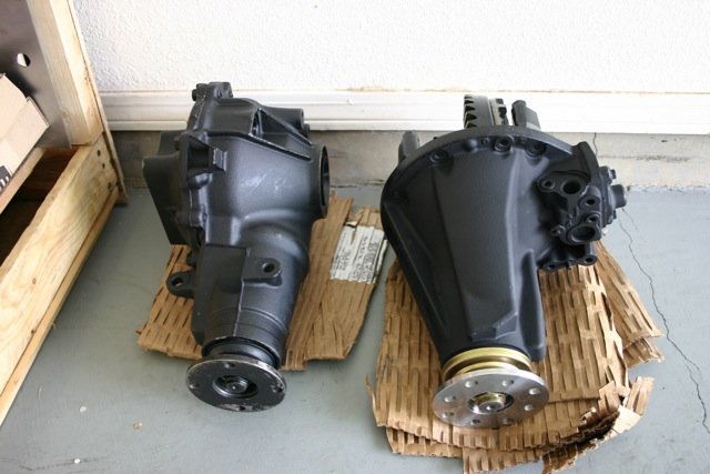

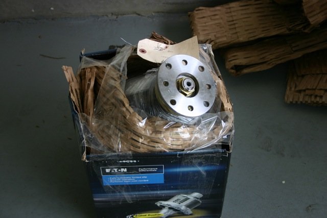

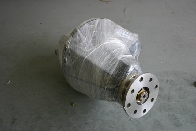

    10:51am - Delivered

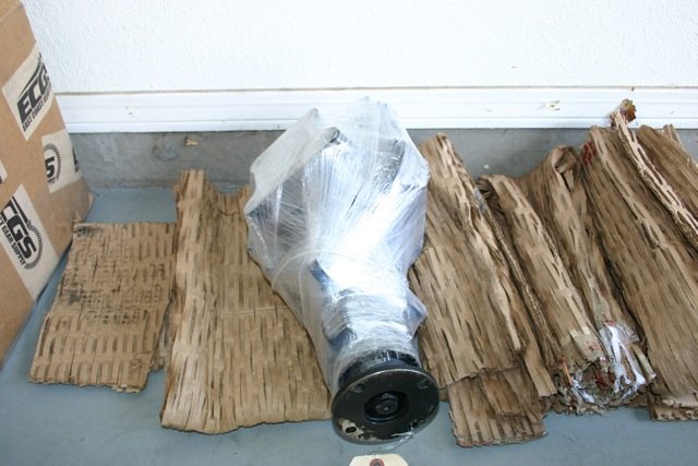

    Peekaboo!
    And a beautiful butterfly shall burst forth from the cocoon.

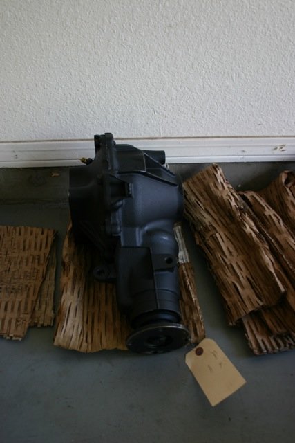

    Flutterby!

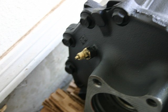

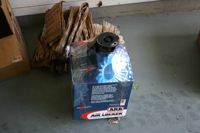

    Locker nipple!
    Same for the rear.
    Now I got to get them installed.

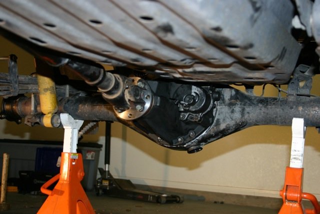

    Thanks to Slodgetto, SGT Taco and White Toy Taco, got the new rear 3rd installed:
    Had some hiccups but all worth it when we got it buttoned up and took it for a test drive. Locker works fine and 1st gear is fun again. Now have to plan for the front diff install.
