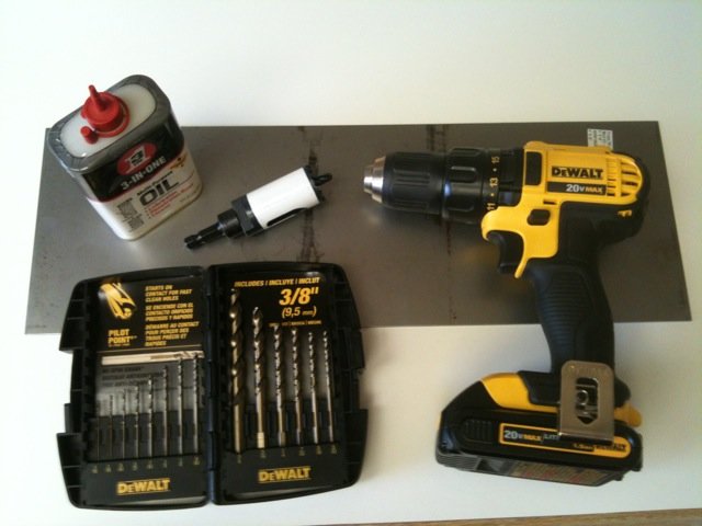

    Sold off my old KM2s. Took the money, went a little wild and bought some tools to install the spare tire holder:
    Bought some sheet metal to practice on, make sure I get the holes started right.

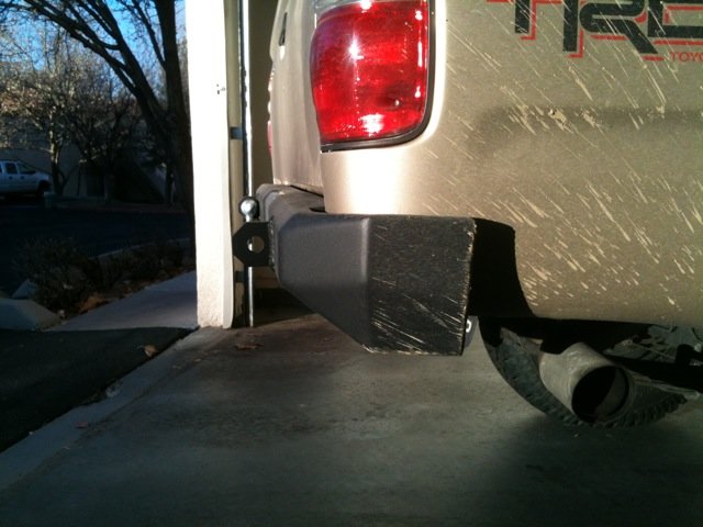

    Nice build. Do you have any side shots of your Elite rear bumper?

    Here you go:
    Not a direct profile shot. Angled it a bit so you could see the lip at the tailgate.

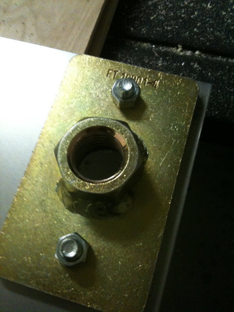

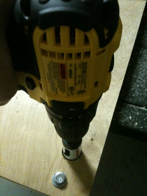

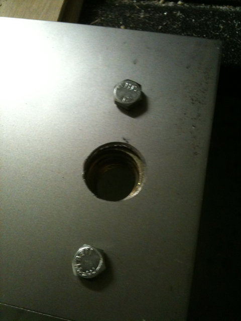

    Worked on the spare tire mount today. I've never worked with metal much before so I picked up some sheet metal to practice on. Ran into problems trying to freehand drill it. Since this will end in drilling a hole in the bed, no use getting a press. Got some advice to sandwich it between plywood:
    Worked pretty well but I think I found some of the problem. The pilot bit on hole saw is not centered right. Not sure what happened to it. Tried reseting the bit but couldn't find the sweet spot. Here's a picture with the mount base bolted to the sheet metal:
    But I need to figure out how to get the holes to line up better:
  17. Feb 10, 2013 at 9:53 AM
    #57

    FWIW... all of the pilot bits on my hole saws are slightly not centered. Never really bothered me though. :notsure: Getting a 1/8" bigger hole saw might work if you aren't able to get this one centered....
    Sorry for the lack of actual help in my advice. :eek: lol
  18. Feb 10, 2013 at 10:11 AM
    #58
    tomtom
    tomtom [OP] Well-Known Member
    Jul 15, 2012
    #82706
    5,371
    The Desert SW
    2012 FJ
    Actually, that helps. If they typically run off center, I can figure out how much to offset the pilot hole. :thumbsup:

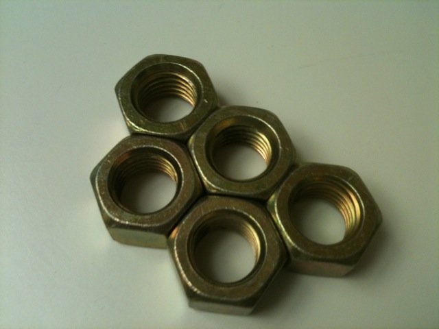

    It has been quiet because I've been waiting for some nutz to arrive:
    So now I need to make the left look more like the right:
    Then I'll finally get around to mounting the spare holder in the bed. In the meantime, I'll probably put up some pictures of the interior. Not much done except the headunit. What a headunit it is.
