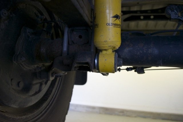

    Added a washer to the passenger side lower shock mount in an attempt to keep the leaf pack from rubbing the shock body. We'll see how it goes.

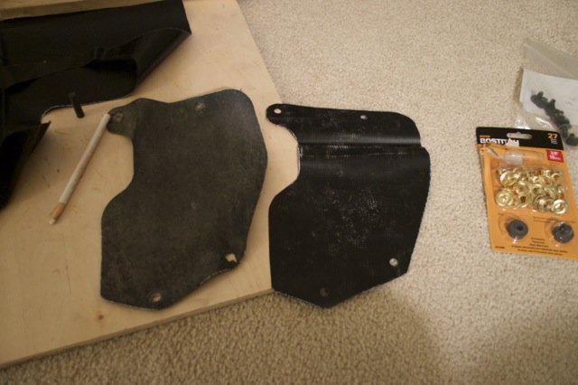

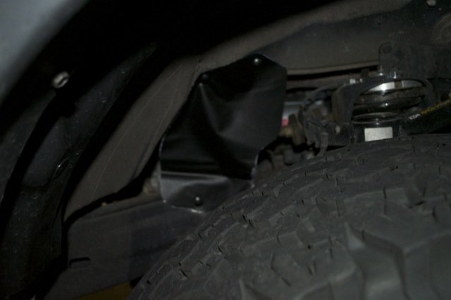

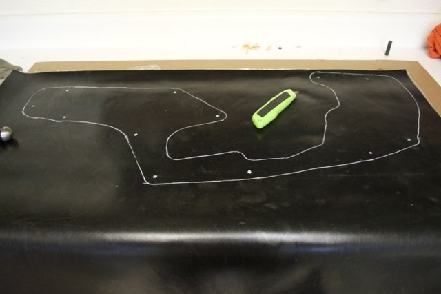

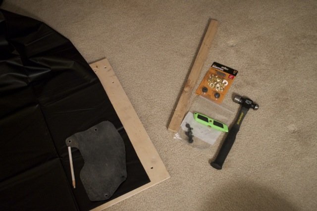

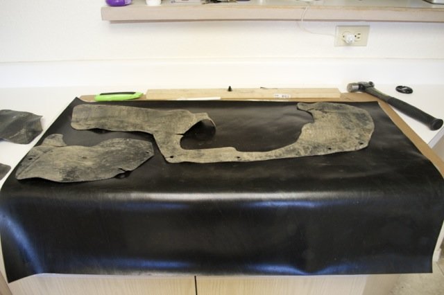

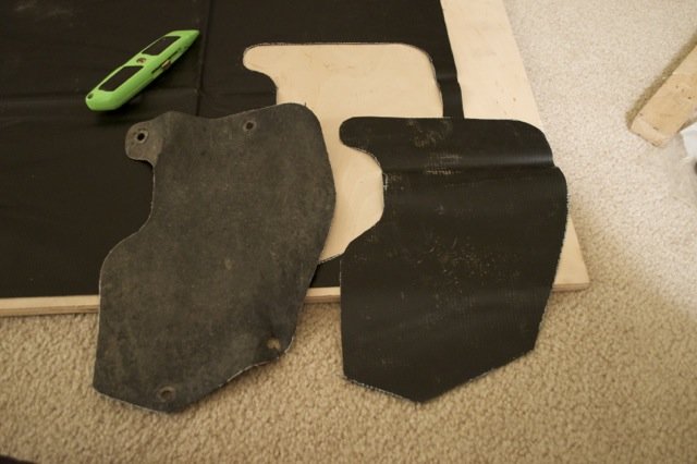

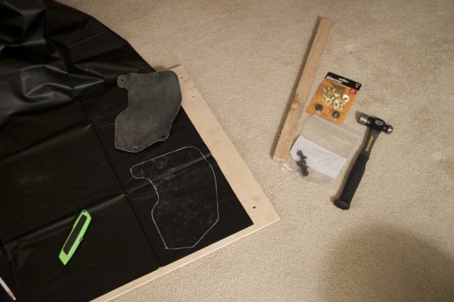

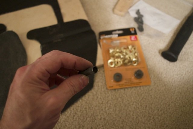

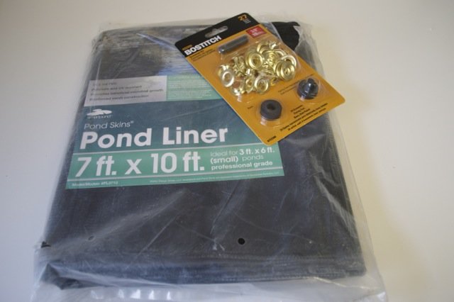

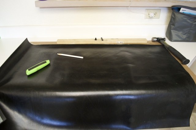

    Started making new engine aprons since the old ones were falling off.
    First, the raw materials:
    Getting started:
    Yay, mad tracing skills learned in kindergarten are finally paying off:
    Cut. It. Out. (that'd be a "Full House" reference)
    Now we get to the reason for the grommet kit:
    Bam! Holes punched.
    And mounted:
    Now I need to find more fasteners so I can finish the rest.
    (Disclaimer: no grommets were hammered in the making of this mod)

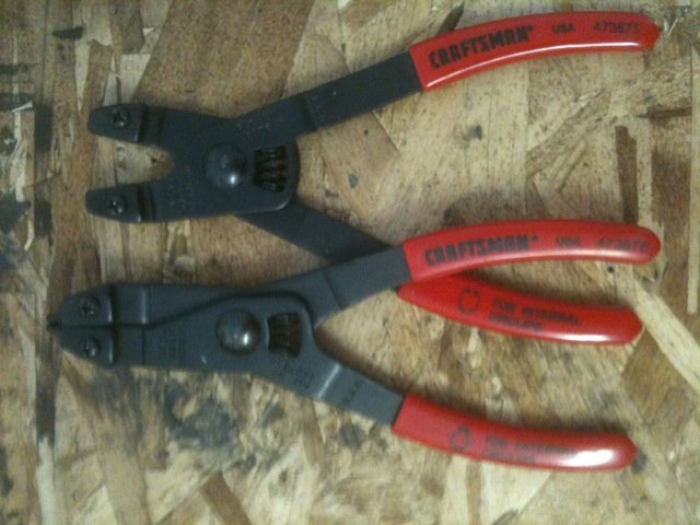

    The c clip in the second picture needs to be moved down to the non-splined portion of the shaft first. Then pound the tripod down until you see the hidden c clip. I used a ball peen hammer and an appropriate sized thin-walled socket (don't remember the exact size). The socket should be large enough to go around the shaft but small enough to fit between the bearing assemblies. It can be done with a punch but need to take more care in striking and placement. Mine were easy once I figured it out. The tripods moved without having to put the shafts in a vice to hold the assembly.
    After you beat the tripod down far enough, the hidden c-clip will appear. That one is fairly simple to remove, a small flat blade screwdriver can pop it out of the groove then you can slide it off by hand. From there, you need to pound the tripod off using a punch and hammer. The FSM states to use a brass punch. I used a regular Stanley steel one. It did a little damage to the tripod body but nothing that was detrimental to the function and fit of the tripod.
    The thick c clip (in the second picture) is a bitch. I bought some snap ring pliers from Sears and still had major issues. I need to find a better tool for them but it can be done with regular snap ring pliers.

    You can get a small flathead in there and leverage it onto the splines. It takes a bit of work. Best choice is a pair of snap ring pliers but the trick is finding the right ones. I used some craftsman stamped steel POS ones which took a bit of work as well.

    This is what I used:
    The closed pair. Had to wrap a rag around the handles to keep it from hurting my hand and to get enough squeeze on them.

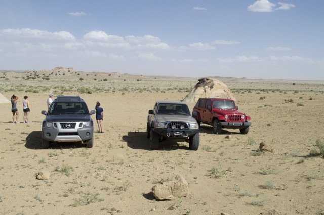

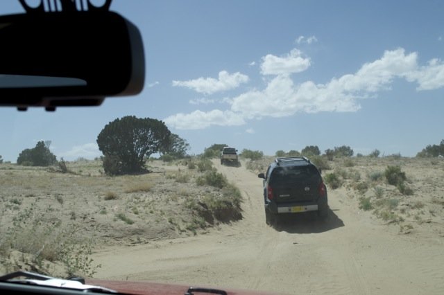

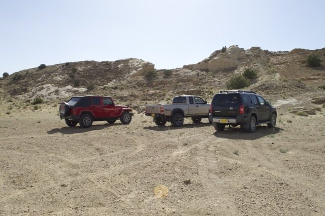

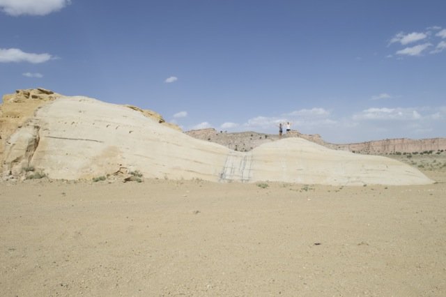

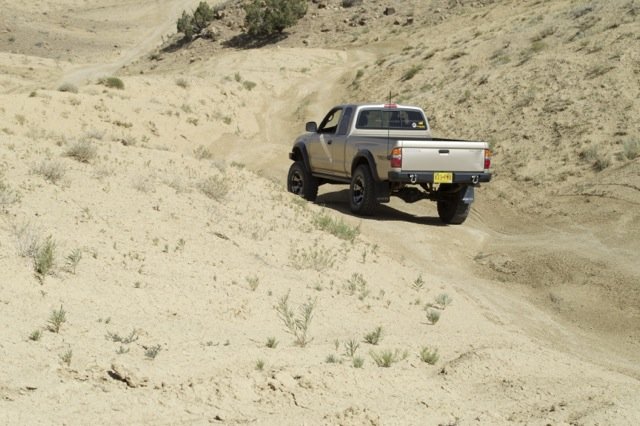

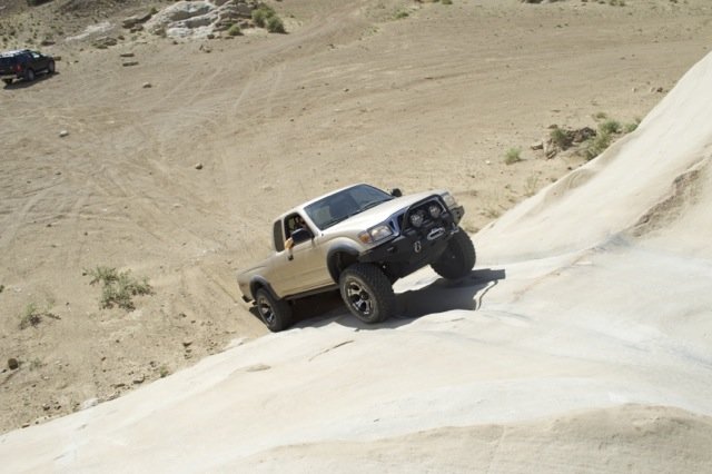

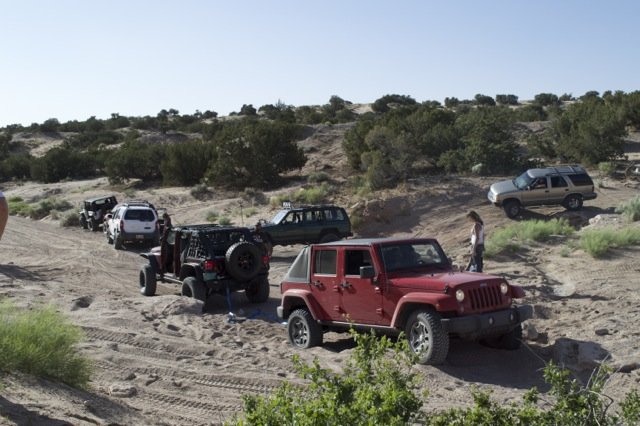

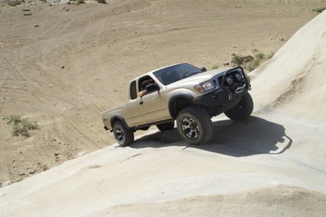

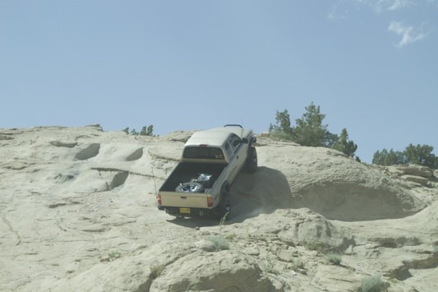

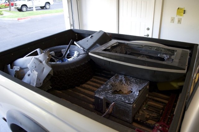

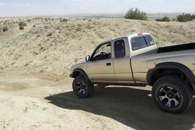

    Went offroading yesterday with some coworkers who had never been.
    Dropping in on titty twister with the emergency brake on. Doh.
    Snoopy!
    Gave everybody a ride up and over so they could see how it felt.
    Heading out.
    The jeep got stuck. Driver was still learning how to operate the lockers.
    Off-roading group happened to come by and tugged her off the ledge.
    She got the lockers engaged and found out how much easier they make things.
    All the shit I picked up while I was out there.

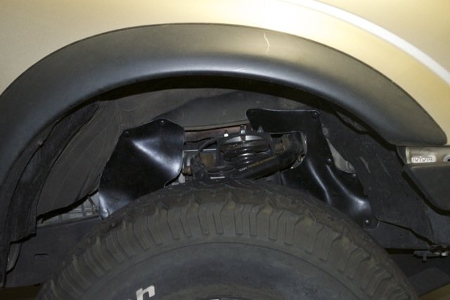

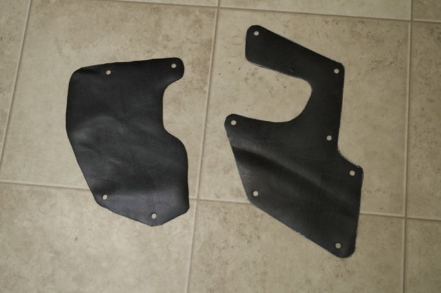

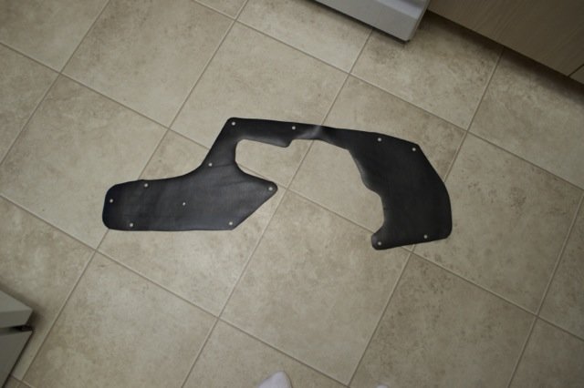

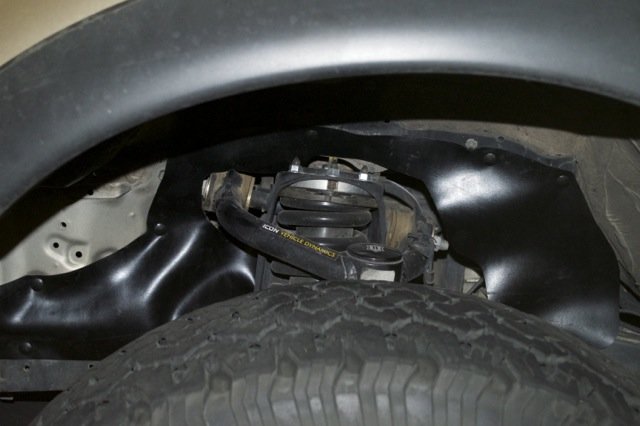

    Made new engine aprons out of nitrile rubber I ordered off of Amazon (1/16")
    Might re-do them and change the pattern to fill in some places but I like how they turned out. Now to see how they hold up to the heat.
