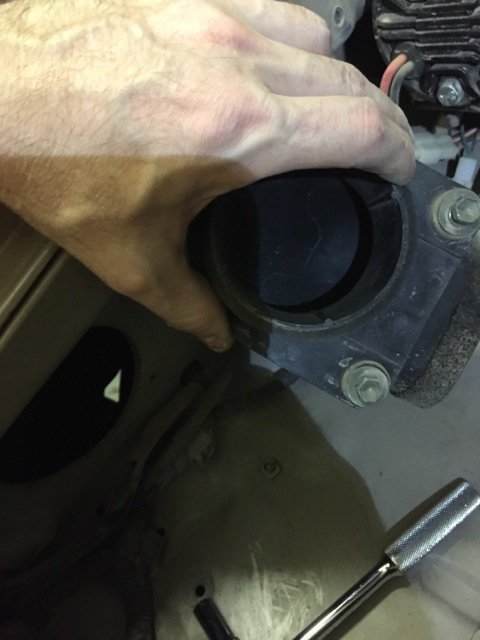

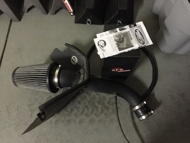

    Pulled the aFe intake:
    Pulled the elbow:
    Installed a stock box + Airaid tube:

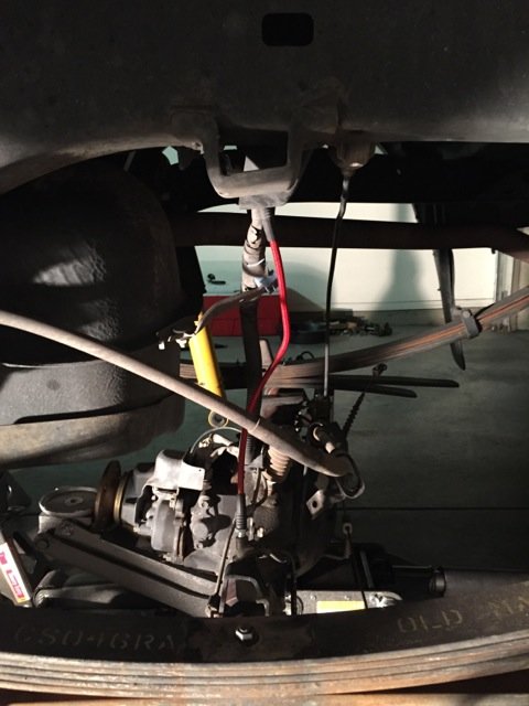

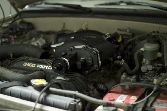

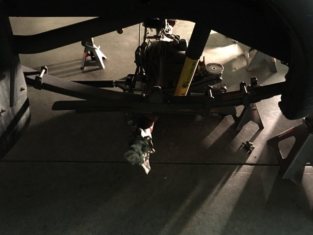

    Was going back through pictures and realized I had snapped some of the supercharger install and the rear axle work.

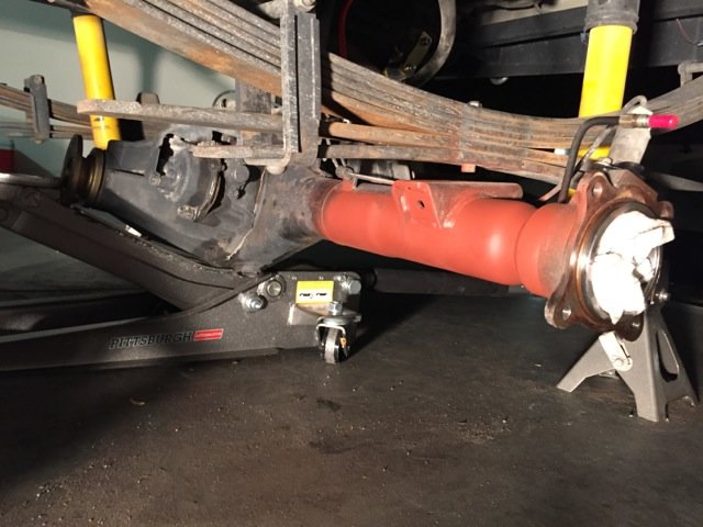

    First, the rear axle work.
    Dropped the rear axle to re-paint the axle and install relocation plates, extended brake lines and OME greasable shackles.
    Sanded and primered:
    Wheeler's extended brake line:
    Shackles installed:

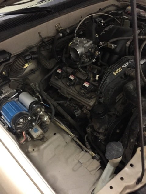

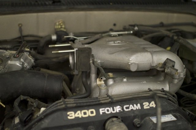

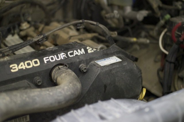

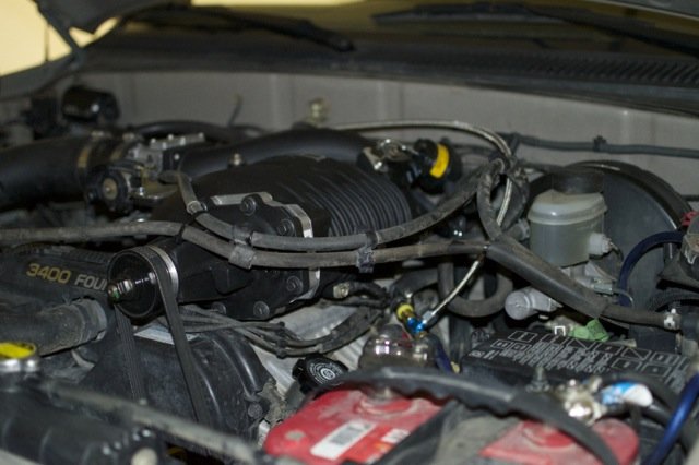

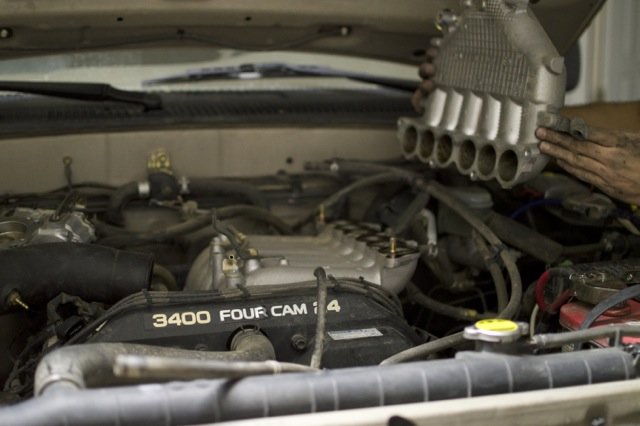

    This was during the S/C install.
    The plenum:
    Top half of plenum removed:
    Cutting the timing belt cover:
    Dry fit of the S/C:
  13. Oct 29, 2014 at 8:53 PM
    #773
    tomtom
    tomtom [OP] Well-Known Member
    Jul 15, 2012
    #82706
    5,371
    The Desert SW
    2012 FJ
    URD 7th Inj installed:

    Not digging this setup at all. Seems to be lacking in the bottom of the RPMs. Going to drive it a little more but strongly considering going back to the aFe and adding a prefilter sock.

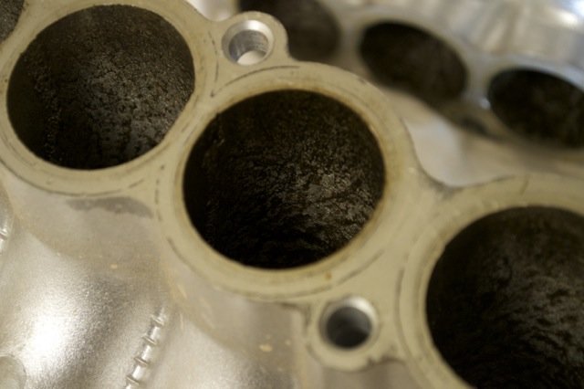

    Thanks! Yeah, it could just be the ECM is seeing different flows and needs to relearn. Going to have a buddy that has driven it before test drive it this weekend to see what he thinks. Might just be my imagination because the beautiful S/C whine isn't as prevalent. The truck still pulls, just seems to lack some oomph coming off of idle.

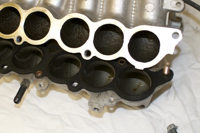

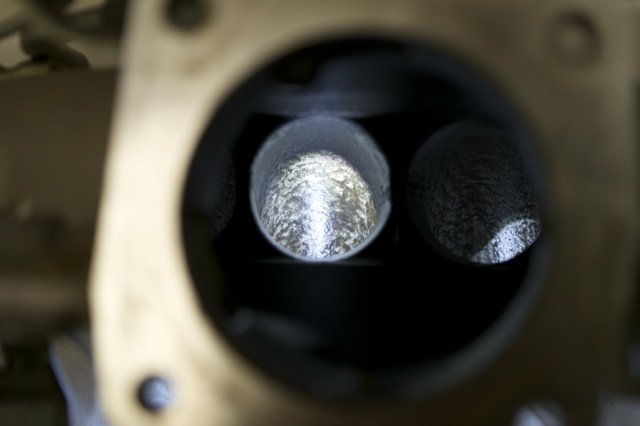

    I pulled the aFe after seeing the inside of the stock plenum but it could just be oil buildup from the PCV. My MAF has been clean so maybe I'm over-reacting. I'll get some pictures done up here in a couple.
  17. Oct 30, 2014 at 8:17 PM
    #777
    tomtom
    Jul 15, 2012
    #82706
    5,371
    The Desert SW
    2012 FJ

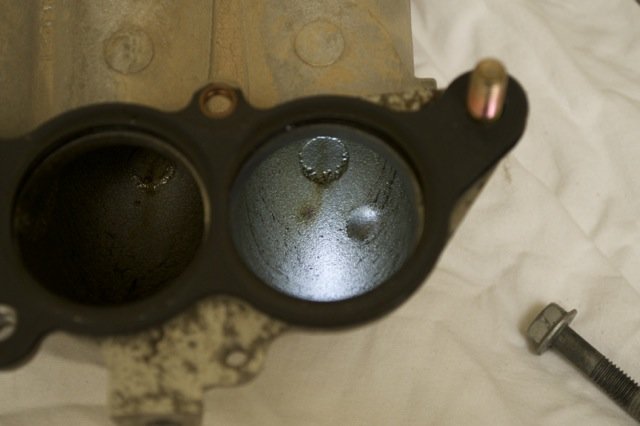

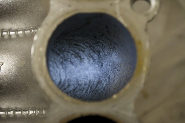

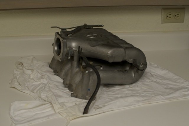

    Got the plenum setup on the kitchen counter to photograph.
    A decent shot to see the oil buildup from the PCV:
    Played with the lighting to get some shots inside:
    Definitely a bunch of oil. Don't know how much dust and dirt is in there but the oil has a gritty feel. Considering sending off a sample to get it analyzed next time I change the oil
