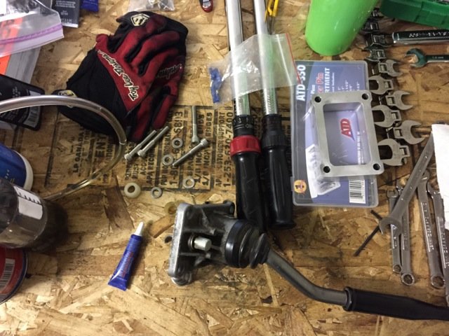

    Got the URD short throw shifter installed:
    Still have to get used to the feel but nice having the shorter shifts.

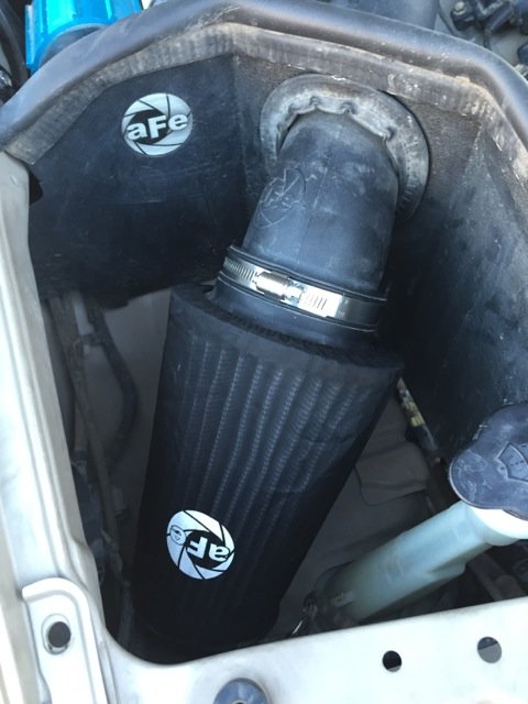

    Put the aFe back in and added a prefilter.

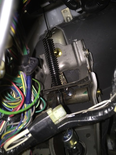

    Replaced the torsional clutch spring with a linear one. Found out I got the wrong linear spring. Have an order in to Camelback to try a couple of different ones.

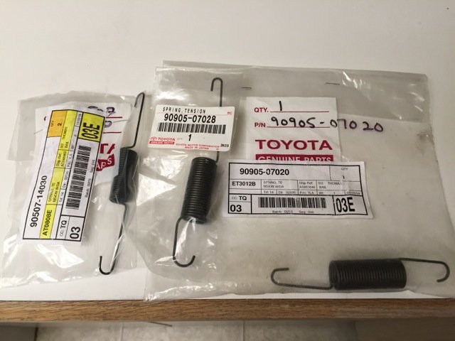

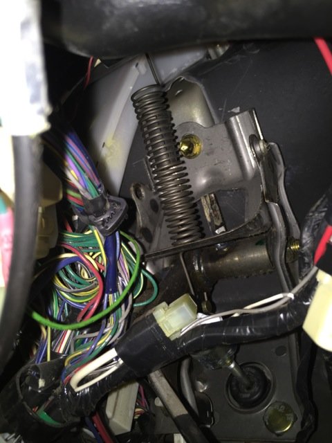

    Pedal springs are in.
    From left to right:
    1. 4Cyl Clutch Pedal Return Spring, Part # 90507-14030
    2. Brake Pedal Return Spring, Part # 90905-07028
    3. Brake Pedal Return Spring "W/VSC", Part # 90905-07020
  13. Nov 13, 2014 at 5:46 PM
    #793
    tomtom
    tomtom [OP] Well-Known Member
    Jul 15, 2012
    #82706
    5,371
    The Desert SW
    2012 FJ

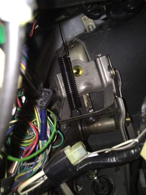

    Went with Spring #1 because of the smaller diameter.
    Not pressed:
    Depressed:
    No contact on the pedal assembly cross brace (as expected). Minor contact on the torsional spring tab. If I can't live with it, I'll grind down the corner a bit but it isn't noticeable unless I expect it.
    The pedal requires about the same force as the torsional spring except there isn't that weird wind-up "hump" and loosening. Way quieter too.

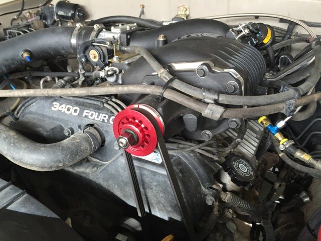

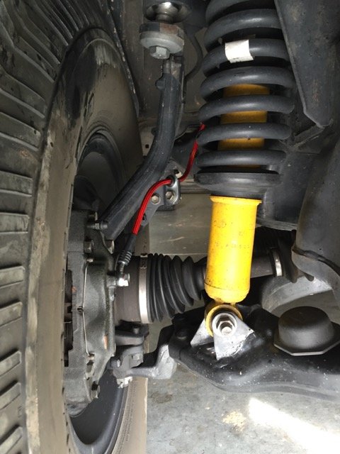

    Added some red highlights:

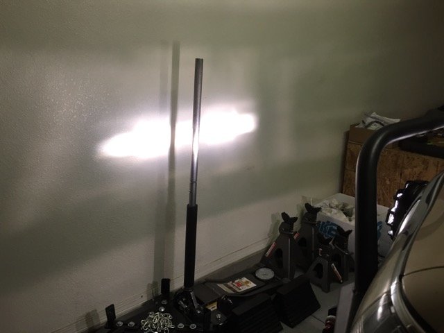

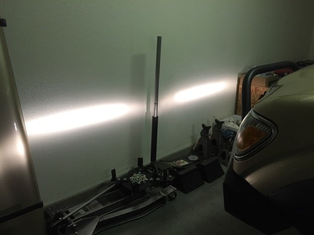

    With the excellent help of SGT Taco, finally got my off-road and fog lights aimed.
    Driving lights:
    Fog lights:
    Set them up per PIAA's instructions at 25 feet. Very good symmetry when 5 feet from the wall which says we did a good job.
    Took the rock guards off the fog lights and made a huge difference in brightness and sharpness.

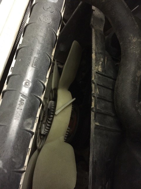

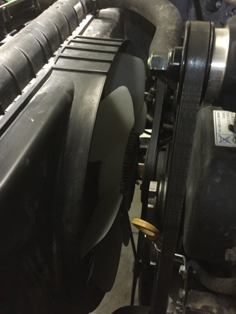

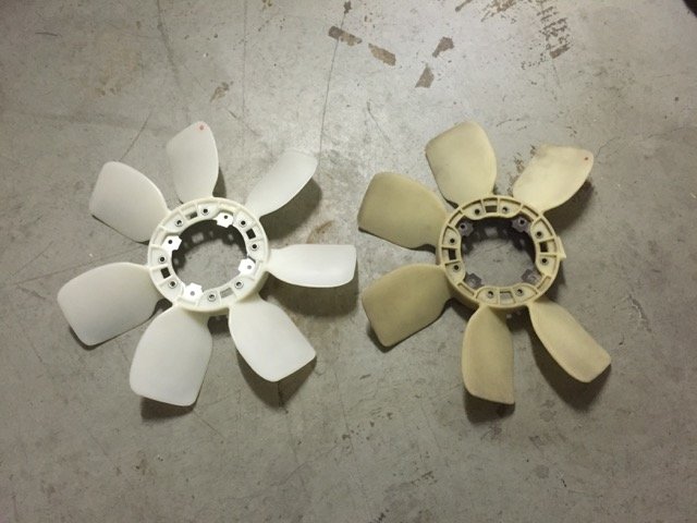

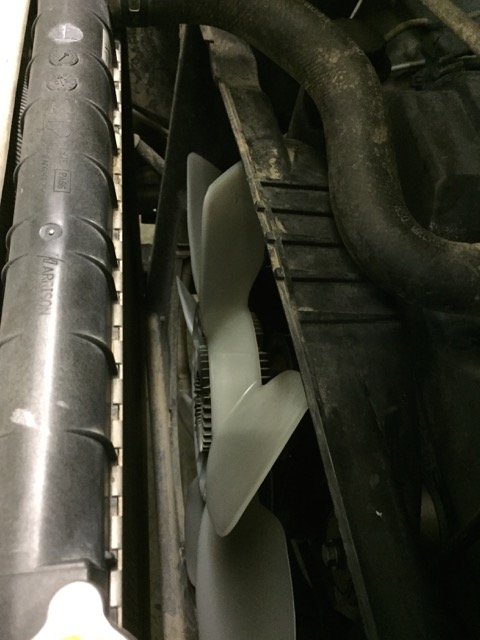

    Replaced the engine fan today because it threw a blade.
    Didn't have to drain any coolant or take off the top radiator hose, just unbolted the shroud and pushed it back:
    New vs. Old. Was happy the dealership had one in stock (toyota part no. 1636162010)
    Got to use my snazzy little torque wrench for in-lbf:
    New one in and torqued:
    Shroud back on and runs fine.
