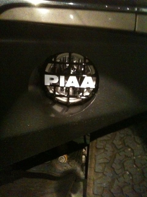

    Still have to wire them up but got the foglights mounted tonight:
    I'll get some better pictures this weekend.

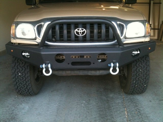

    Slightly better picture:

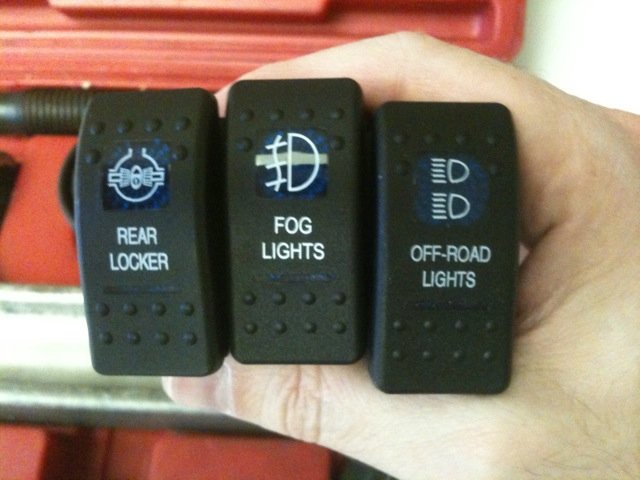

    Some switches came in:
    Have to figure out the dashboard layout.

    So jealous of your bumper! Hopefully I'' get in on his upcoming group buy...

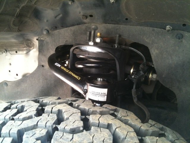

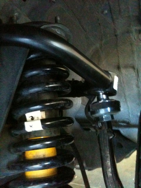

    Thanks to some very helpful and positive thinking NM Taco and 4Runner owners got the Ikon UCAs installed:

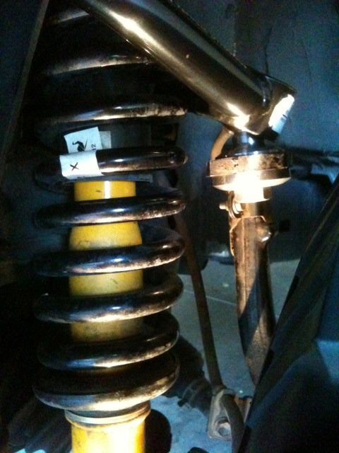

    And it solved my coil contact problem:
    Things weren't looking good but a couple of the guys stepped in, pulled the whole spindles off and pressed the upper ball joints out. After that, went like clockwork. Really amazed to see peeps throw in a helping hand.
  11. Apr 14, 2013 at 6:33 PM
    #171
    tomtom
    tomtom [OP] Well-Known Member
    Jul 15, 2012
    #82706
    5,371
    The Desert SW
    2012 FJ
    full droop:

    Where do you plan on mounting your switches?
  16. Apr 18, 2013 at 5:45 PM
    #176
    tomtom
    Jul 15, 2012
    #82706
    5,371
    The Desert SW
    2012 FJ
    That is a very good question. Currently the plan is:
    1. Move the clutch start cancel button to where the rear locker button is.
    2. Put the 2 light switches where the clutch start cancel button was.
    3. Hang the CB mic where the clock is.
    4. Move the rear locker button to the switch panel underneath the ash tray.
    5. Install the front locker and compressor switches in the same switch panel.
    I have to get into the dashboard with a friend to go over everything and make sure it is do-able.

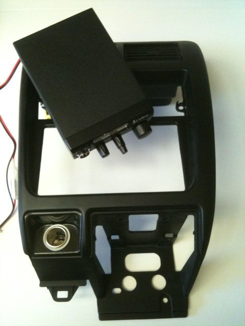

  19. Apr 20, 2013 at 5:32 PM
    #179
    tomtom
    Jul 15, 2012
    #82706
    5,371
    The Desert SW
    2012 FJ
    Hmmm, what could I be up to?
  20. Apr 21, 2013 at 12:58 PM
    #180
    tomtom
    Jul 15, 2012
    #82706
    5,371
    The Desert SW
    2012 FJ
    And mounted:
    It sticks out a little more than I would like but with the HU face tilted out it lines up perfectly so I can still see the display. Used velcro to secure it to the dash facade. I still have to mount the antenna and wire it up.
