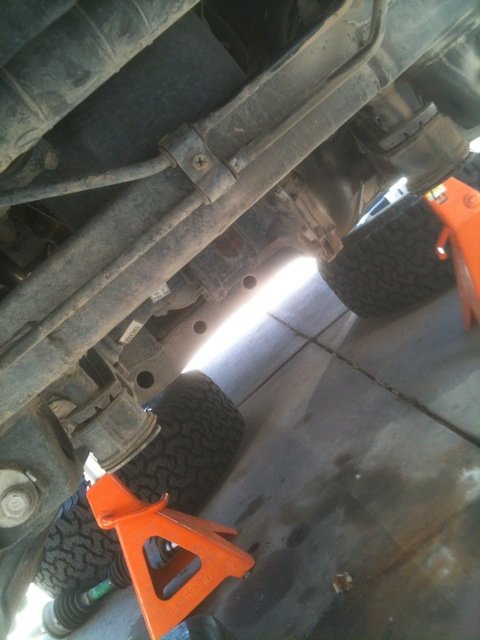

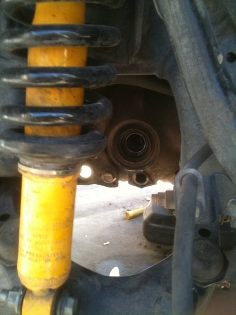

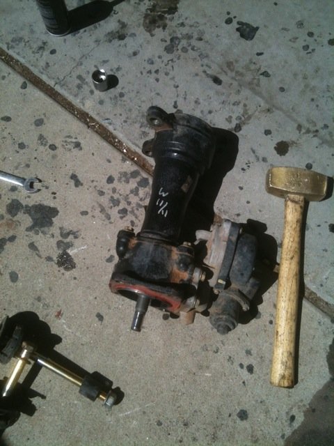

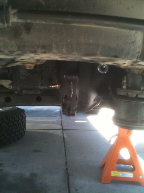

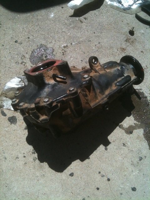

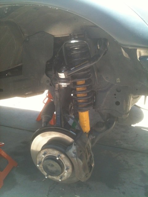

    Snap! Got the front diff replaced.
    Skids off:
    CVs Pulled:
    Old one pulled:
    New one going in:
    The diff tube pulled just fine. Didn't have to disassemble:
    New one in:
    And while I had the chance, full droop:
    Oh, and look what showed up in the mail today:

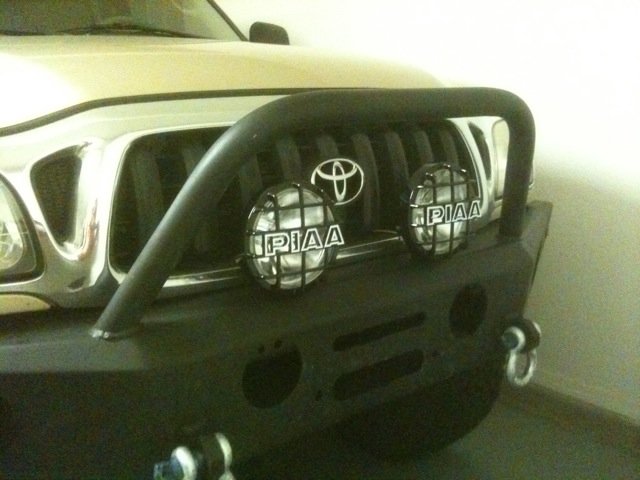

    Bolted on the new lights. Still have to do a bunch of wiring.

    Looks like the front diff is leaking. Gear oil on the garage floor gives it away. I ran my finger along the edges we cracked but all came back dry. I'm hoping maybe the breather tube came off or isn't sealed up right. Gotta get back under the truck tomorrow morning to see if I can find it.
    Good news is the rear is still doing fine. :)

    Ha! Just the drain plug. Tightened it up a tad. Will see about fixing it when I refill the gear oil after the break-in period is done.
