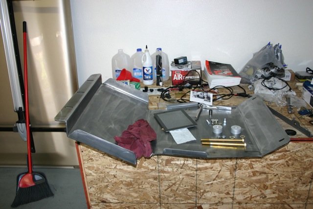

    Unpacked the skidplate. And it immediately became a work surface.

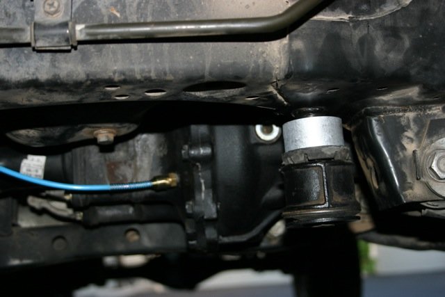

    Ran the plumbing to the front locker and installed a Toytec diff drop kit to replace some other brand that I didn't like.

    Did you have to enlarge the holes on the bumper skidplate tabs to install the budbuilt skid? If so, how did you do it?

    I did have to cut about an inch on the front lip of the bud skid. Look at my build and also search jlee's thread he made.

    Yar, when I was researching BudBuilts I got to know your build pretty well. :) I'm already wrangling up help to get the front lip cut down.
    What about the slots in the bumper mounting tabs that Tim used? The 8mm bolts I have won't fit. I'm looking at drilling/grinding them out and hoping that it is just the powdercoating that is making it too narrow. Was hoping to get 1st hand experience.

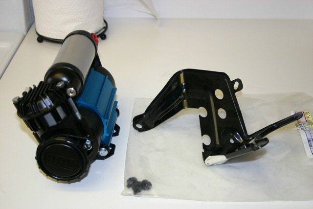

    Cruise control bracket rolled in today. Going to require some cutting and bending but should work out nicely.

    I didn't have any problem fitting them in. I'm sure drilling and grinding will work fine.
