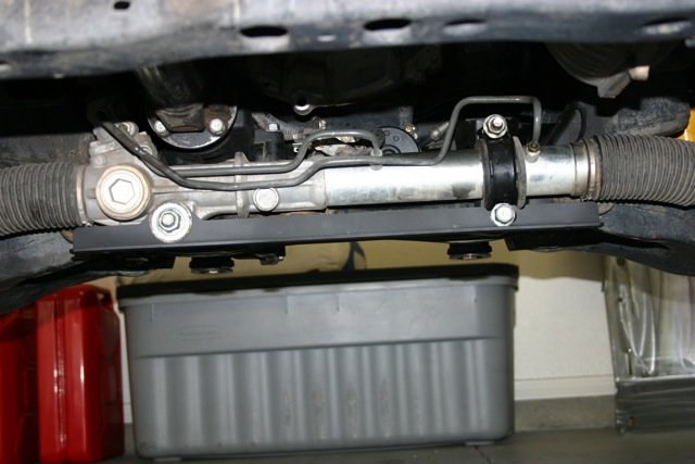

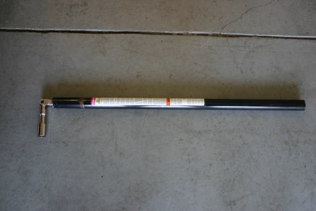

    I freaking hate this one steering rack bolt. Hit it with the PB blaster and attacking it with a 2' breaker bar and no luck. Might have to use the hilift handle to extend the breaker bar.
  15. Jul 22, 2013 at 3:56 PM
    #395
    tomtom
    tomtom [OP] Well-Known Member
    Jul 15, 2012
    #82706
    5,371
    The Desert SW
    2012 FJ
    OK, made a nice extended breaker bar with the hilift handle:
    and managed to mount the steering rack cross member:
    While I was under there, I was going to grind out the eyelets for the front lip mount on the bumper and I found this barely hanging on:
    Looks like I have to pull the bumper and devise a better mounting scheme. Not too happy with Tim's design regarding the skid plate but it is what I'm stuck with. It wouldn't even fit an 8mm bolt which is what the stock skid uses so I really am not sure what Tim was thinking.
