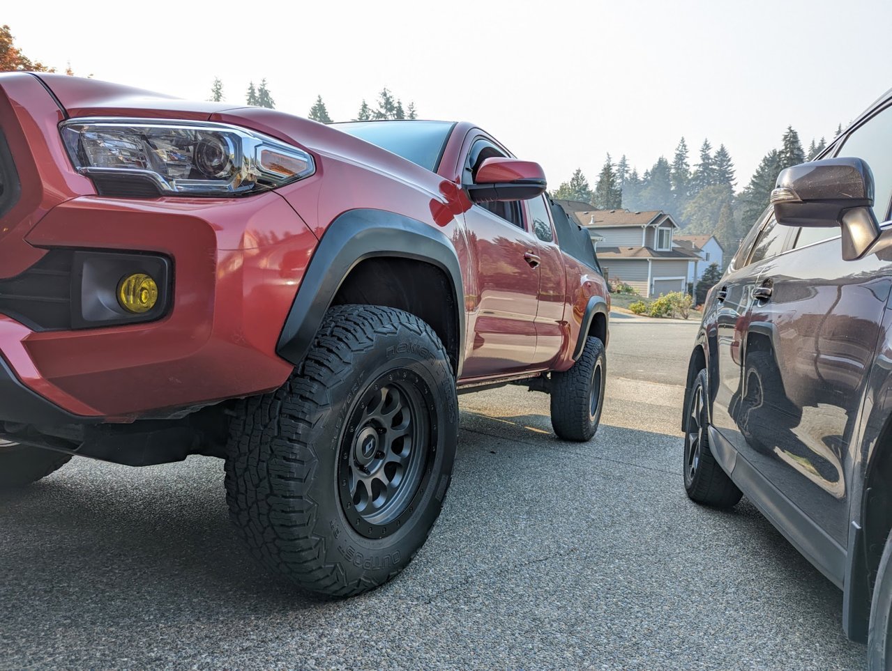

    Finally! B-bye shitty Sport wheels.
    Anybody wanna buy some Sport wheels? :rofl::rofl:
    Massive thanks to @Bertw192 ! :drunk:
    His Taco is looking hawter these days with the new Blaze10s.

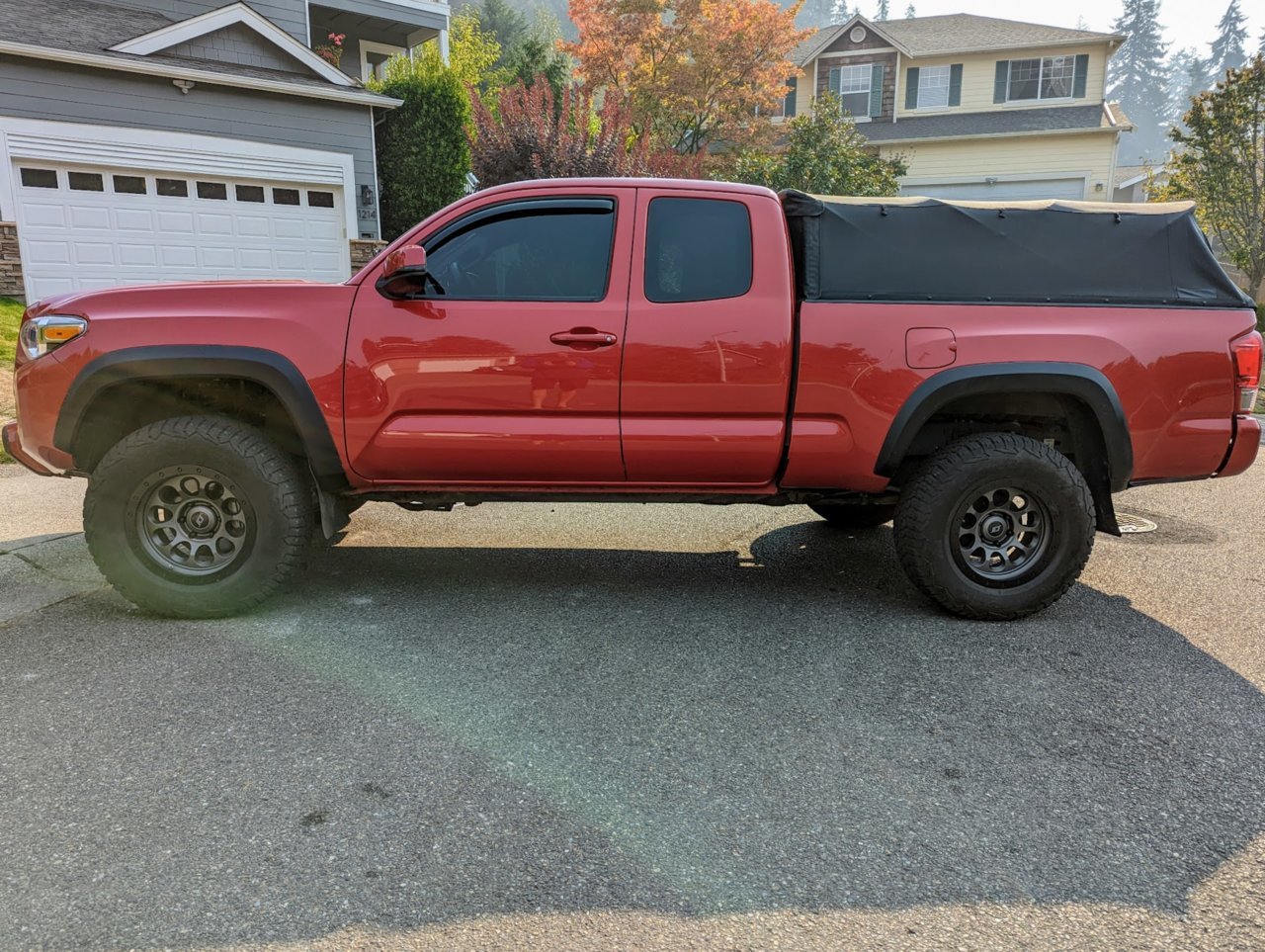

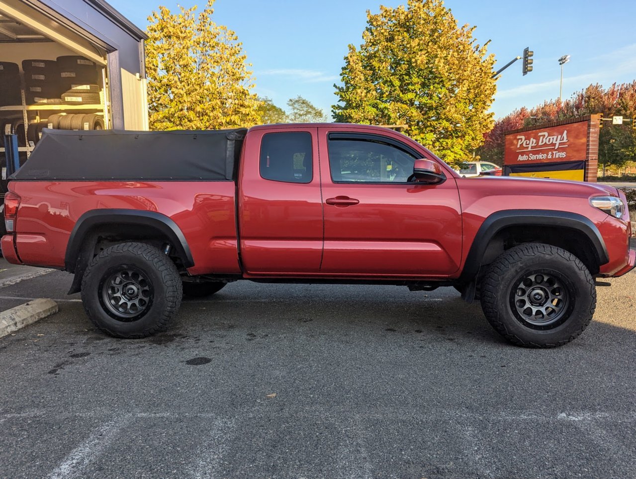

    I'm at a little conundrum. The BAMF Hangers added about 1/2in of lift (2in of measured rake), and after over 30k, the RXT Option 1 packs have not sagged at all.
    My 5100 coilovers are at the 4th Clip on the left and 3rd Clip on the right. So when I'm aboard, there is likely no Taco Lean. Do I go to the 5th (L) / 4th (R)?
    It looks like the new wheels with negative offset add about 1/8in to the measurements.
    Last measurement:
    LF: 22 1/8in RF: 21 7/8in
    LR: 23 5/8in RR: 23 1/4in
    Current with same fuel level with Rogue Offroad body mounts, -10mm wheels, and BAMF Hangers:
    LF: 22 1/2in RF: 22in
    LR: 24 1/8in RR: 23 7/8in
    Maybe I just go to the 4th clip on the right and see? Not worry about the Lean?

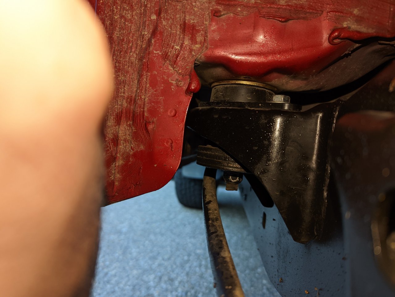

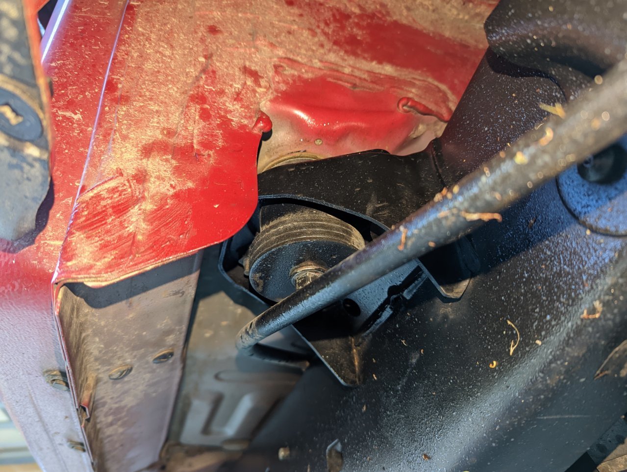

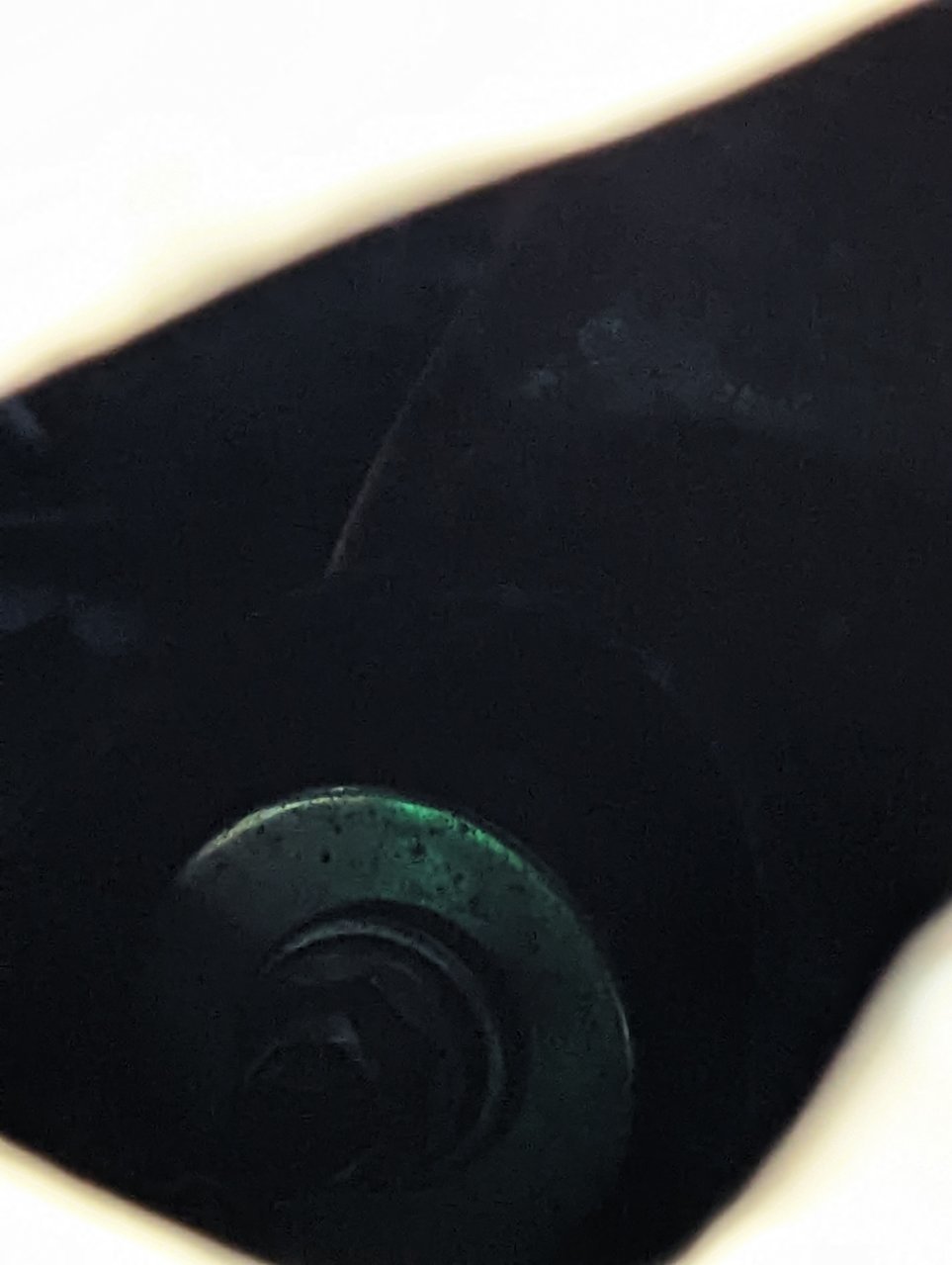

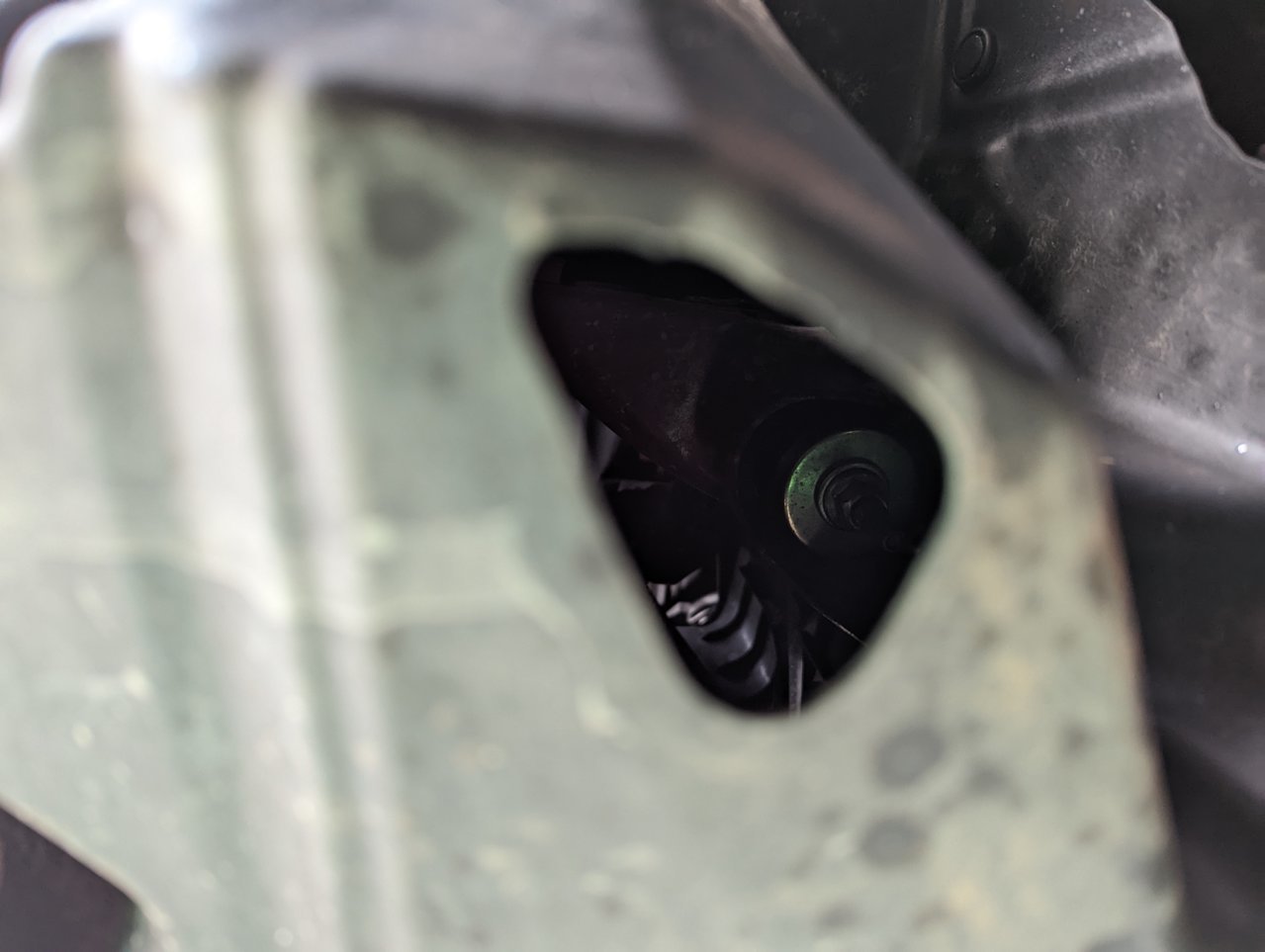

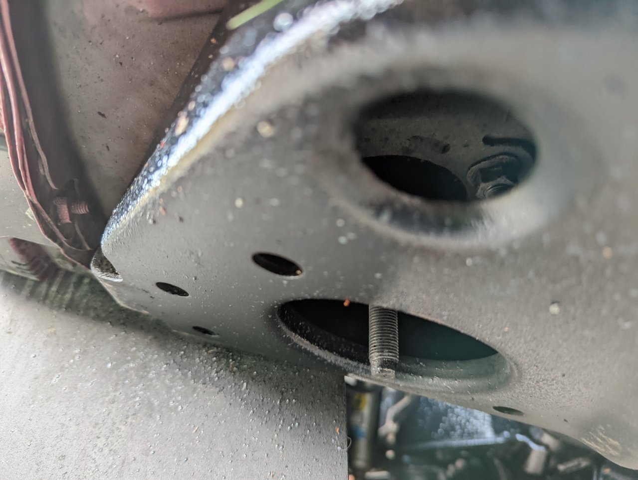

    Mainly putting this here for recall, but if anyone has creaking noises from their stock or aftermarket suspension near the LCAs, this is a relatively inexpensive solution to try.
    @Bertw192 suggested getting full shank bolts for the lower mounts. The washers are not exactly fender / large area washers, just extra thick (6mm) and about the same OD as stock.
    Here are the posts for the bolt sizes:
    Front:
    I think the noise up front was due to that goofy step in the shank of the OE bolts. I had the same noise on both the stock suspension and 5100s.
    Bolts:
    Washers:
    Rear:
    Bolts:
    Washers:
    I did the rears because of pounding in the lower sleeves / bushings for the 5125s that were too wide. The 5125s come with two sets for some reason. A friend machined them down to 32.7mm for me. Worked like a champ.
