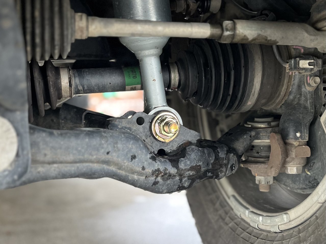

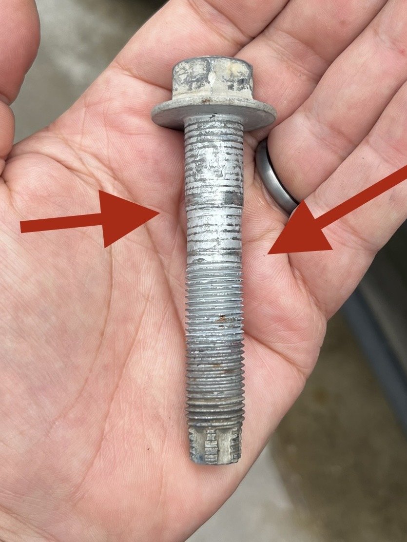

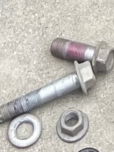

    Using the link, I got the belmetric hardware for the lower strut. Toyota, get rid of this fucking problem!!! The Bilsteins were already wearing and heading for the infamous click over speed bumps.
    The wear wasn’t there when I swapped the coilovers over a week ago(latter photo). But the click was. The click is gone with a new bushing(s) from the coilovers.
    Muchas Gracias hometown!!!!

    You have to go back to the linked thread for the diameters and lengths.
    The click could be the bolts. A squeak or knock could be the body mounts.

    These are the bolts at the bottom of the front coilovers where they connect into Lower Control Arm (LCA). You can see the nut on this bolt if you look at the LCA.
    The bushing in the coilover is likely just fine.

    Stock and Bilstein 5100s, like mine, have a rubber bushing, but it still seems like these proper bolts help.

    You can get bushings, but they are quite a bit more work to swap. Like I said above, your bushing is most likely in great shape. Just that weird shoulder on the bolt is causing the noise.
