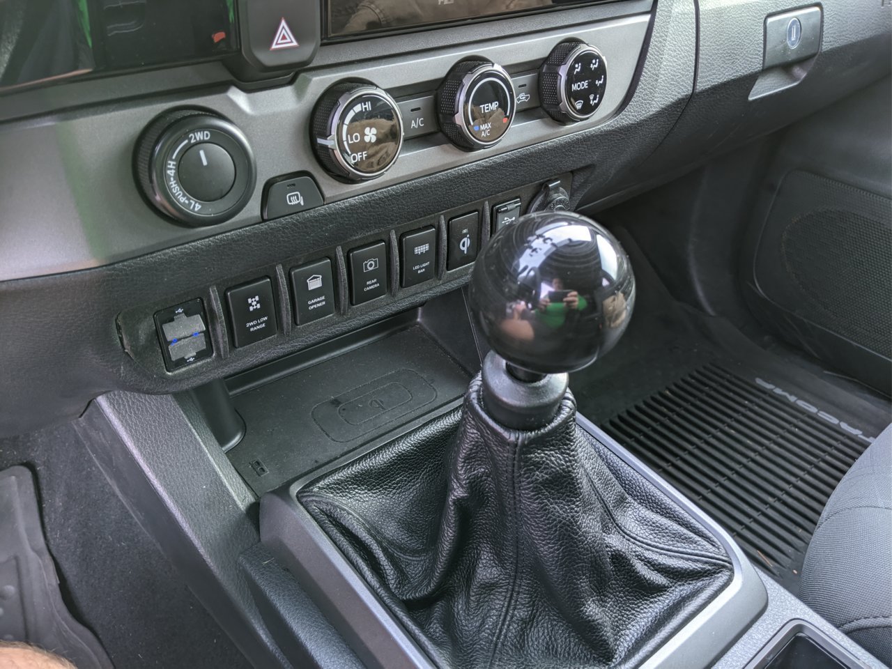

    Blacked out the 4WD switch with some etching primer and matte black paint.
    Edit: I popped the switch back open to verify that I did not lose the small plastic parts. While doing this, I trimmed off the two tabs so that I no longer need to push it to get to 4Lo. This works great when using the 2LM.

    Do you have the core short shifter
    tonered[OP] likes this.
  7. Jan 24, 2020 at 8:49 PM
    #27
    tonered
    tonered [OP] bartheloni
    Sep 25, 2017
    #231055
    31,338
    tony
    Lynnwood, WA
    That is just the stock shifter with a @7r41lbr34k3r knob and collar and a redlinegoods boot.
    I would really like to get a Core shifter someday. I'm not a fan of the chrome shaft and I'd need an adapter for the knob.

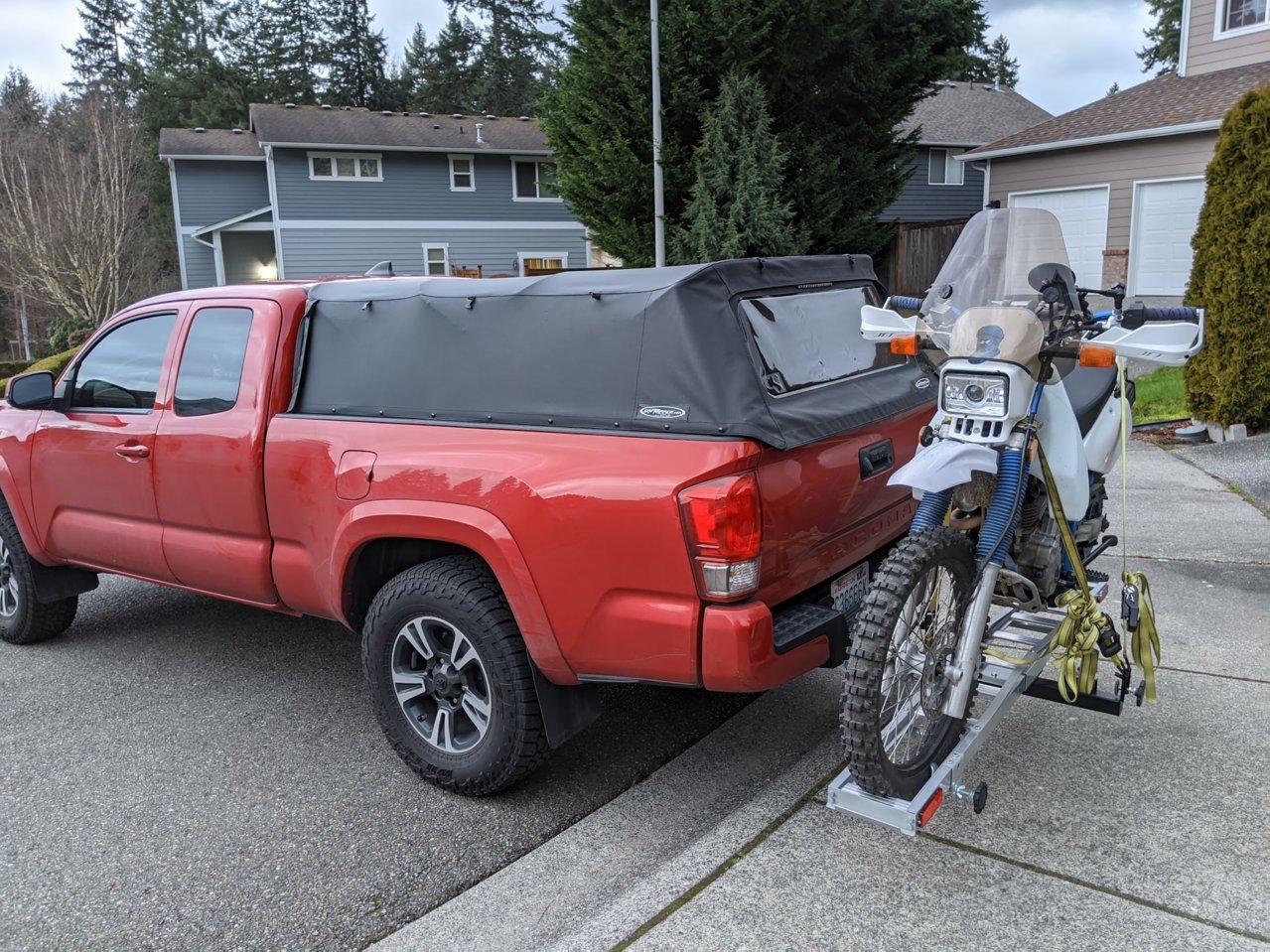

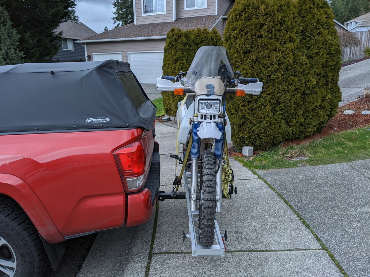

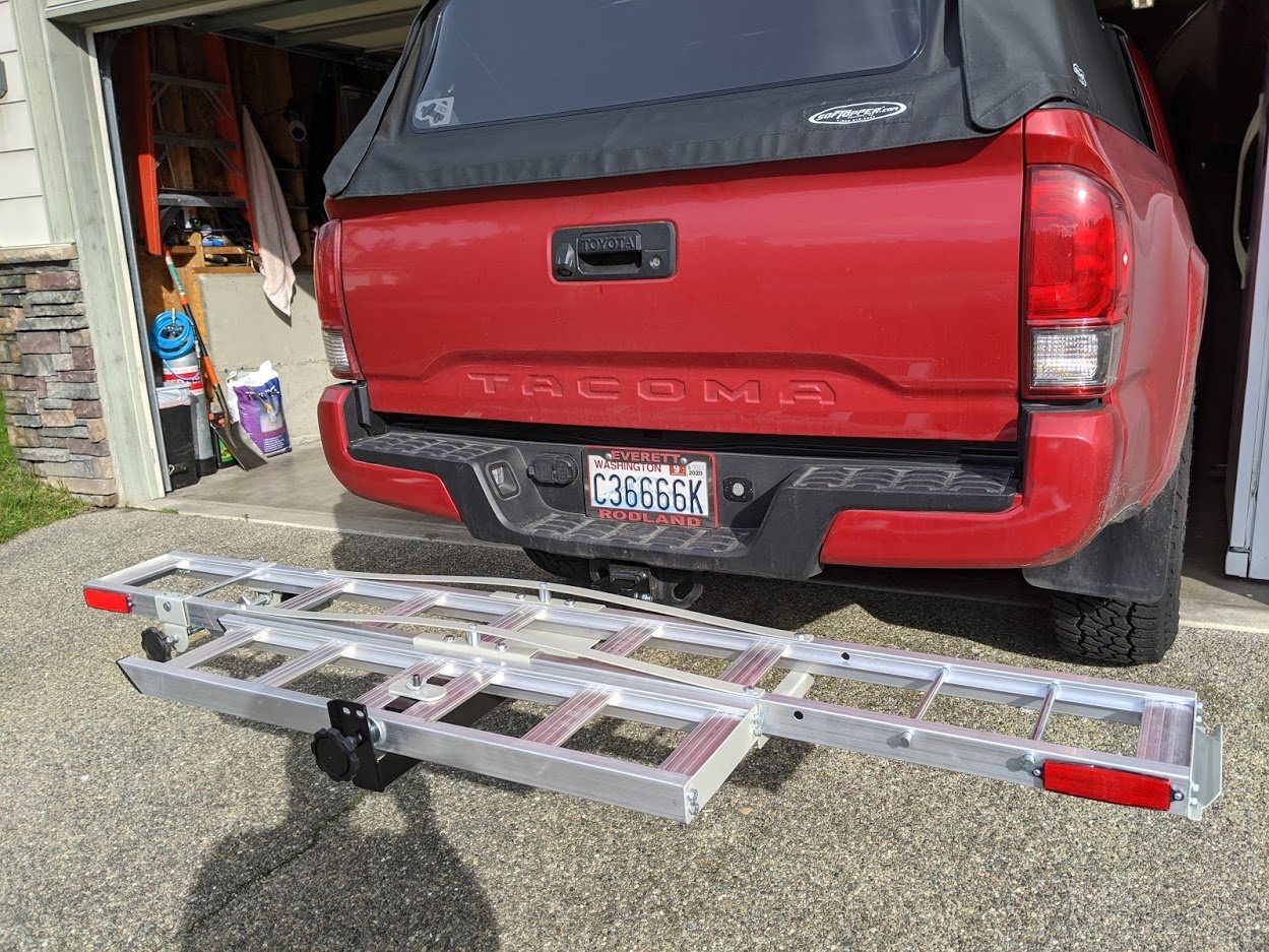

    This thing is killer: IMG_20200209_132243.jpg
    Some recommendations:
    -- Enlarge the strap holes in the rear (toward the bottom) as they are smaller than the ones in the front angles and need to be at least the same size for larger ratchet straps.
    -- The HF anti-rock clamp works surprisingly well.
    -- The front wheel knobs do not seem to be necessary. I may remove them.
    -- For heavy use, reinforce the main tube with a 1-5/8in bar about 12in long. I still need to do this.
    -- For easy loading, leave the removable rods in for the rear wheel. Once the bike is loaded and the front secured, lift the rear wheel up on to the main rail, pull the rods, and drop the wheel back in.
    -- To eliminate springing forward or rearward when releasing the straps, release the ones on the forks first.
    -- As shown, use any kind of curb or berm to decrease the ramp angle. This is especially helpful if alone.
    -- I am thinking of either using the ramp as a prop rod until the first strap is set or making something to do this. Edit: The ramp makes a perfect prop rod, which makes solo loading even easier.

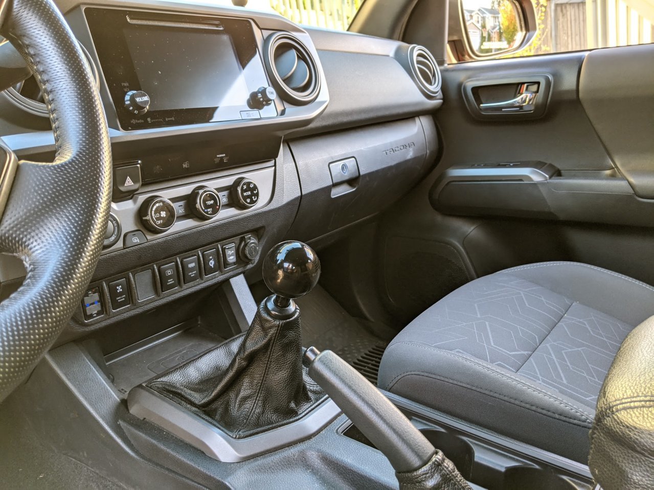

    V2 MT @7r41lbr34k3r collar!
    V1 setup:
    V2, the new hawtness. The flat black paint came out a bit shiny?
    Knob Polishing Update:
    Love that delrin.
