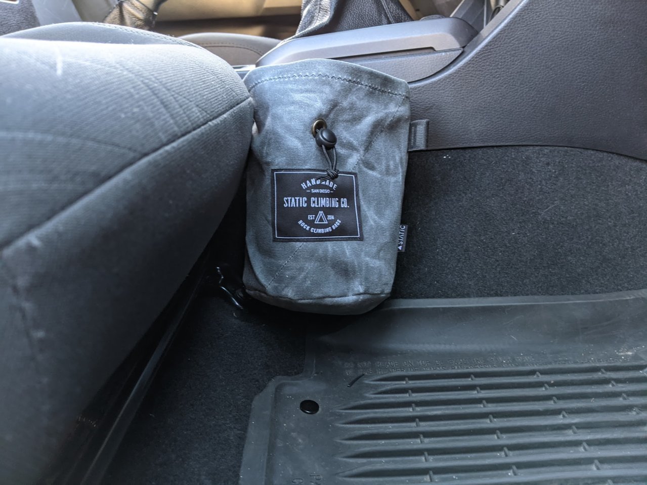

    Static Climbing Toolless Cupholders - Custom 64oz size:

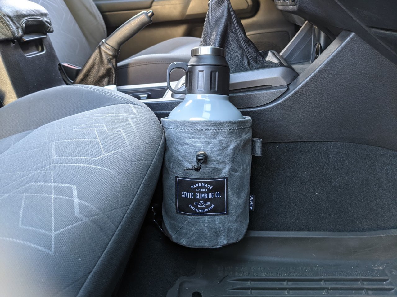

    A little mod from my wife:

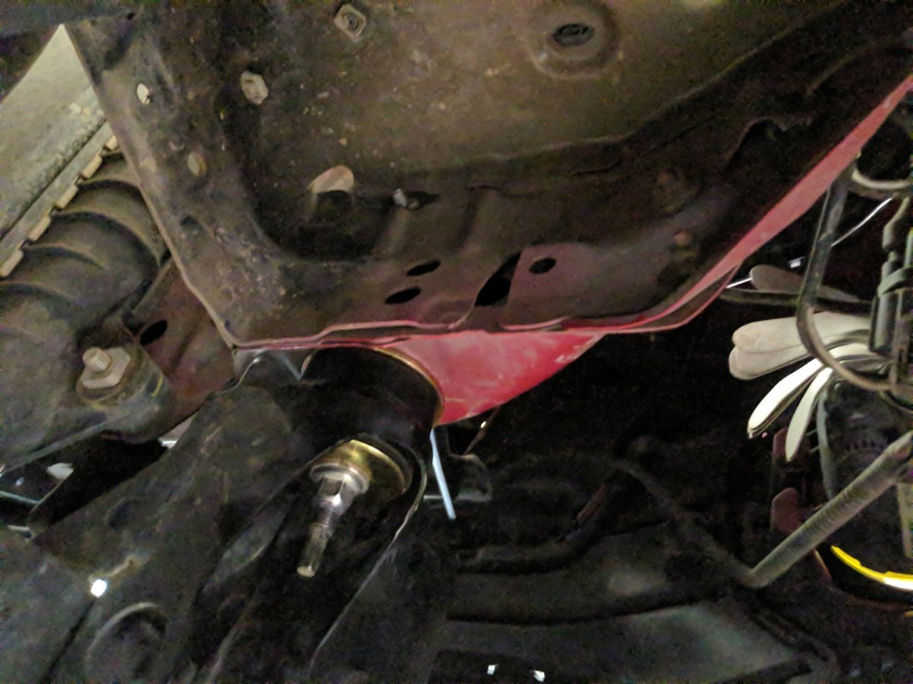

    Killed some squeaks and clanks with Energy Suspension's universal urethane bushings. Be sure to retorque them after some miles.

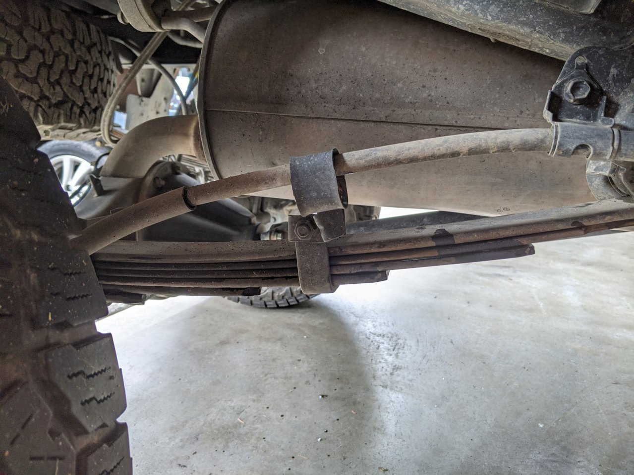

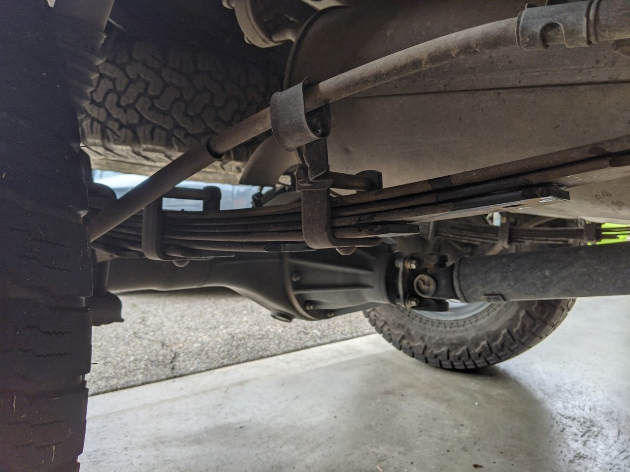

    At 53k, the stock suspension was more than done with life.
    Yukon Clamshell Bushing, Bilstein 5100s (4th Circlip left / 3rd Circlip right / +4in rears on the way), Icon RXT Option 1 Leaf Packs, and Carrier Bearing Drop Shims (Thanks, @Bertw192 !) are mostly done. The alignment from Omni Brake and Alignment in Totem Lake really completes it all.
    @memario1214 at HotshotOffroad.com was a great help through this kinda-unusual-for-TW setup. Hahahaha!
    Original Numbers with 3/4 tank:
    LF: 20 5/8in RF: 20 7/8in
    LR: 20 7/8in RR: 21 3/8in
    After fronts with 3/4 tank and new front body mounts:
    LF: 22 1/8in RF: 21 7/8in
    LR: 23 5/8in RR: 23 1/4in
    Plus 2.75in of droop over Stock:
    My favorite mallcrawling spot:
    Just waiting on the rears to get out in the dirt:
    I would recommend NOT following Icon's RXT instructions and keep the parking brake guide. Ream it, slap it on here, and tweak it with channellocks to follow the brake line angle:

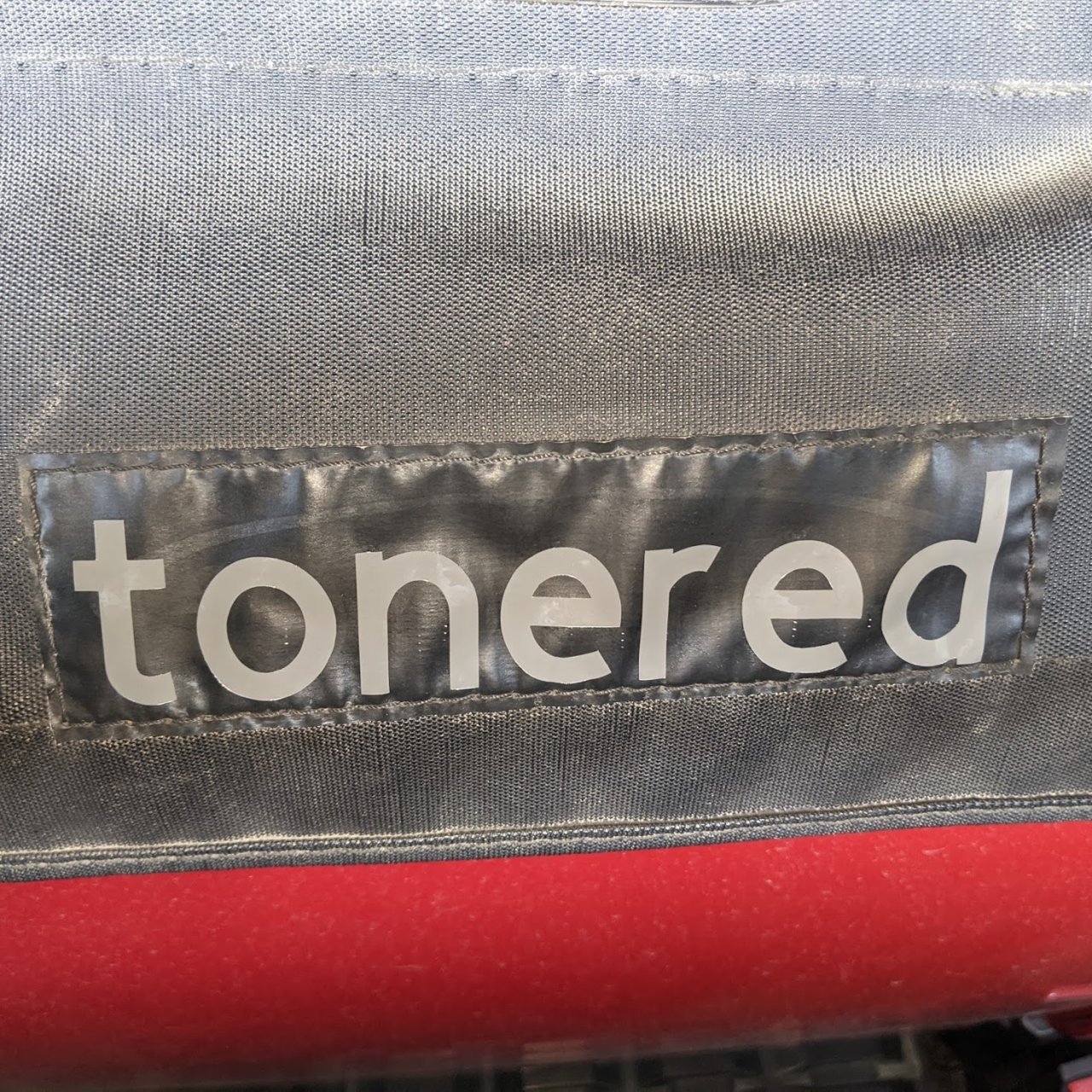

    Lynnwood, WA

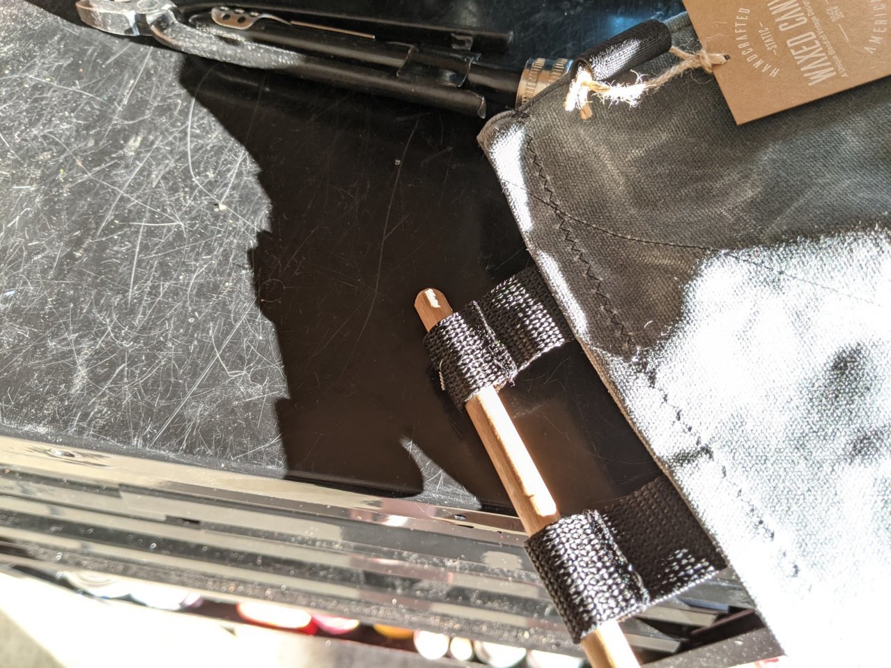

    BTW, ready for a laugh? The Pakayak handle fabric was starting to pull away. I attacked it with very questionable sewing skills. I think a blind person could have sewn them on more straight than that. :rofl::rofl:
    Feel more taut though. We'll see how it lasts.
