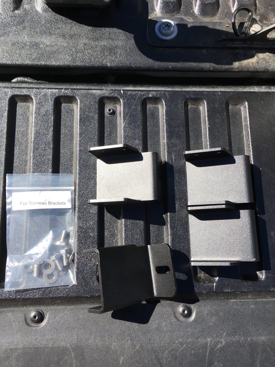

    You want a bed rack on your truck......but you have a Bakflip cover with relocated accessory rails :confused:
    MAX Modular has the solution!!
    How to order
    Go to our website and pick out the bed rack of your choice: https://www.max-modular.com/shop-max-modular/
    When asked "UPGRADE TO TONNEAU BRACKETS ($125 OPTION)"....say NO, and add the rack to your cart.
    Then add these little beauties to your cart: https://www.max-modular.com/shop-max-modular/tonneau-brackets-bakflip
    A few days later your new bed rack kit will arrive at your door :burnrubber:

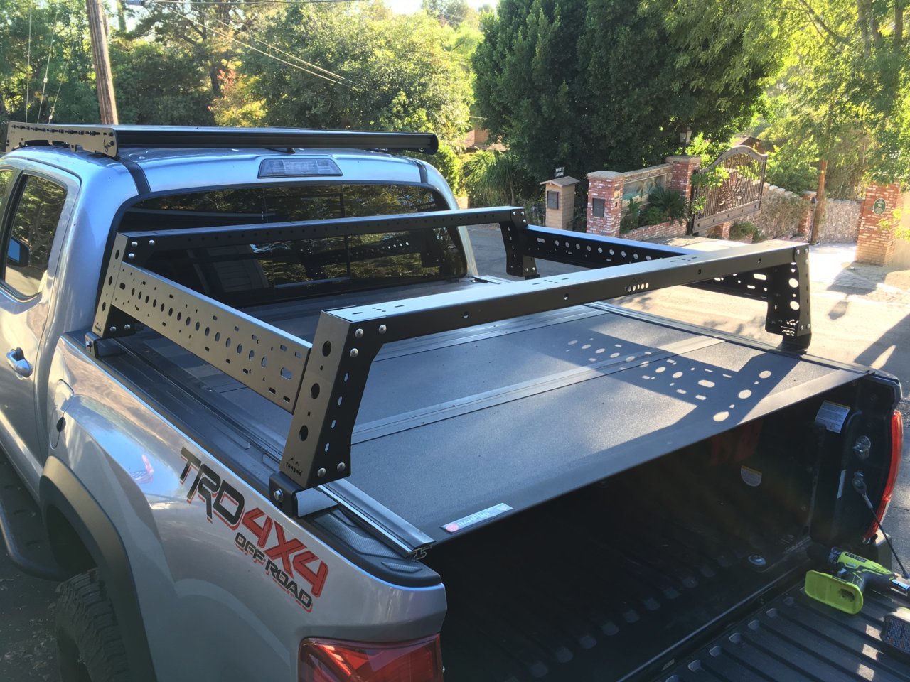

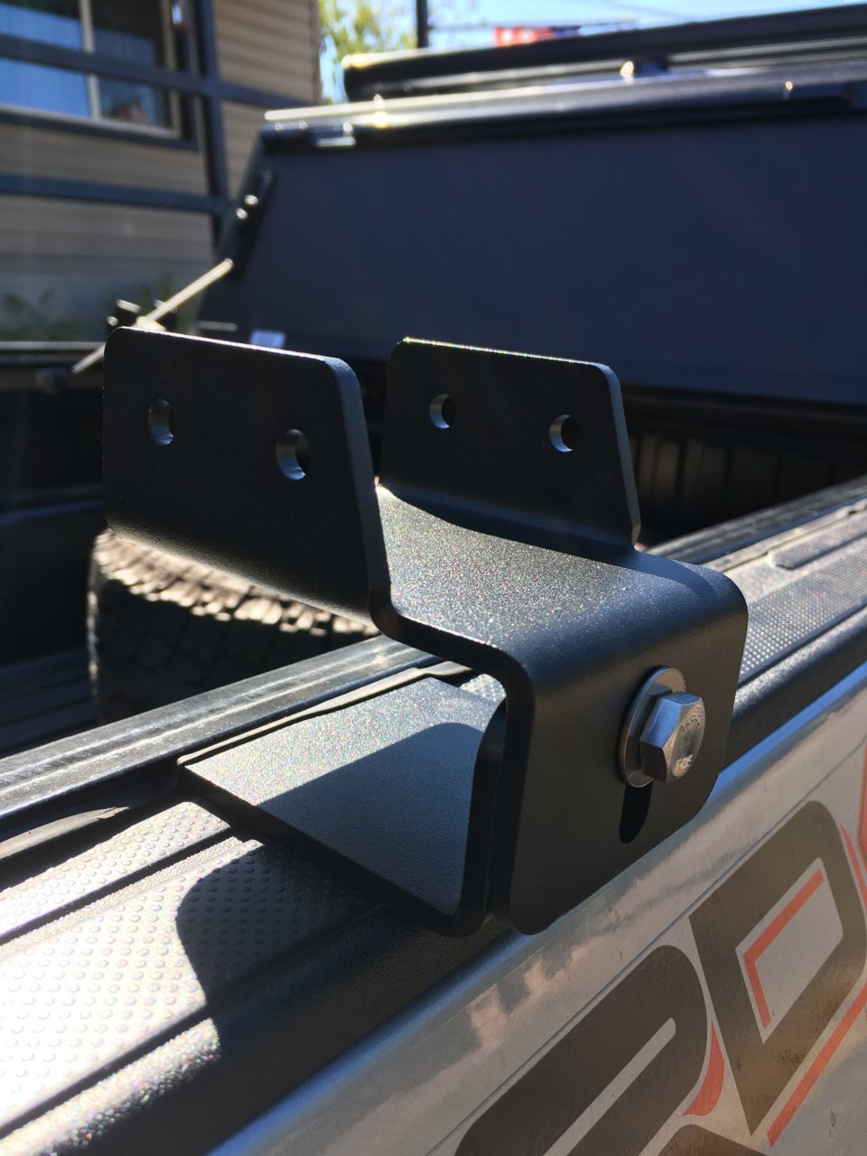

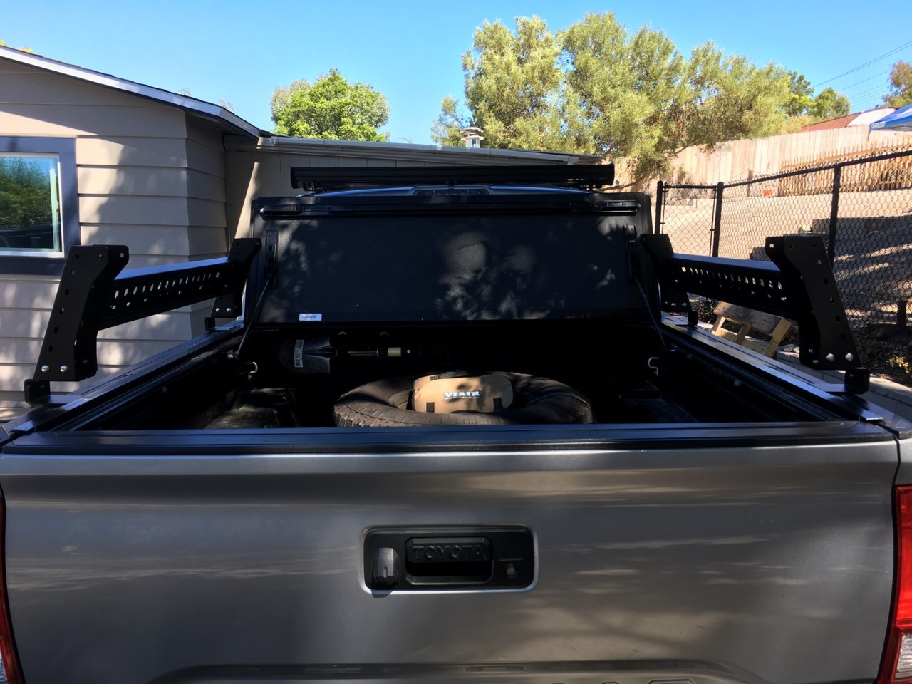

    The first BakFlip bed rack combo in existance (courtesy of @h5863emtmatt)
  19. Sep 18, 2018 at 10:04 PM
    #19
    h5863emtmatt
    h5863emtmatt Well-Known Member
    Jan 21, 2018
    #241911
    418
    San Diego
    17' TRD OR 4x4 DCSB
    Method Vex311, Toyo Open Country AT, 2.0 Fox Performance Coilovers/Reservoir, Total Chaos UCA, Pelfreybilt, Prinsu Cabrac
    I’m kinda big time now huh?
    KB Voodoo[QUOTED][OP] likes this.
  20. Sep 21, 2018 at 9:39 AM
    #20
    h5863emtmatt
    Jan 21, 2018
    #241911
    418
    San Diego
    17' TRD OR 4x4 DCSB

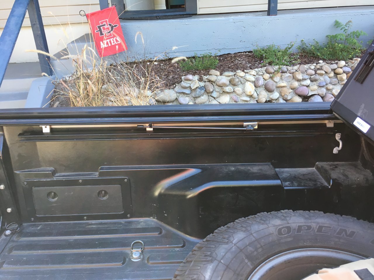

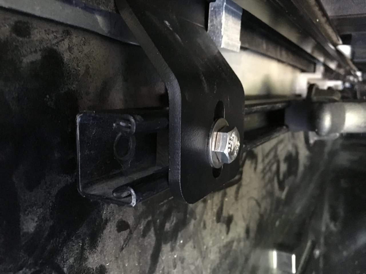

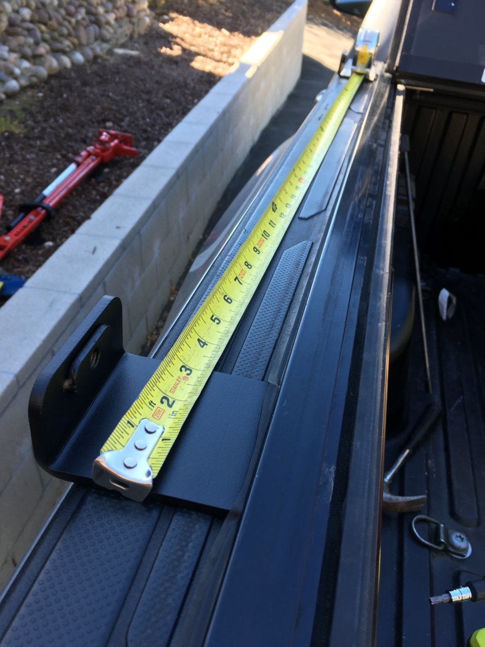

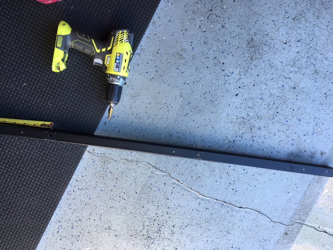

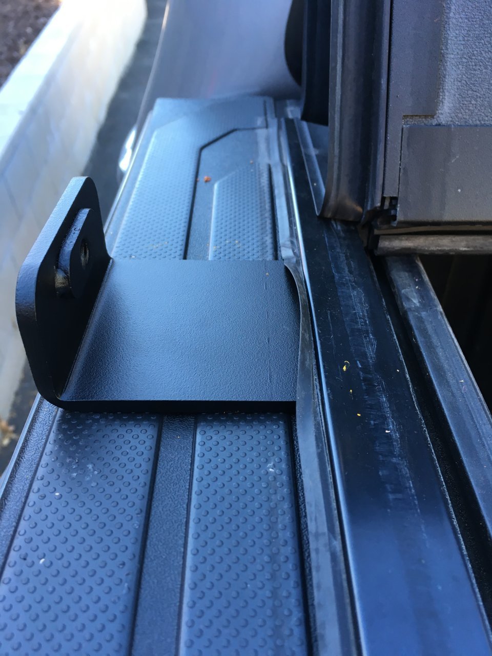

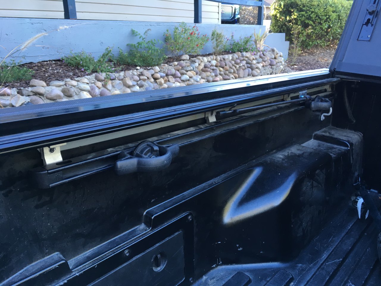

    I have the 46" short rack mid height. I wanted the option to have the cover open and or closed so I choose the mounting points further back to clear the folded up cover.
    The bed tracks are too far forward and needed to be moved back toward the tailgate 2 7/8".
    I removed each bed track using a Torx30 and drilled (3) 1/4" holes 2 7/8" forward of each existing hole.
    I remounted the bed track which is now moved back.
    Separate the BakFlip bed rail using the Torx30 leaving the mounting point closest to the bulkhead attached. Wiggle the the bracket in place. Its a pain in the ass.
    Measure 46" and install other bracket.
    Cover locks in and closes without issue.
    I left the cover open for ease of install. Also had to make slight adjustments to the rear brackets to fit the side mounts. Pain in the ass because you have to almost uninstall the BakFlip bed rails to loosen the brackets.
    Bolt to bed tracks.
    I uninstalled each corner from the brackets and closed the cover. Everything is lined up and bed rack ready for complete assembly.
    Done son. When you need the bed unbolt each corner and with a help of a friend remove the rack. Now you have your bed. All the difficulty came with the BakFlip not the rack. Assembly of the rack was easy and the product is awesome.
