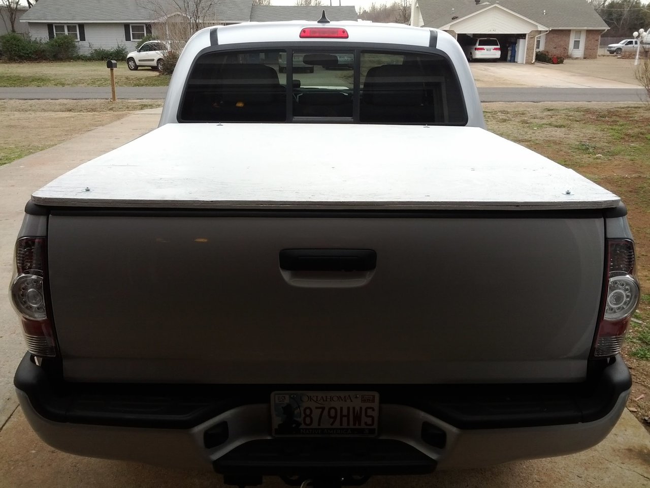

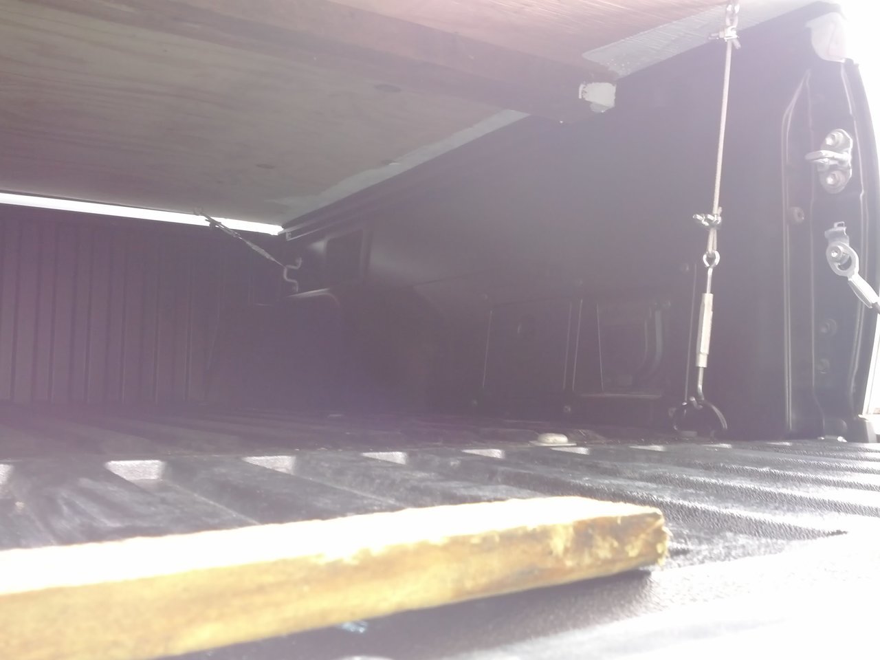

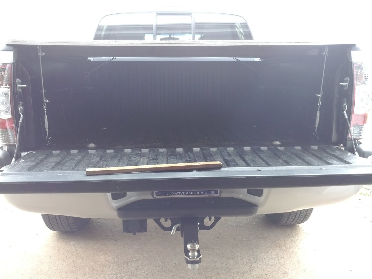

    im driving from OK to NY next week for my job and was in the same boat you are in, i made this yesterday :
    total cost was $40
    for cable, cable clamps, turnbuckles, eye bolts, foam weather stripping, wood. had the paint laying around

    yeah thats the only downfall is the tailgate still isnt locked. i only plan on using this for a week then its toast :D

    Looks good man. If I need something quick and cheap this is the route I'd go. That plus a tailgate lock would still come in under $100. which is half the price OP was willing to spend.

    thanks. and if i care i could sand the edges and maybe do some cleaning up and it would look even better for the same cost, im lazy and just dont care though lol. ill be adding 2 more mounting points (2 J bolts in the middle attaching to cleats) pics on that tomorrow prolly.
