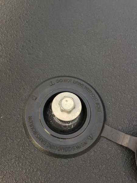

    I have a 2016 Tacoma SR5 (short bed) with the factory Tri-fold Tonneau Cover. Today I noticed that the Retention Bolt that holds it in place was missing.
    For the Bolt (64935-04010 part number) Toyota tried charging me $88!
    Does anyone have an extra they will sell or know if a back way to get ahold of one??
    Thanks in advance!

    That's what I'm seeing as well. If I can find the exact specs I might just get one custom machined? It's hard for me to spend that for a $1 Bolt!

    Damn that's pricey.
    I know it's a 12mm head so should be an 8mm diameter thread. Going from memory it's maybe 50-60mm long? I should measure mine sometime.
    Seems to be a wide flange bolt. I'd think a normal flange bolt, possibly with a fender washer, should work fine as a replacement.
    I'll try to remember to measure mine later today to double check sizing, perhaps someone else would be able to do so sooner.

    Like @gpb said, a washer will suffice.
    I grabbed two 8mm fender washers and they're roughly the same size of the factory bolt with the huge flange.
    Top bolt from the parts box is 8x50mm
    Middle is the factory bolt
    Bottom is 8x60mm
    Scale for reference. Have fun......:)
    Factory bolt backed out.
  14. Feb 21, 2017 at 7:59 AM
    gpb
    gpb Well-Known Member
    Aug 24, 2016
    #195408
    6,454
    Atlanta
    2017 White DCSB TRDOR 4x4
    Thanks, @GPsevinSixx -- looks like an M8x55 flange bolt plus 8mm fender washer would be dead on. Love it when I guess stuff correctly. :)
