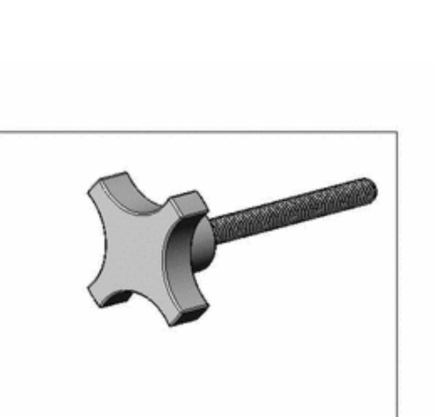

    This was kind of said before, but just to clarify, the bolt doesn't actually lock the tonneau as far as keeping things secure inside right? The tailgate needs to be opened in order to open any part of the tonneau right? So a bolt like the one suggested earlier and in the picture below would work and would not be a problem as far as securing things under the tonneau cover.

    That bolt with that giant crank head can work, but there is a waterproof cover that covers the factory bolt head. Get the correctly sized unit.

    Yep, that particular one doesn't look like it fits, but I was thinking something along the lines of not needing to keep a socket to open it. A 12 mm socket is not secure either.

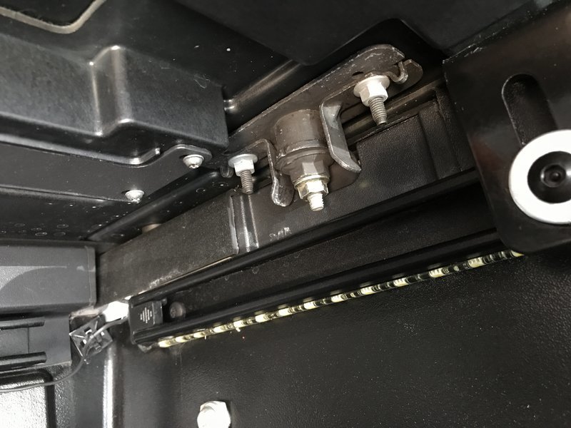

    Check one of my prior posts in this thread. I backed mine underneath with an extra M8 nut to act as "jamb nut". Should give you an extra amount of security.

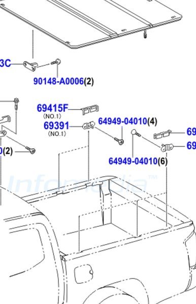

    Since we're doing this...you know what size these $3 hex screws are? 64949-04010

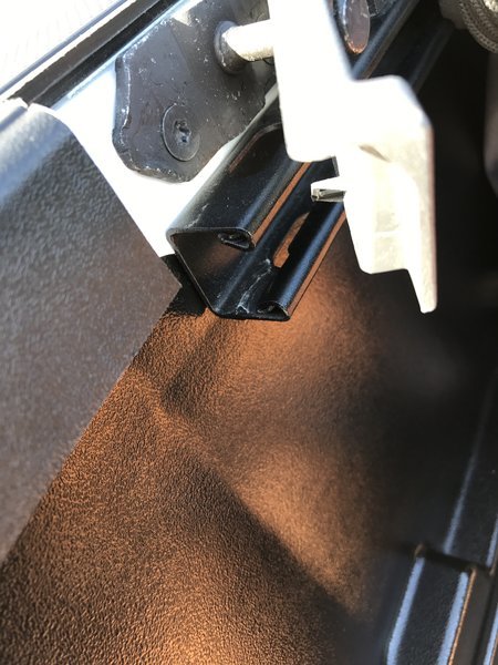

    Countersunk torx. I don't have a torx bit handy at the moment to pull it off and measure thread size. Looking at the size of most of the fasteners for the cover, I would think 12mm hex head style with an M8 sized thread. I think you can get away without it being countersunk if you had go cheap, but you can't use those bolt head covers on the striker.
    Here's that jamb nut I mentioned earlier..
