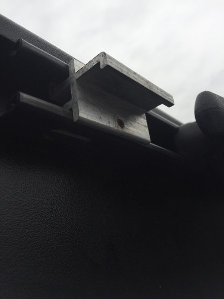

    i was going to install the quick fist that I received yesterday but can't figure out how to remove the metal bracket that's in the rail system... the truck came with the cover installed already. Any help would be great! Thanks IMG_4388.jpgIMG_4389.jpg

    Is that rusted circle on the outside a screw? Wonder if they just tapped it into the rail

    Looks like a torx bit screw... If it's stripped you may have to just drill it out.

    Drill out the screw and persuade it gently with a hammer towards the end of the rail if it doesn't slide freely on it's own.

    Yea that's rust on it, looks to be tapped it's not a screw...

    That bracket is attached with an "allen" screw. A little PB blaster and the correct size allen wrench and it should come right out.

    I have that same bracket for mine and this is the correct answer.

    same here..........set screw to hold bracket in place on rail. These 4 little brackets suck at keeping the cover in place on frwy/in wind.....I added tie down straps up front thru tonneau frame and a bed rail cleat, also in the middle where it had no brackets & left the clamp/bracket in place on rear section so it can be opened easier for access. Almost lost cover on frwy a couple of times where wind bumped clamp off the bracket up front. It doesn't move a bit now with strap/clamp in front, strap/cleat in middle & reg clamps out back.

    thank you guys! I guess the rust on the end made it hard to tell if it was tapped in or not.. I'll have to find my Allen key set and hope I have the correct size. Then I'll install them! Don't have anything yet to attach to them though haha

    Got the bracket off! Thanks guys! Now to figure out how to get the quick fist in the rail... Seems to large so guess I'll have to find a spacer to put in the rail and bolt the fist to it

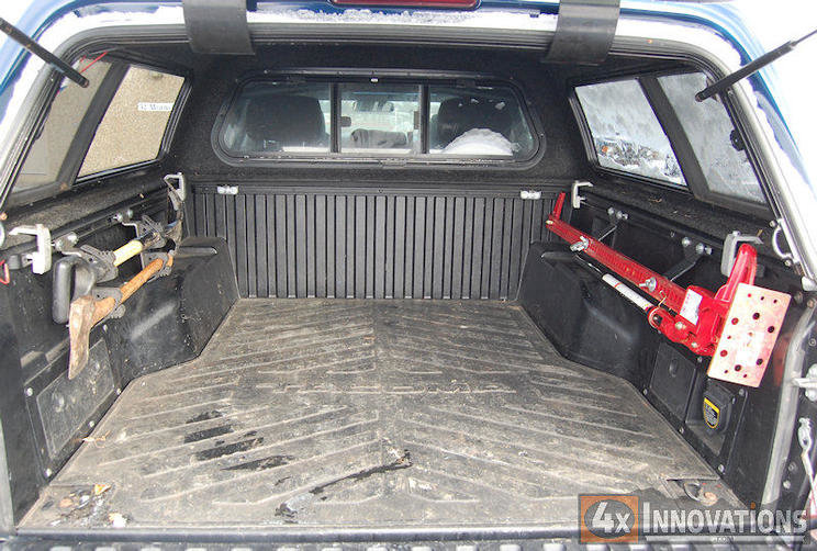

    I have brackets that mount into bedrails that the 4 quickfists are mounted to...........not sure but think the brackets came separate. Could be from one of the vendors here that make all the hood brackets for lights/antennas & tailgate brackets and such. Lemme see what I can scrounge up about this. All my hi lift jack and quick fist stuff fits under my tonneau.
    Here ya go.....link to vendor
    https://www.tacomaworld.com/threads/quick-fist-mounting-kits.353913/
    pic like my setup from thread above - I just have tonneau instead of shell
    88nitro305[OP] likes this.
