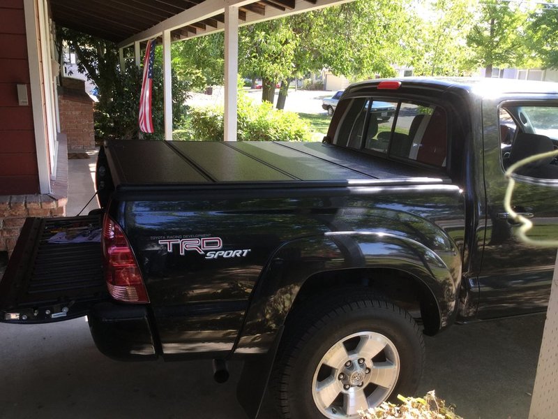

    I installed my Fold-A-Cover G4 Elite yesterday (and finished tweaking/adjusting it today). My initial impression is it's a well engineered cover and solid. I like that I can open the hatch closest to the cab and the hatch by the tailgate on their own, plus they both have locks. Just got my remote Pop & Lock in today but I don't know if I'm going to get to install it today or not.
    This seems like the best system to me. I can unlock the tailgate with my key fob and put stuff in the bed. If I need to raise the tonneau then I can unlock it manually and do so. No holes drilled in the tailgate.
    I have 3 recommendations for anyone installing this product:
    1) watch this video several times. It's the best one I found out there.
    https://m.youtube.com/watch?v=S6RgFPg6sFs
    2) if you're anal, OCD or a perfectionist medicate yourself before you install the cover. I spent a lot of time after I installed it loosening bolts, pushing/pulling things this way and that trying to get perfect gaps and lines. It's an 8 year old truck that was never manufactured to space shuttle tolerances. I had to accept "close enough" and move on before I threw too many tools into the neighbors yard.

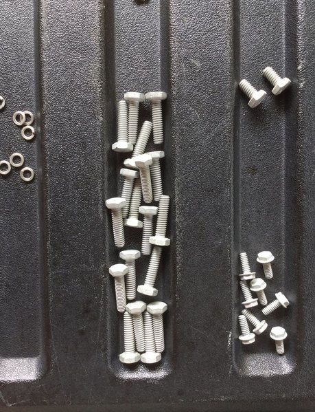

    3) for the love of God (and your sanity), separate and mark all of the hardware that comes with the cover before you start. I wasted too much time doing this when I started the install and it was frustrating. It's all together in a big bag and not marked in any way. For me, this is the one big knock I have for Fold-A-Cover. Is it that much more $ to separately bag the hardware? There are several things that look very/nearly identical and the drawings in the instructions do not help. There are 6 brackets - 3 pairs of 2. Subtle differences include a flat top or slightly angled, small bolt holes or no bolt holes. Figure it out during your intial sort and mark them.
    Let's play a game. In the picture of the long bolts below, 2 of these things are not like the others. Can you tell which 2? Answer will be forthcoming.
    And the finished cover:

    Very nice! Thanks for the video. Could you tell the thread size of the bolts that you would place the wingnuts on? I'll find a part number for the wingnuts and post it up. The two aren't like the other? Different thread pattern?

    Very good! You must have installed one of these already. It drove me nuts as I didn't realize 2 of those had different threads so I was looking for "lost parts" in the packaging, on the ground, in the open spaces around the tailgate, etc...
    I didn't get the thread size. I was rushing to get it done (or done enough to drive it) as I was playing golf in the afternoon with friends and was running late. I'll see if I can pull one out and take it to the local hardware store when I get a chance. They have a thread gauge there.

    No I haven't yet, but I'm a fix it guy at work. I have been researching covers and settled on this cover in the fall, so I pay close attention to the posts and vids etc. Glad it came out so good. I'll 'probably' get the pop n lock but I'll put the tab on it I think, not 100% sure yet.
    Look at this page, Item 1, it's stainless Thread is possibly 1/4-20.
    http://www.mcmaster.com/#standard-wing-nuts/=yfbxa9

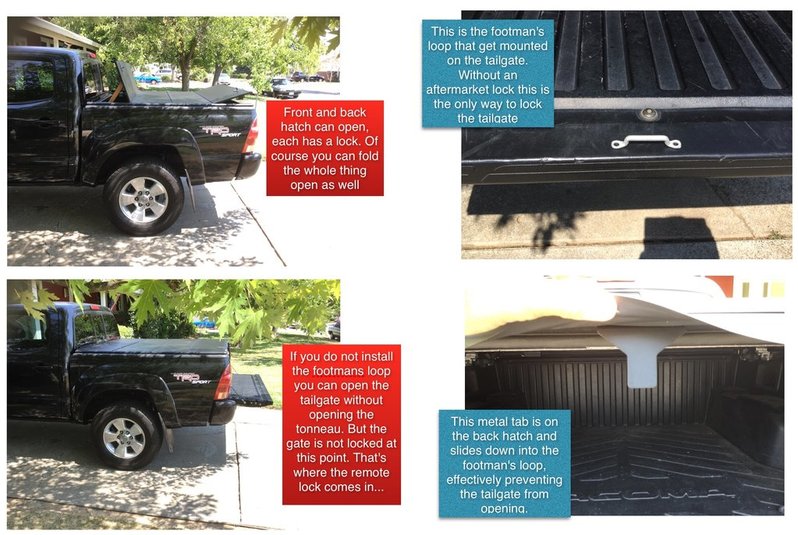

    I'm far (far far far) from an expert but here's what I know. Or don't know...
    I have no knowledge about the caddy. Your best bet would likely be to call the company and ask.
    Locks - as you know our tailgates have no locks. The fold a cover has 2 locks, 1 for the forward hatch (next to the cab) and 1 for the hatch at the tailgate. With this product they supply a thing called a "footmans loop", which is just a fancy word for a little piece of metal that looks like a mini towel bar. Well, not exactly but the image should give you an idea. The loop is attached to the top center of your tailgate (inside) by way of drilling 2 holes and then is riveted in. The back hatch has a metal plate that slips into the loop when you close it, thereby making it impossible to open the tailgate until you open the hatch.
    I did not want to drill holes in my gate, have to open the tonneau cover to open the gate or go by a rivet gun (fairly inexpensive around $12), so I'm opting to install the power lock and not the loop. The power lock secures the tailgate and can be opened without lifting up the tonneau.
    So in addition to not drilling holes, buying rivet gun, etc.... the additional benefit with this product is if the power lock actuator fails I can easily open the tonneau and access the tailgate panel to fix the lock.
    I know my powers of description are weak so let me see if I can find a pic or two of the loop.
    Ok - hope this helps:
