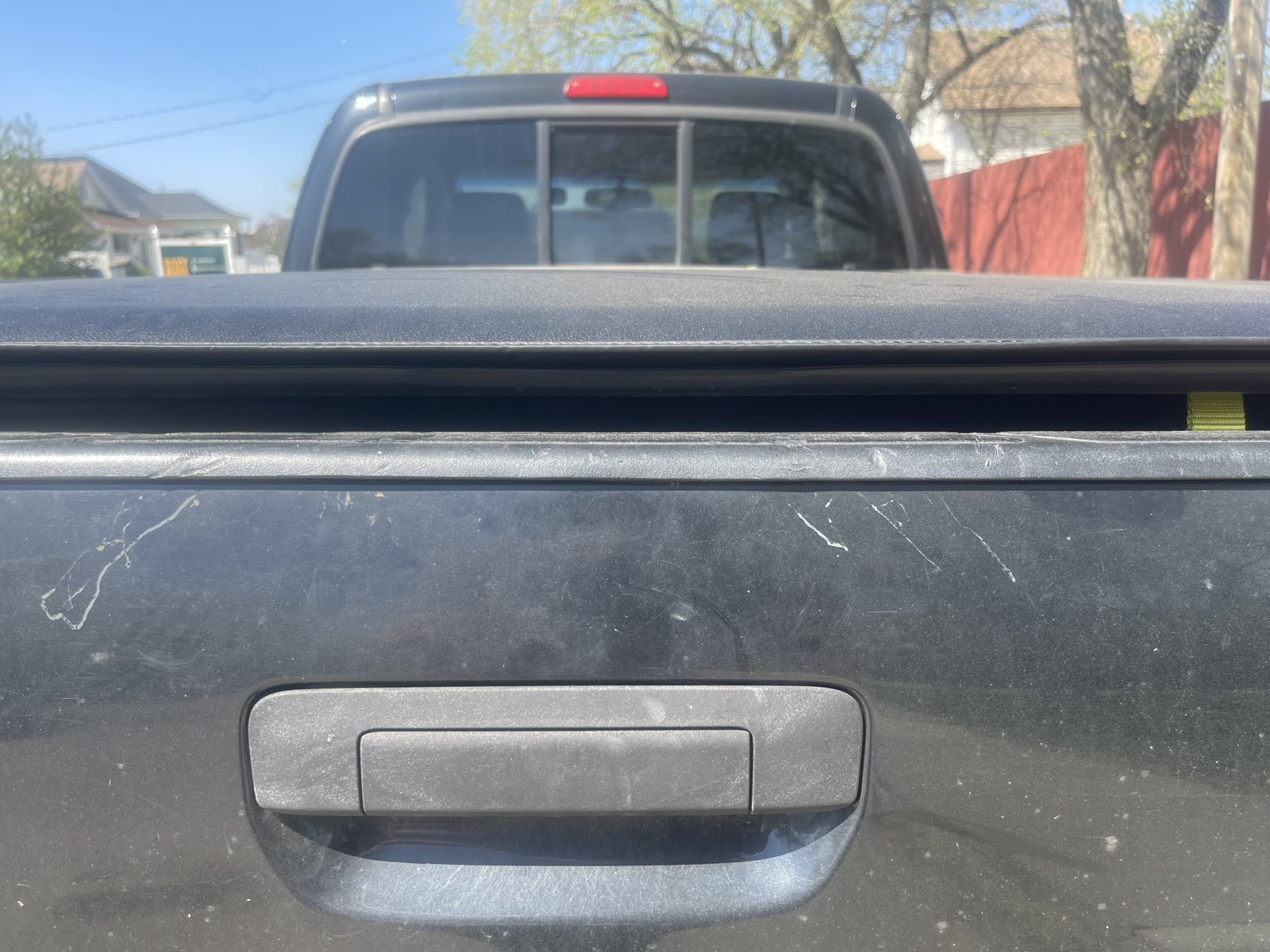

    looking for any ideas to fill the 1/4” gap. while still keeping the overall look of the tail gate.

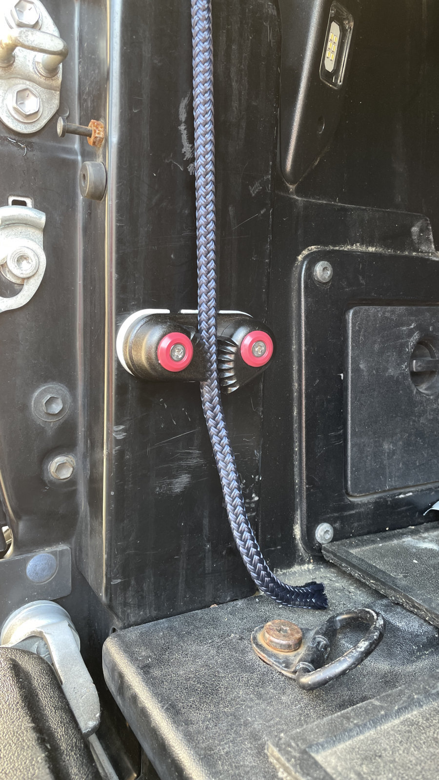

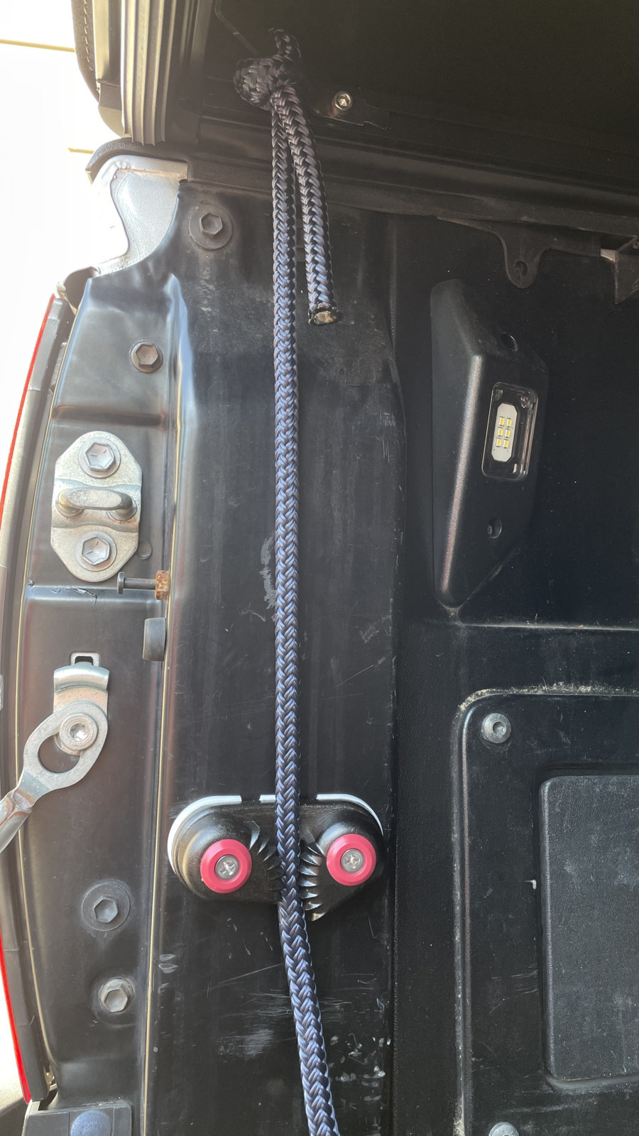

    IMG_2107.jpg IMG_2108.jpg Thats a big gap. Not saying you installed it wrong but are the clamps adjusted all the way down on the rails? You could add some thick foam insulation to the tonneau . I had a similar issue with my tri fold cover and i ended up putting some cleats and rope to the tonneau to pull it down and keeping someone from reaching there hands in there.basically just tying a knot to the rail of the tonneau and pulling down tight and clamping it. Takes only seconds to do and undo. My pics always end up first before the post

    It's the wrong tonneau cover. I'm betting you have a early gen 2, 05-11? That tonneau cover looks like it is for a gen 2.5, 12-15. They have taller tailgates and the front of the bed is taller as well. Easy fix would be to swap out the front and rear gaskets with ones that are thicker.

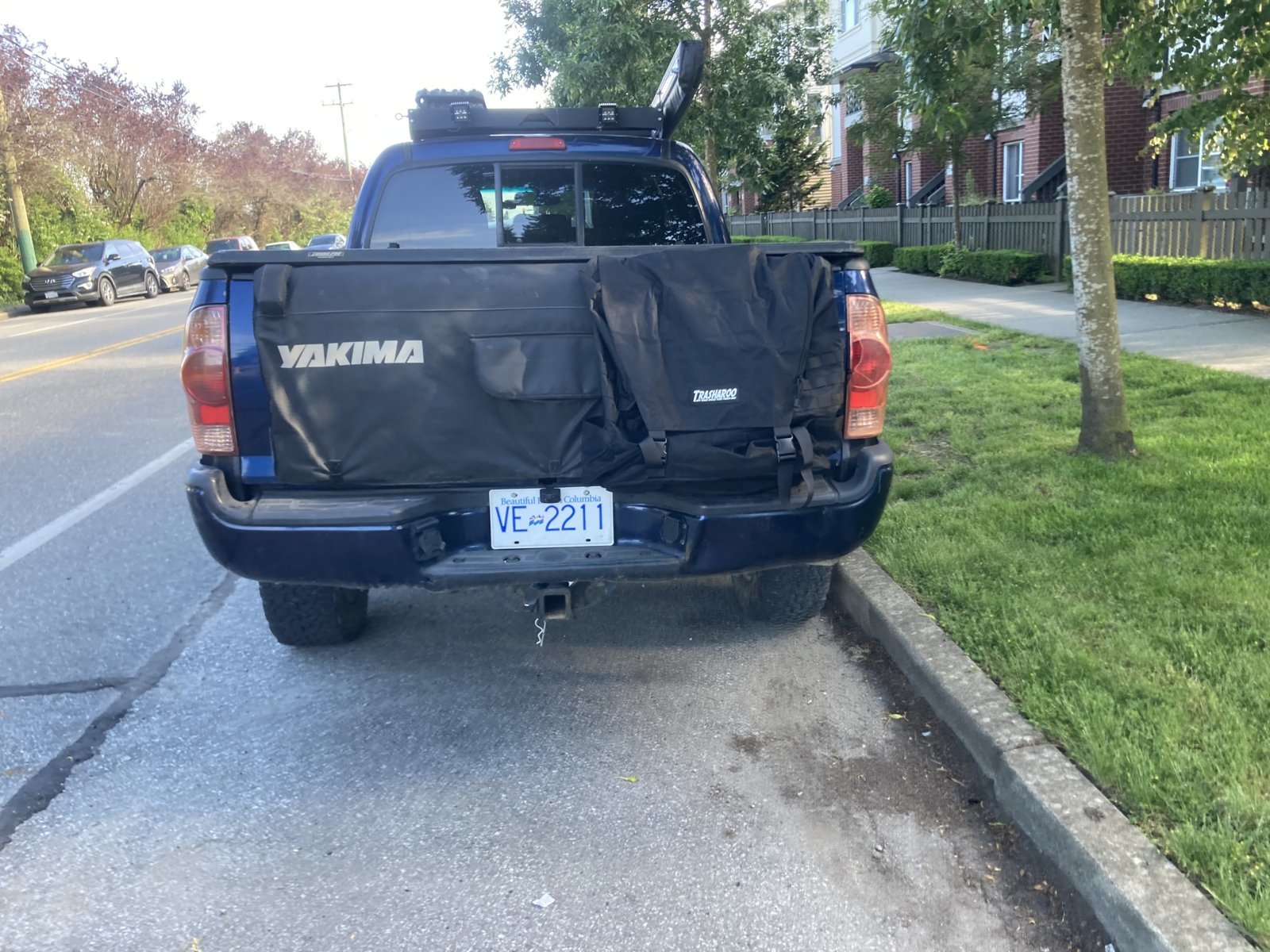

    Throw in a tail gate pad.
    Or there was a thread on this form about a custom made plastic, that is raised. Can’t find it tho.
