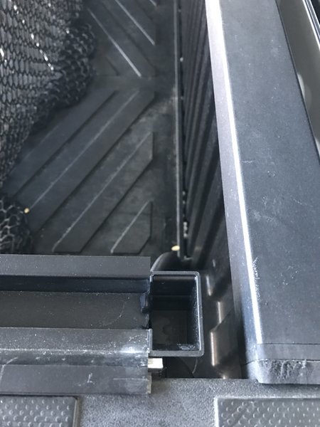

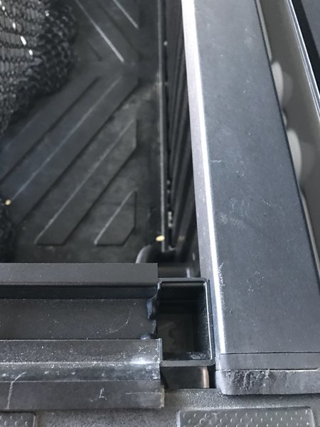

    I had the Extang encore tonneau cover installed by the dealer and the side rails keeps sliding causing the cover to close improperly. Does anyone know how to fix this?

    Did you find a resolutuon? I have this issue too. Just a month old and i noticed the passenger side sliding. I just called tonneaucoverworld and sent them a video clip. Waiting for their reply. Other than this issue, i love the cover. Hopefully just a defective rail.

    i have the Encore and like it. i installed it myself with no issues yet. can you guys get a little better description of what's going on? i can't really tell what the issue is from the pics & description.
    EDIT: n/m i see the gap now. no i haven't had this problem but i'll go check to see if everything's tight.

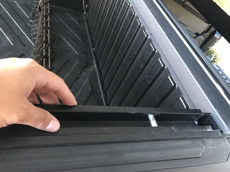

    So i figured it out. The drain rails needed to be re-adjusted. I loosened everything up and found that depending on how you tighten down the rail screws, it won't really grab the aluminum brackets. Pushing down on the siderails while tightening puts pressure on the clamps and keeps tension on them. Thats what keeps the rail from being able to slide like how mine were doing. Just wanted to put this out there for future encore owners who may have these issues ...
