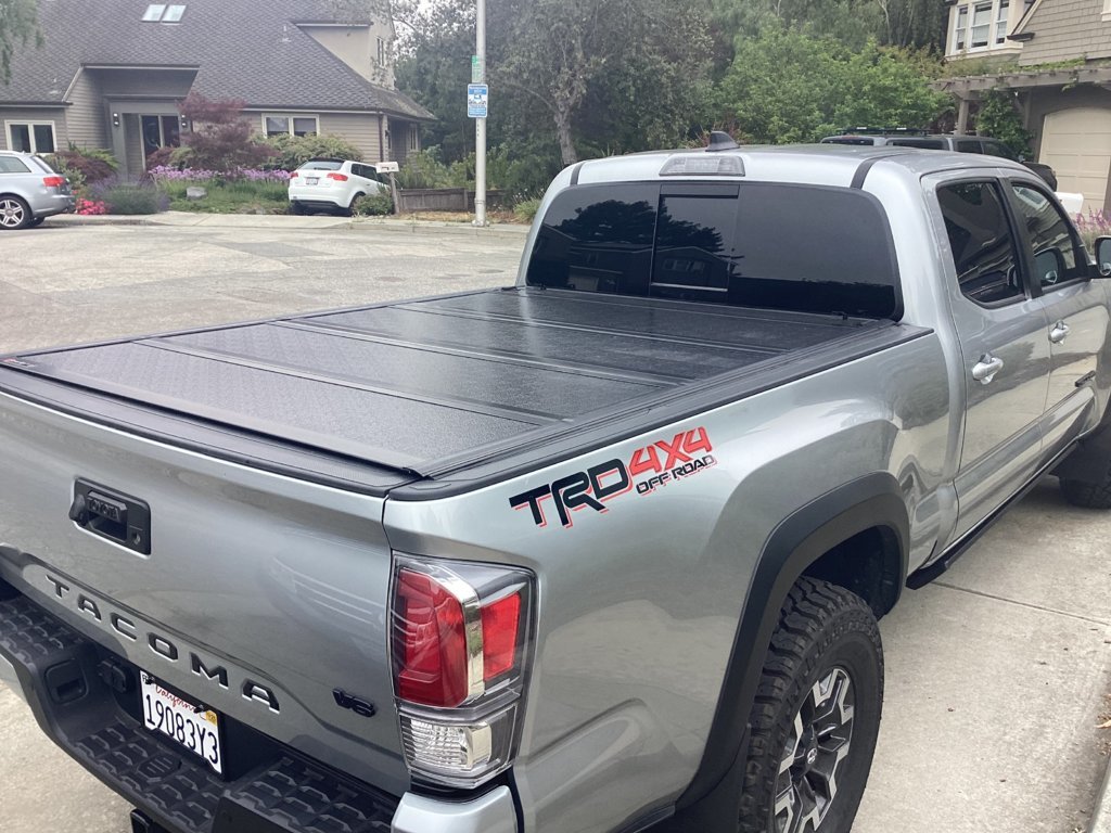

    I don't know if I've every found one that stayed totally dry. Most leak in the corners and butyl tape can help. If yours is cracked on the hinges it might help but I would look at the corners near the cab.

    Try butyl tape in the corners. By the cab like mentioned above. You can also take the cover off. See if the latches are lining up properly.

    I had a Bakflip on my Frontier and have one on my Taco now. They both work about the same, a bit of water gets in, not much. When I camp anything that must remain perfectly dry is in waterproof duffles or bins with lids.
    I did add additional weather proofing to the two front bed corners with additional foam material.
    We just had days of epic rain and only a small amount of water got inside the bed.

    I have the Bakflip X4S. It leaks near the front and back corners. Black gorilla duct tape over those spots makes it almost 100% dry. They all leak.
