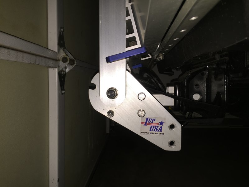

    I have the 1UpUSA single rack and it made contact with the tailgate when folded up. I modified my 1Up by moving the crossbar mounts up about 2 inches, effectively lowing the rack enough to clear the lowered tailgate. This required a bit of Dremel work with a router bit and attachment. I leave the rack on the truck 99% of the time with no issues. 1Up also sells "reverse" side panels that lower the rack but I think it lowers it to much.

    Sorry if I confused you. When folded up in the full vertical position as shown in the picture the lowered tailgate contacted the top of the rack. I have the single rack 1Up and leave it on the truck most of time so I wanted to be able to use the tailgate without having to fold the rack down every time or worry about damaging the tailgate. That is why I modified it.
    You will be fine using the multi-tray 1Up. In the lowered position without bikes the tailgate should not contact it when it is opened.

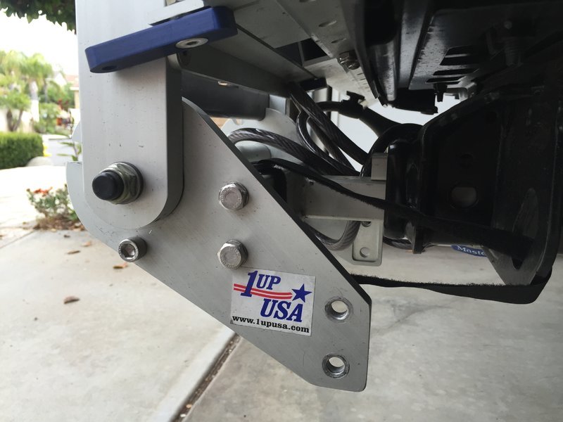

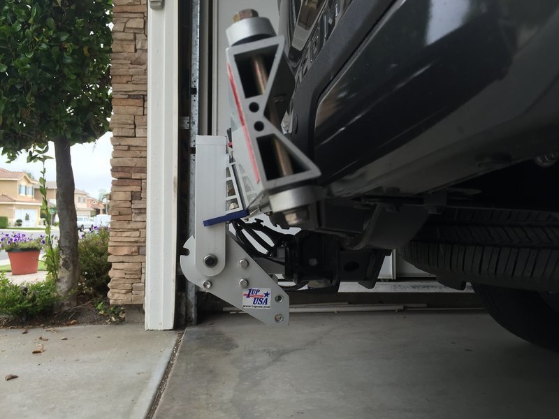

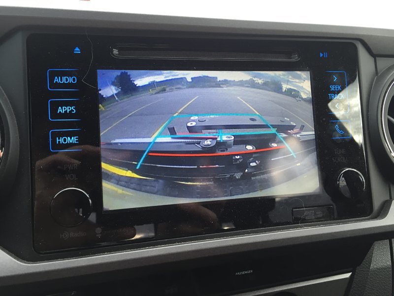

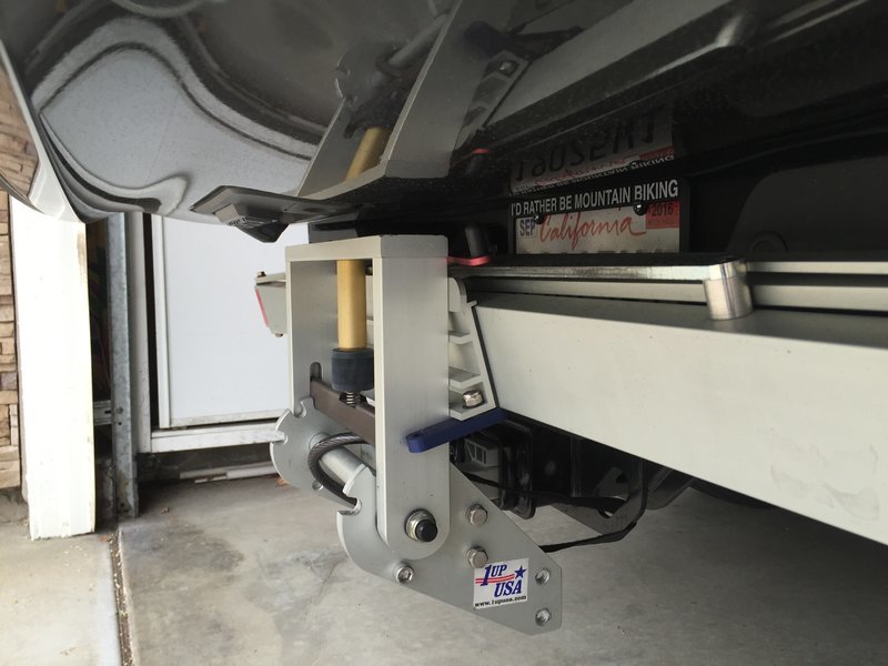

    My 1Up is installed 99% of the time. It does mess with the backup sensor, however the backup sensor is redundant to the backup camera anyway and I found the beeps annoying so I have never used it, even when the rack is not installed. The BSM is not affected.
    When folded up the rack will make contact with the lowered tailgate so I modified the side panels of the rack so that the rack now sits about 2 inches lower and clears the tailgate by about 1/2 inch. I've used many bike racks and the 1Up is by far the best for ease of loading/unloading and size. It is pricey but will most likely outlast your vehicle.
    A tip: If you mostly ride solo then get the 1Up single. If you occasionally take your your buddies get a $150 Hollywood four-bike folding rack as a spare rack. It's much cheaper then spending $200 for the additional one-bike add-on for the 1Up.

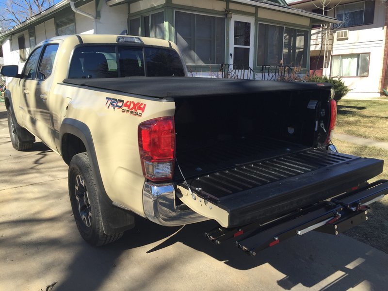

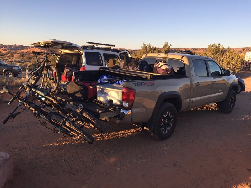

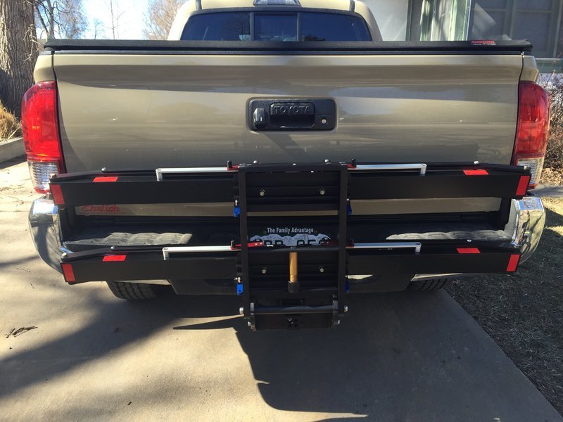

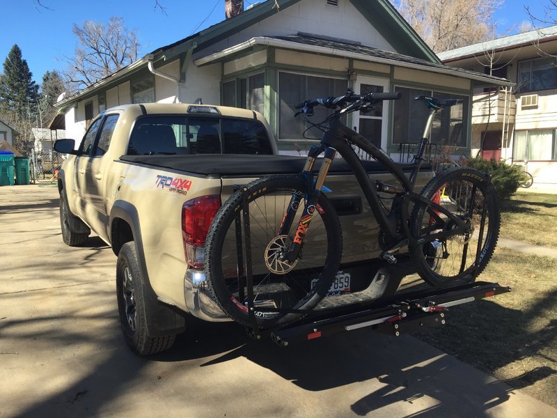

    I have enjoyed the 1Up. On only one occasion I needed to remove it so I could transport 4 bikes. It was such a pain to transform the truck into the tailgate pad version I'm considering purchasing the double add-on, however for the price I'm still hesitant. You can't hang bikes over the gate and also use the 1Up. I have the Trifecta (I believe) folding cover. It works. I can keep all my gear hidden and keep smells out of the cab. I'm looking into a topper for future use but again its the money issue. The 1Up is fast, convenient, and super stout. I love how secure the bikes are and also how streamlined it looks when folded up because you can leave it pushed all the way in. If you have a lift gate or topper there will be a clearance issue with the handlebars, but you can pull the 1Up out to accommodate.
