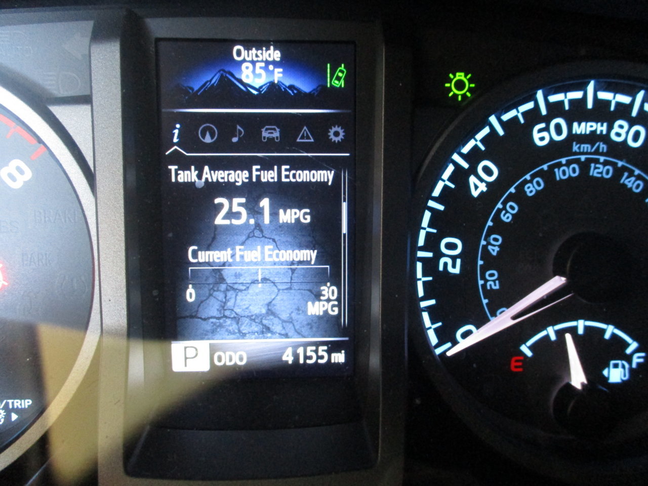

    That's YUGE mileage! I'm seeing 21 max. I've got one size up tires, 36/32 psi, bak flip tonneau cover, rest is stock. What psi and tires you running?

    Curious only, did you compensate for the new tire diameter in your calculations?

    My truck is completely stock, no mods at all.

    I did.... conversion chart did the math for me. I went 265/70/16 to 265/75/16 with duratracs, E rated.

    so your saying you get 45mpgs?
