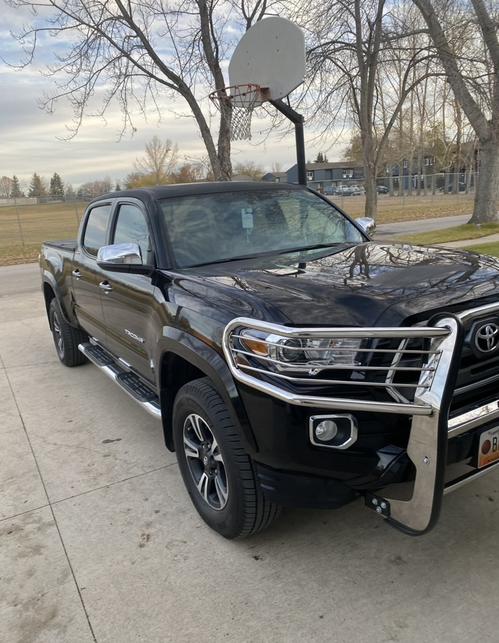

    You need to provide a proper picture of the tonneau cover as it is currently installed on the truck. If it is truly installed backwards you will probably need to crawl under it and release the section at the cab end first. But again, you need to provide pictures. And you need to take that stupid bull loaney bar off of there before it wrecks your truck. A small bump and the top end of it crashes into your hood and headlights and grille.

    I don’t need to see the tonneau but I’d like to see a full frontal shot of that front bumper. If the zombie apocalypse starts, I’m following you.
