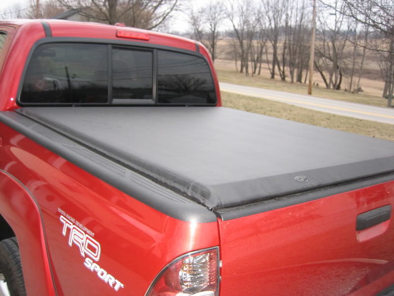

    I didn't know about the tailgate seal. What is that anyway?
    You can see in the picture above that it seals pretty tight on the tailgate. I don't see how water could possibly get in there. If it did, it would just run down the tailgate and out the bottom.

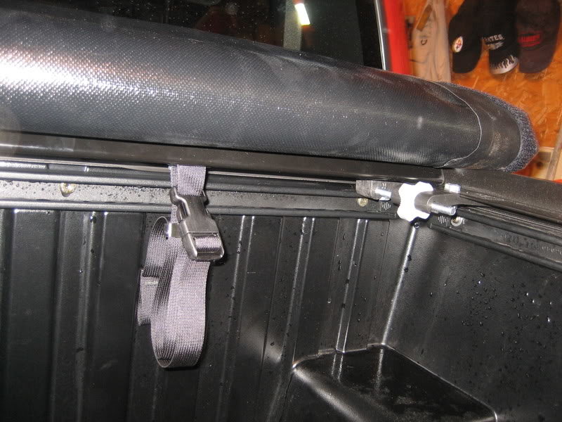

    Since these might help the OP as well...
    Notice the snow in the bed...I did it when it was cold outside! Didn't cause any trouble besides cold hands.
    Again, NO CUTTING FOR ANY OF THE ACCESS MODELS ON THE 05+ TACOMA!!!

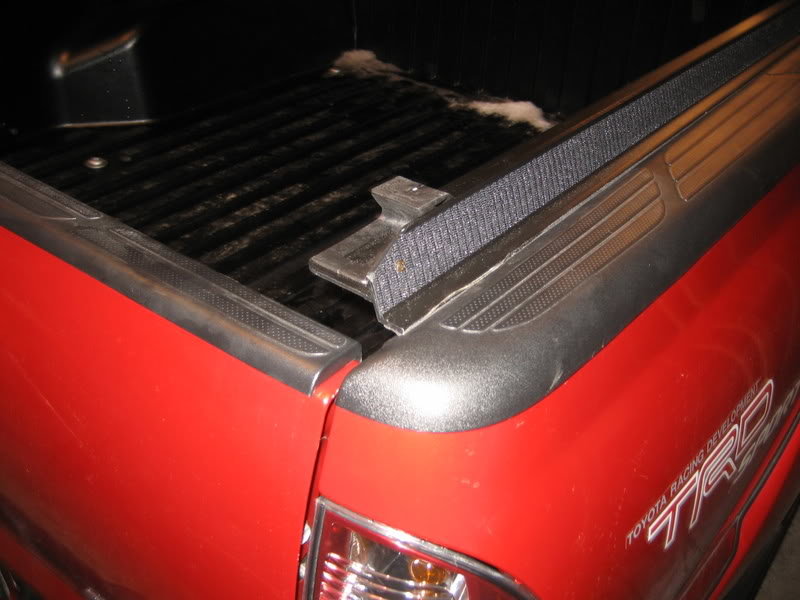

    Here is the tailgate side. Hard to tell but the cover rail simply installs BEHIND the existing cleat rail. Remove the cleat rail, match up the supplied cover rail and reinstall the cleat rail.
