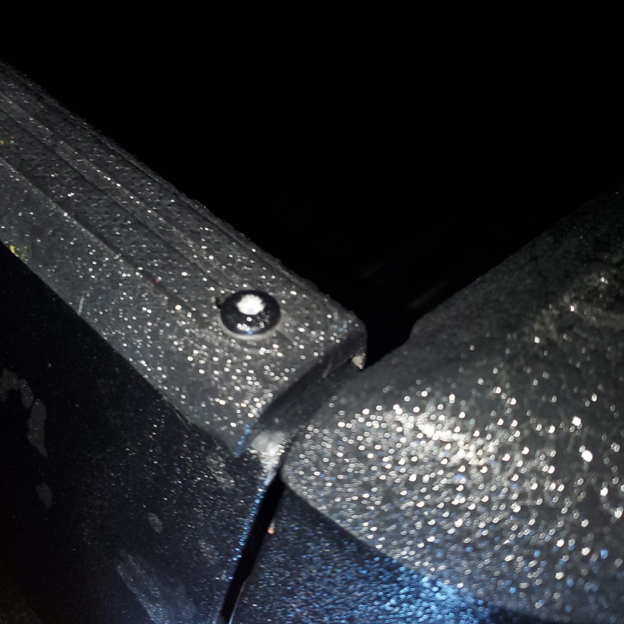

    I've read about this issue before and I plan on making a part to solve that issue. If I knew the exact distance that's between the top of the tailgate and the cover I could get started on that project. I was planning on using black Acetol Delrin plastic, using two existing screws to mount it, and it would require drilling two holes into the tailgates plastic cover that sits on top of the tailgate. This is the existing screw I'd use.

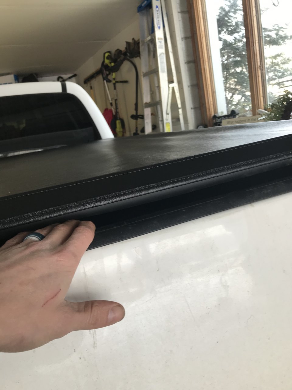

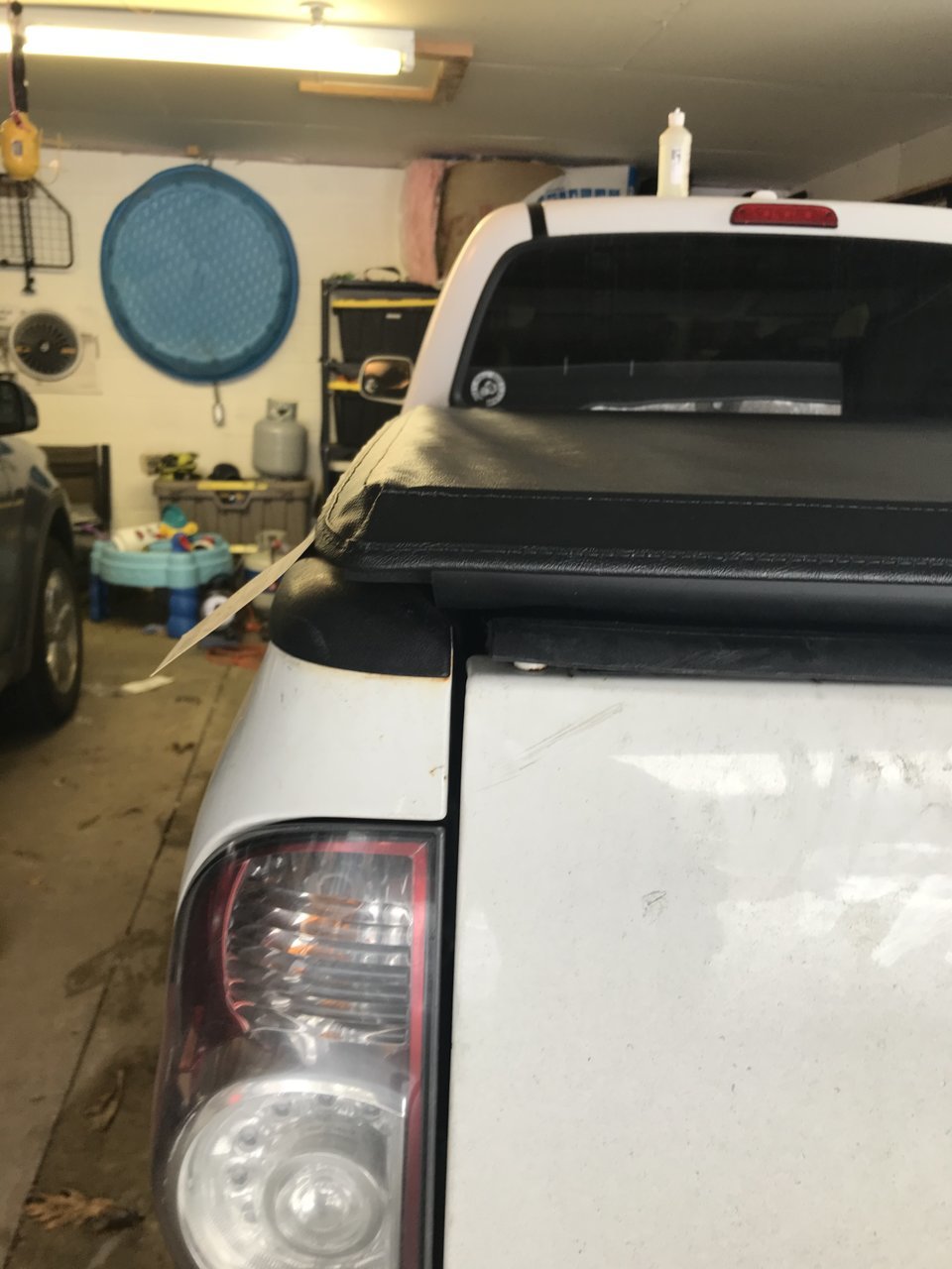

    These are the only two I took when I lost my s#it after temp install.

    Is this a Tri-fold? I had an issue with mine but I just drilled and moved the back clamps, further back. Thx

    That is no good. One of the biggest points of having a tonneau is having the bed sealed up. I can figure out the exact measurement off of my truck now that I see exactly how your tonneau sits. I've seen pictures of other tonneau covers that sat in a different position, maybe that's why no one has created a solution for it yet, because different brands don't sit at the same spot? Either way I'm on the project and if it's not for you it'll be for someone else down the road. I've got to do quite a bit of running around today and one of the places I need to visit is Ridout Plastics in Kearny Mesa (San Diego) so I'll talk with them about the project and see what material they recommend. That's the best part of living in a huge metropolitan area is having access to damn near any type of business within a half hours drive. It's going to need to be strong to stop the common thief with common thief tools, resistant to extreme cold and heat, warping from heat isn't an option, resistant to the sun from deteriating it, and lightweight to keep the closing of the tailgate easy.
    edit: In the bottom picture you posted you can see the existing screw I'd want to use to mount the new part.

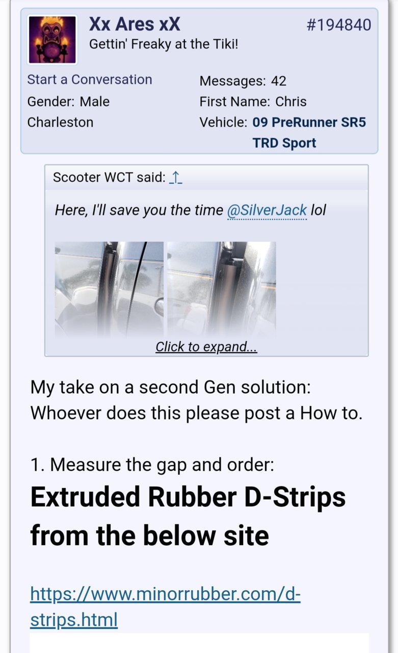

    I found it but the link looks different so I don't know if the link will work yet.20200128_071209.jpg
    https://www.minorrubber.com/d-strips.html
    I'm running late I gott get outta here

    thanks for the link. not finding a good peice tho. The gap is about two inches and cant seem to find any that tall with enough length to it as well.
