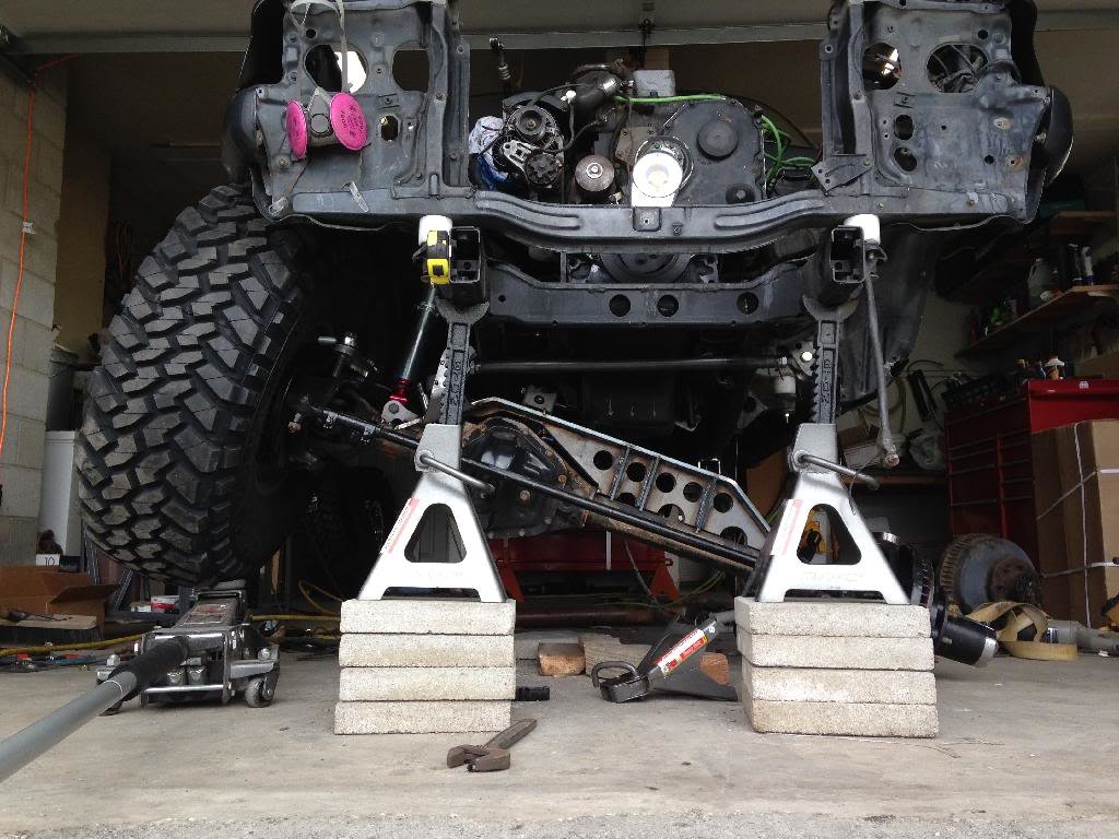

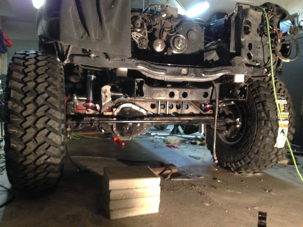

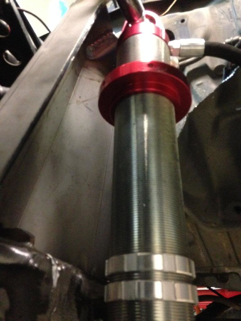

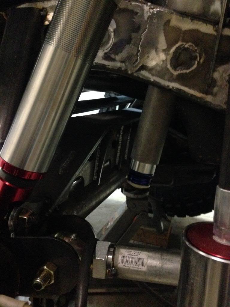

    Having trouble packaging my air bumps.
    Only place I can put bump on passenger side.
    B78BA3B1-1156-4078-8329-A8BB8997B0CF_zps_fe692061345bc9e4f5627f71c46c4b01c509ca69.jpg
    I don't think I should have any problems with it hitting during articulation. Other side could still drop an 1" but... Obviously I won't have the bump down that far in the can.

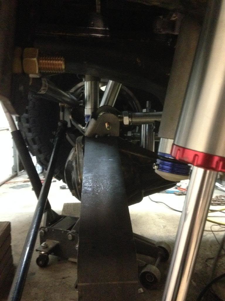

    91B970C3-BB98-40FB-923C-F02204EACD41_zps_e64c10bf64f88554d03143b53a504ab57c31dfd1.jpg

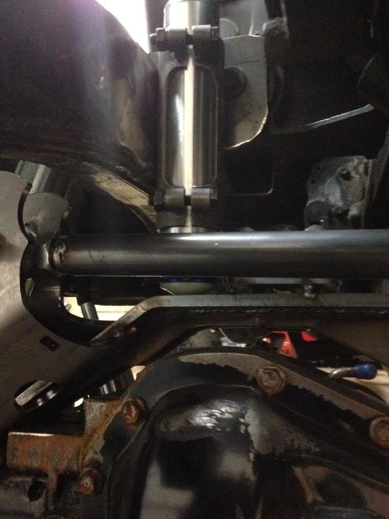

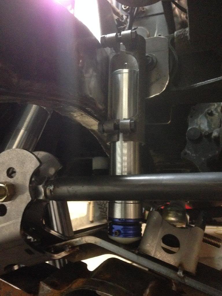

    No where to hang the driver one but here. Dunno what else to do.
    26EDBFB5-92CE-4FAF-A71C-19F0B004C720_zps_af235c12788eedd44e31c73c2a460d774252046b.jpg
    C22E9257-452A-456B-8270-D57877AA1AFF_zps_55191f777dad7af55d179794504a9a4240713413.jpg

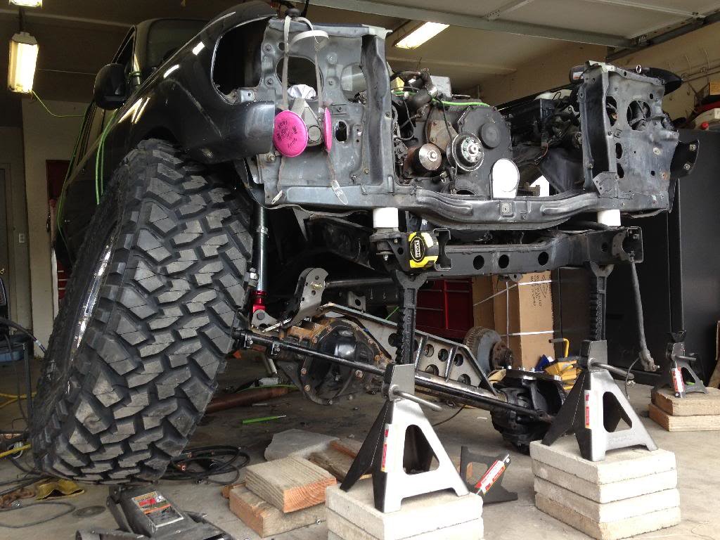

    This is my other problem.
    D5A5784F-D54B-4B62-A854-139665231729_zps_56a788fb61ccebc9e96971d76227e2c6fc8e0b3f.jpg
    Almost at full droop.
    6C79A74C-B992-4606-94D5-13A97EE42B4E_zps_284d4a3f60c8019843d236aef2830a038d87364b.jpg
    2 3/8" clearance.
    So I'm not sure if I notch the tower or if I run some borgeson joints or something crazy.

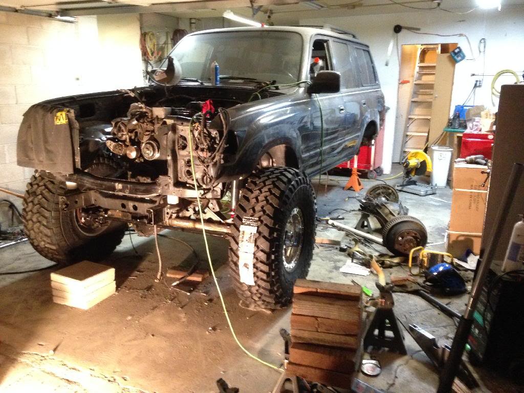

    Just for fun
    1DEFCA7E-7F00-423A-80AC-A6A2A1DAA583_zps_63f2205a3f9523a5bdd733f2421c86199011fb62.jpg
    F45DE2AB-F086-4AEE-B5D6-B187572D2A33_zps_666db00c4628135c458b1c8786fcf2622d3d0817.jpg

    I'm not sure if I do some crazy joint setup with a heim to support it or if I just notch and then box in the shock tower.
