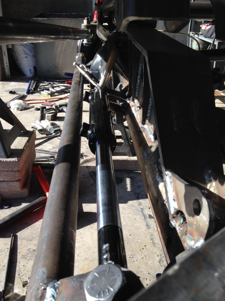

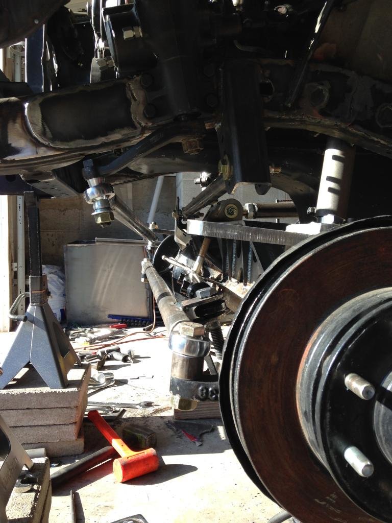

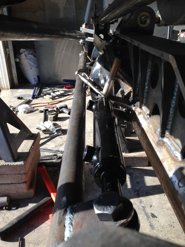

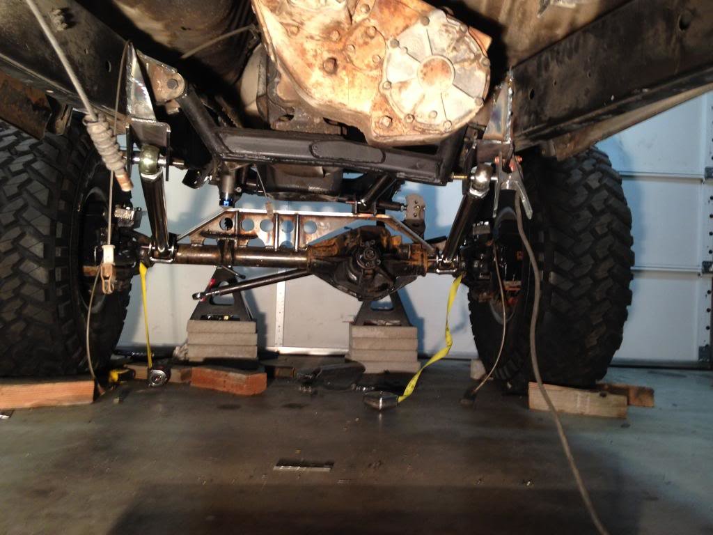

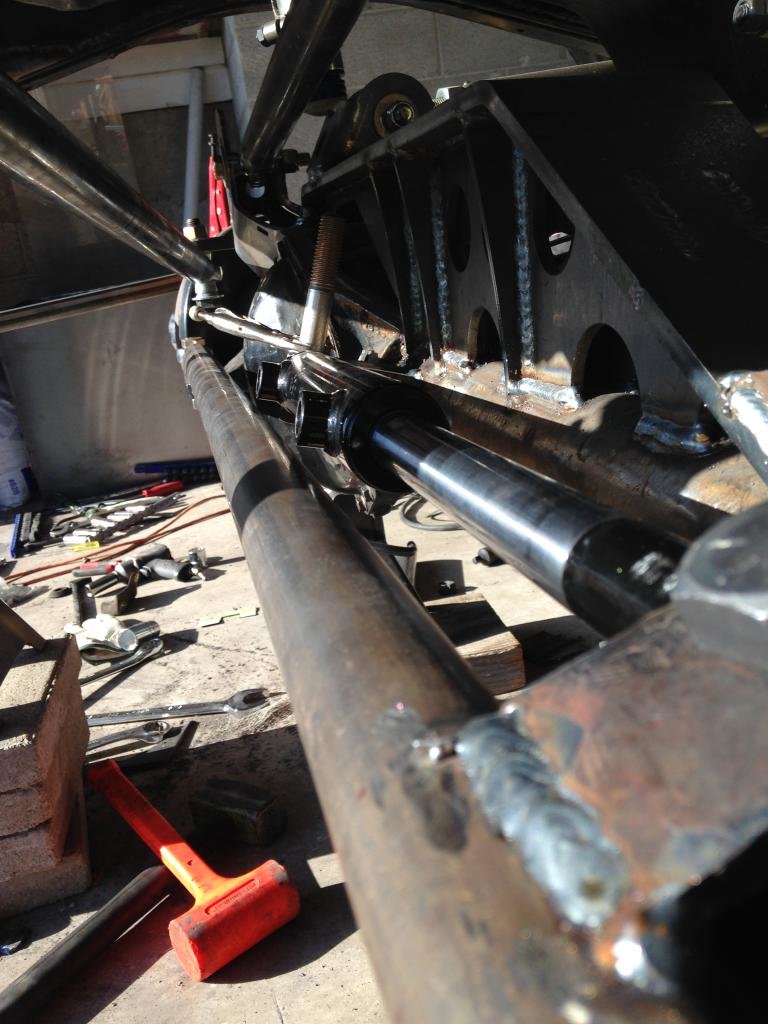

    I noticed in the pics where I just set the ram up there I had it pushing on the center of the tie rod. Guess it's ideal to have it closer to the rod end, less easy to bend shit that I way I suppose... so that got flipped around.
    Then I set toe...
    Unfortunately I drilled my stock knuckles out with a 3/4 bit and theres a tiny bit of play in the hole with a 3/4 bolt. So... idk... fuck it. Hopefully it'll stay true if I tighten the hell out of the bolts.
    I also used a 1" spacer to get the tie rod a bit higher. Just some DOM... 1.25 .25 wall
    Fed Ex lost my coilovers... profender is working on that one... :homer:
    Ram is a 1.5x8x1 swivel eye surplus center ram, 8" stroke seems to be almost perfect. Ram maxes out on both sides just before it hits the stops on the knuckles.
    Hope it all goes swimmingly.
    Lot's of grade 8 5/8 and 3/4 bolts. :cool:
    I also got the clutch mount and pedal done, just need to swap out master and slave and mount it all up. :D

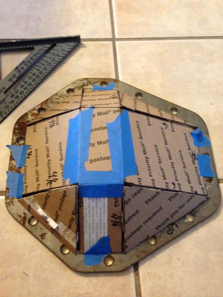

    Eric cut me out some rings for diff covers... not sure what I'm gonna do with the 60 yet. May just bolt the ring around the cover and then weld some plate to make a frankenstein cover. Looks like it might be a PITDick to make one from scratch.
