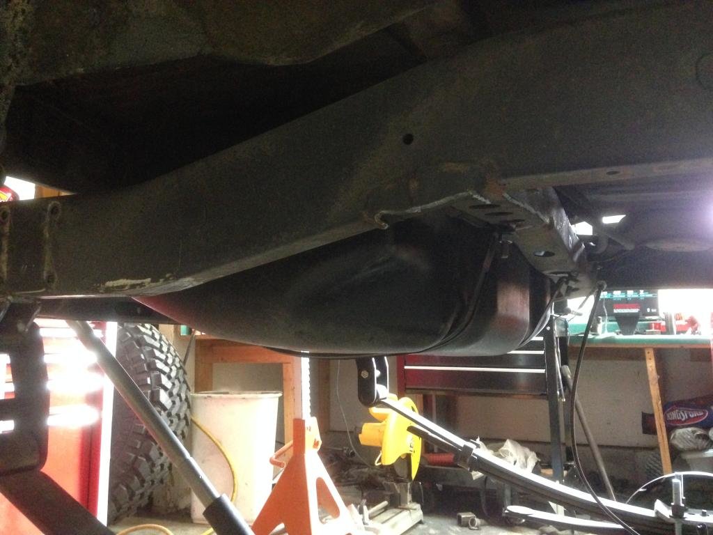

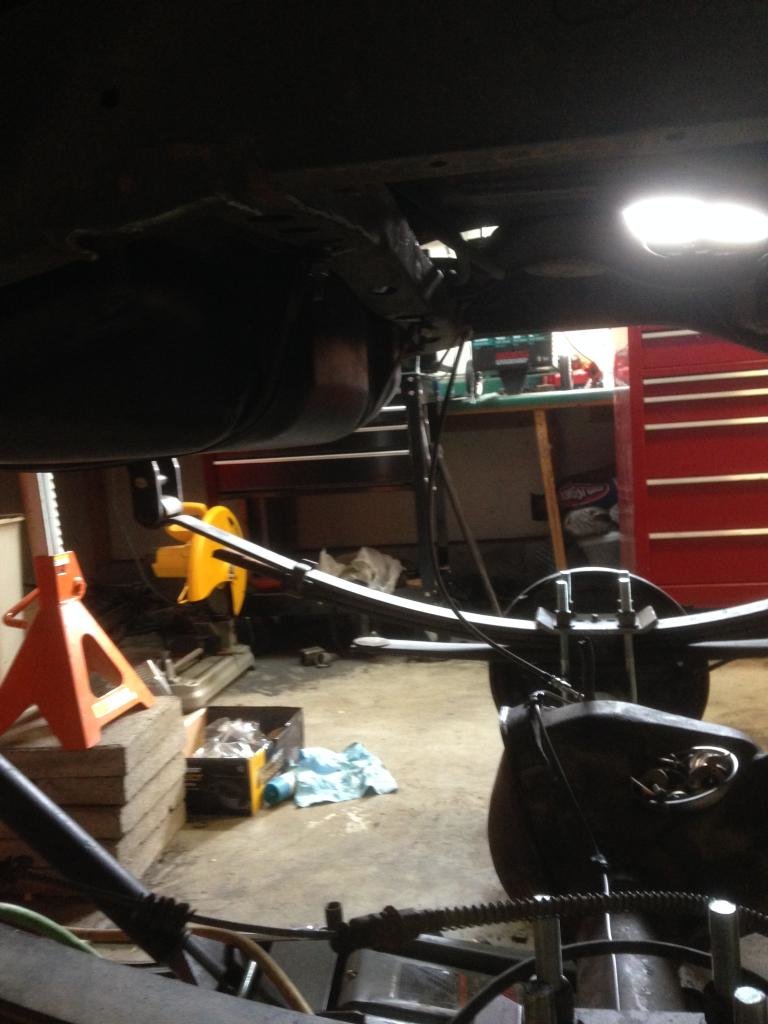

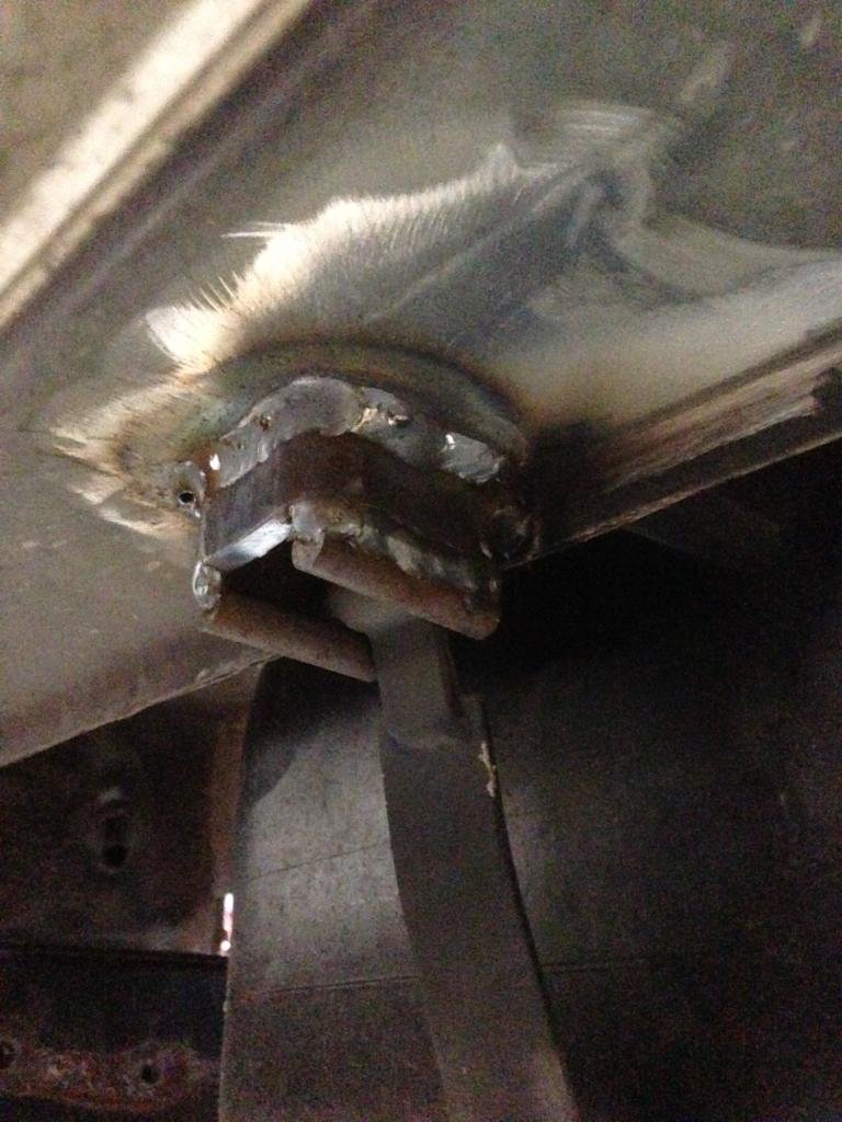

    Rear mounts for my fuel tank strap, taken from a cherokee of some kind and modified to accept the toyota sender and pickup which I also modified by removing the pump and extending the pickup tube to the bottom of the tank
    48C291EC-73CE-4D43-9AD9-738D8674E957_zps_7d65c7d937b8242c5b7c4b14357234dc9fbdae51.jpg
    Here's the tank, welded some bolts to the frame, pretty bad ass mount if I do say so myself.
    7294D597-C332-445D-976B-F883873893F5_zps_72101645c6156500cc0c8bc3ec1167eaba81d895.jpg

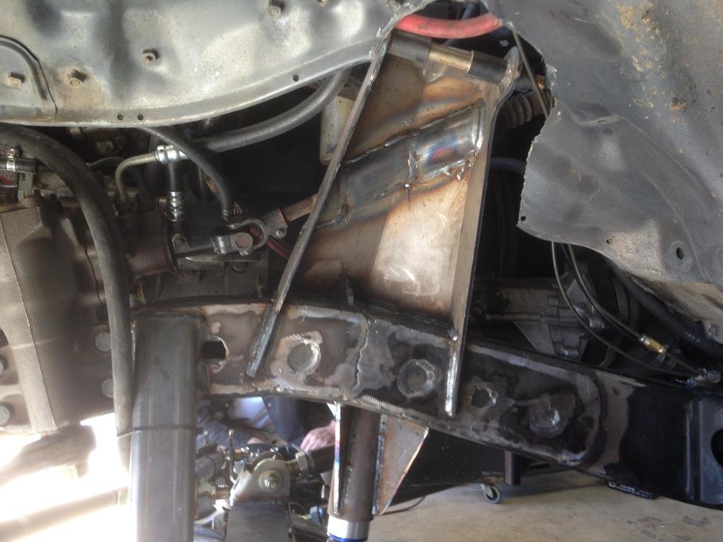

    Had to swap the flange/yoke around, decided to run a Neapco 1350 CV in the rear to 1350 single joint at the 14 bolt and a 1410 to 1350 single joint single joint shaft in the front. Need to order a dana 60 1350 yoke as right now it's 1310 pussy shit. Driveline services of Carson City is building them and bringing up to me. Woo.
    95758C45-19ED-43F7-8F7E-2721A4784B6B_zps_4313f8148540c41de3d1c3965a2524738aff623b.jpg
    F789423F-E034-4498-972C-62F114B716B9_zps_cc299a0e8402a1b2b402e938f4b1d4c9a957f975.jpg

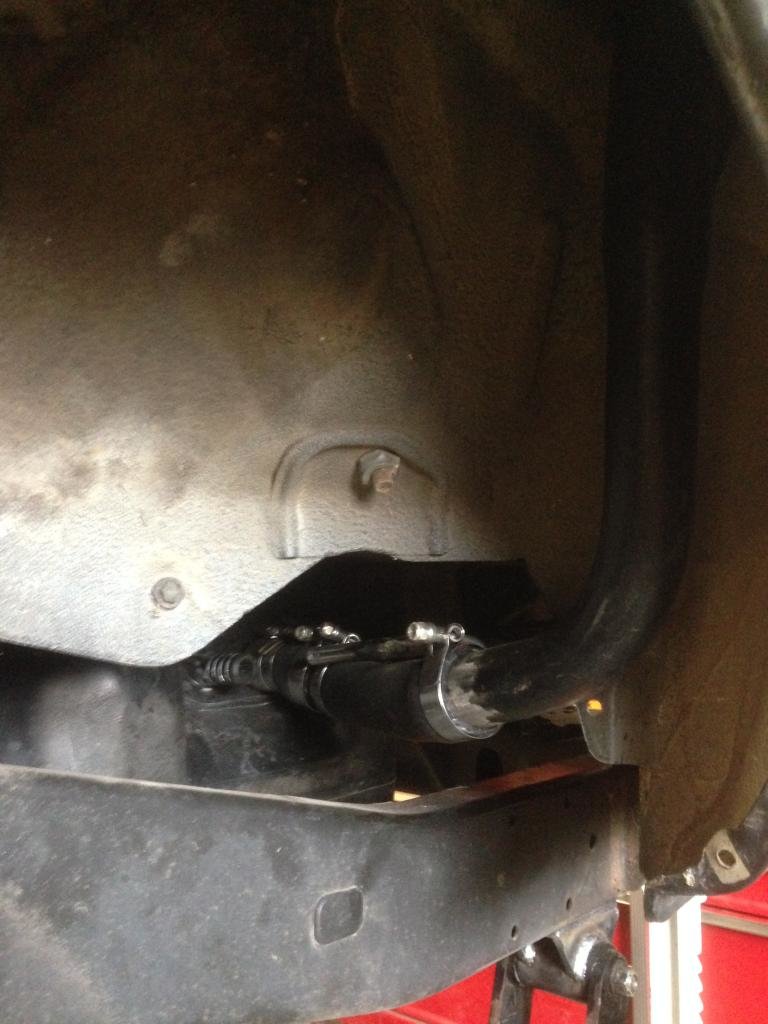

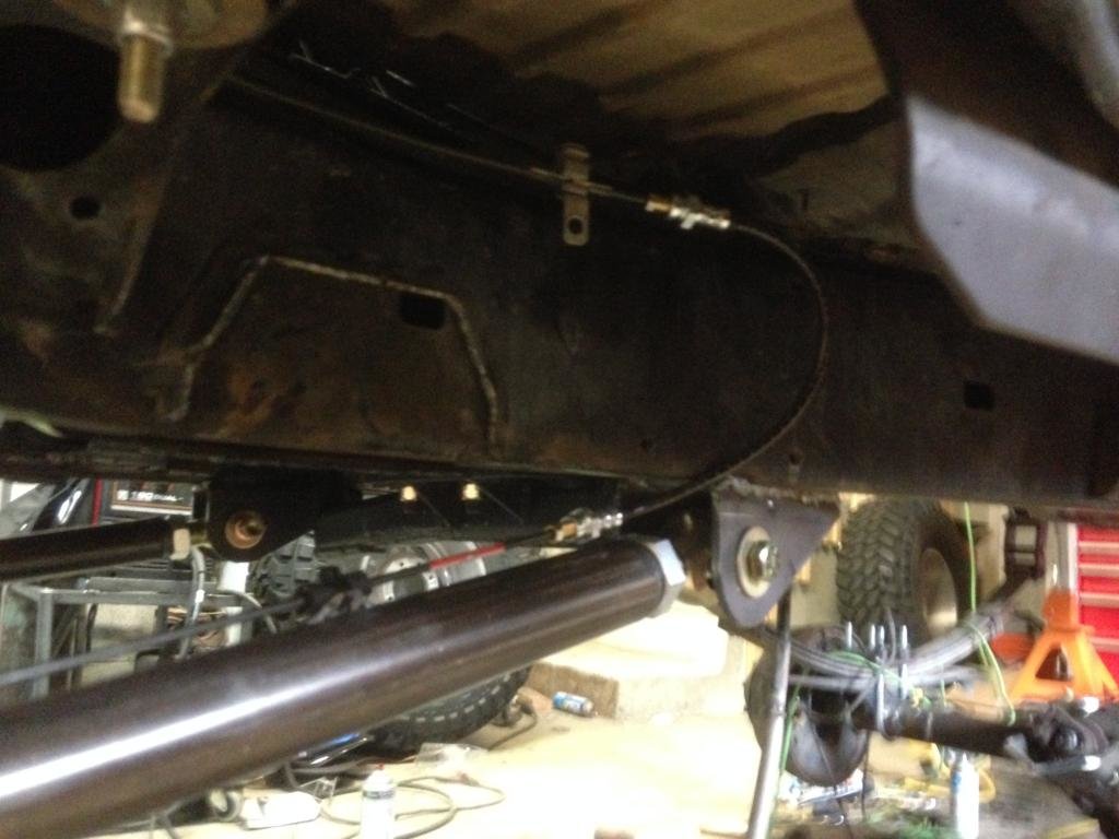

    Did some brakes on the 14 bolt, still need to find a way to hook up ebrake cables.
    33840E85-E950-4A98-8F6F-E2E847CA4107_zps_98dfe90b03f9c8f2e5516dfd99fcfb08f5e71c04.jpg
    Everythings welded now, I think.
    505C77E1-B269-4E8C-93C0-F1FB1D981C51_zps_506a4cd887f6b9898e841d7c722d0d5359f54ac5.jpg

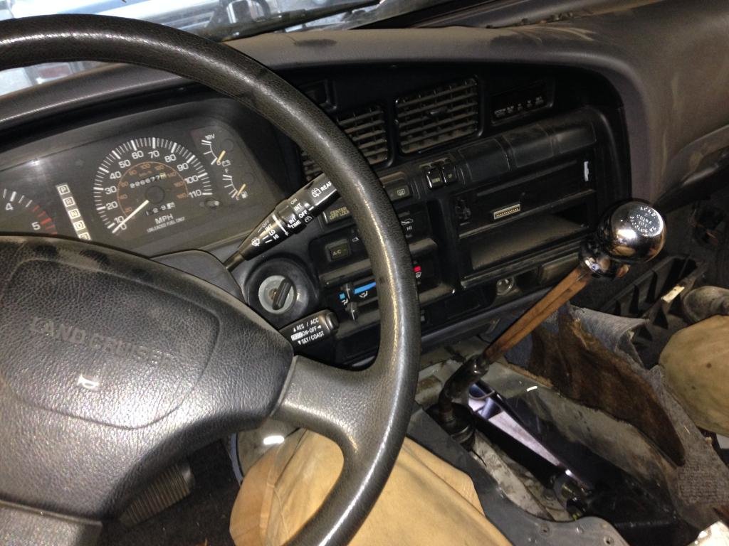

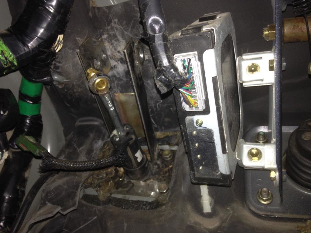

    Cut a hole in the floor for the shifter.
    D67DF6DF-9180-4A61-A505-33A14A40034E_zps_38510977d66b4b08f69191228d589832e9dd9008.jpg

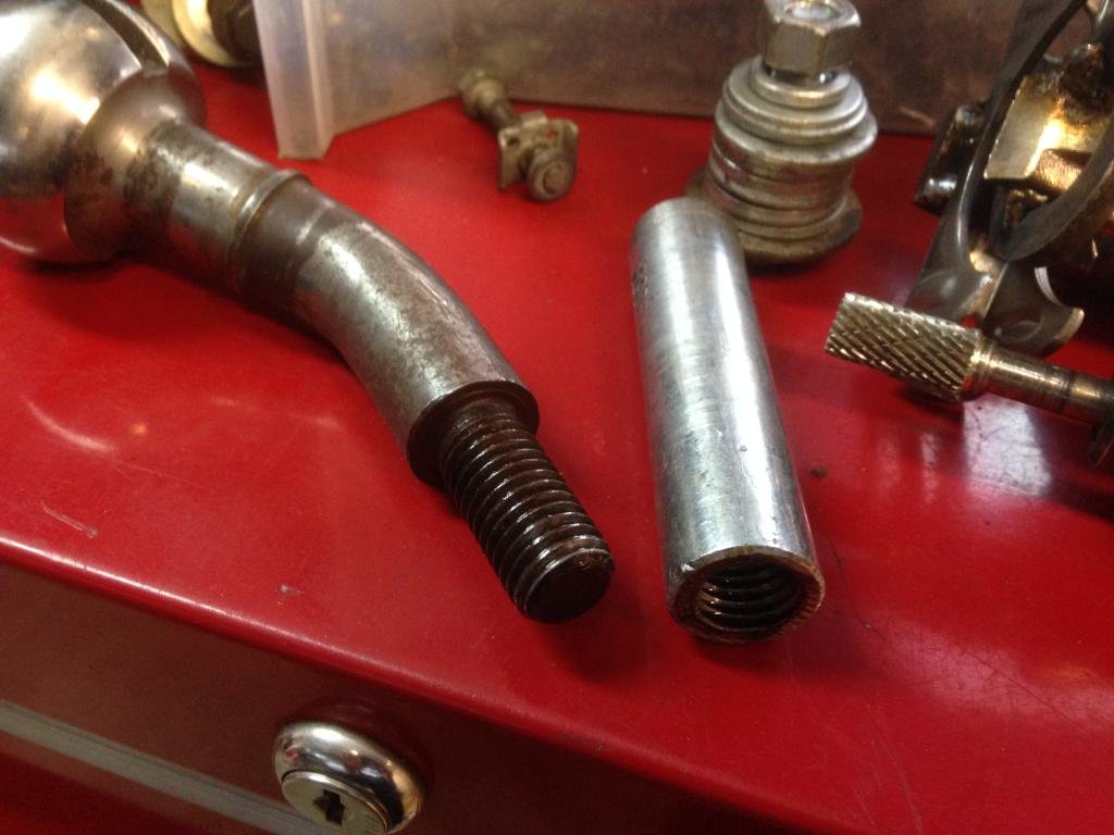

    My buddy turned this down for me and tapped it for a m14x2.0 which is what the shifter stub is, since I can't find a shifter anywhere for this Getrag. Make my own with pipe...

    Ghetto clutch pedal mount and pedal
    78B26C9A-EC44-4BD2-AC99-CDC63A3859E7_zps_c89ea2f3645865895e162ed0f49ec5405d33fade.jpg

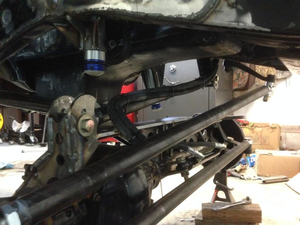

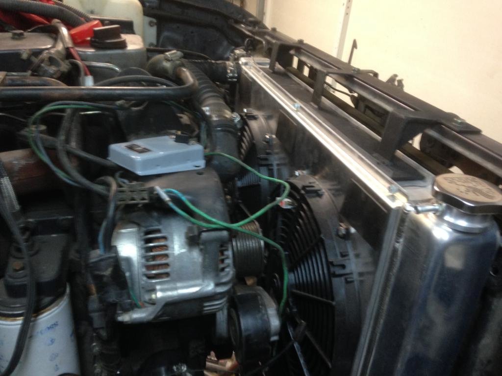

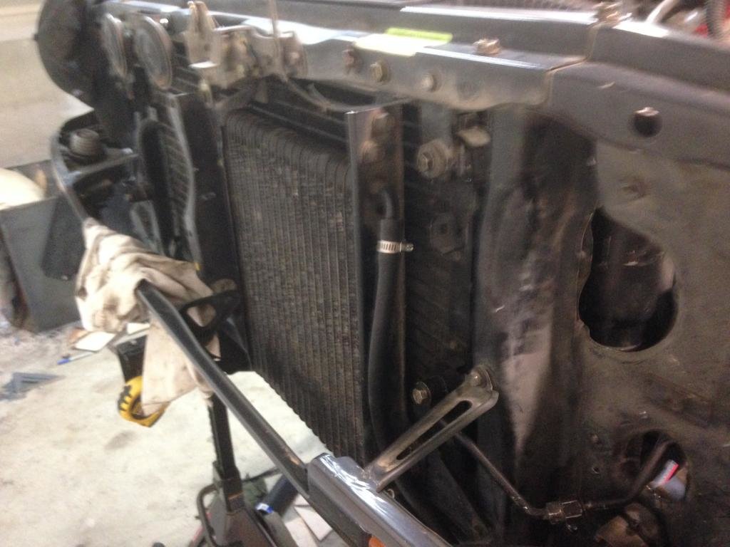

    Bump can mounts welded, brake lines in, hydro assist lines in, AC lines done, radiator plumbed and mounted, powersteering cooler -- formerly radiator cooler -- plumbed in

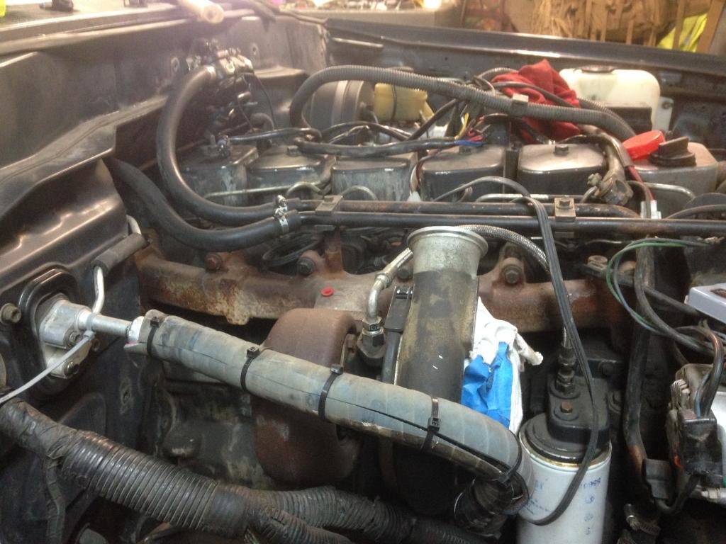

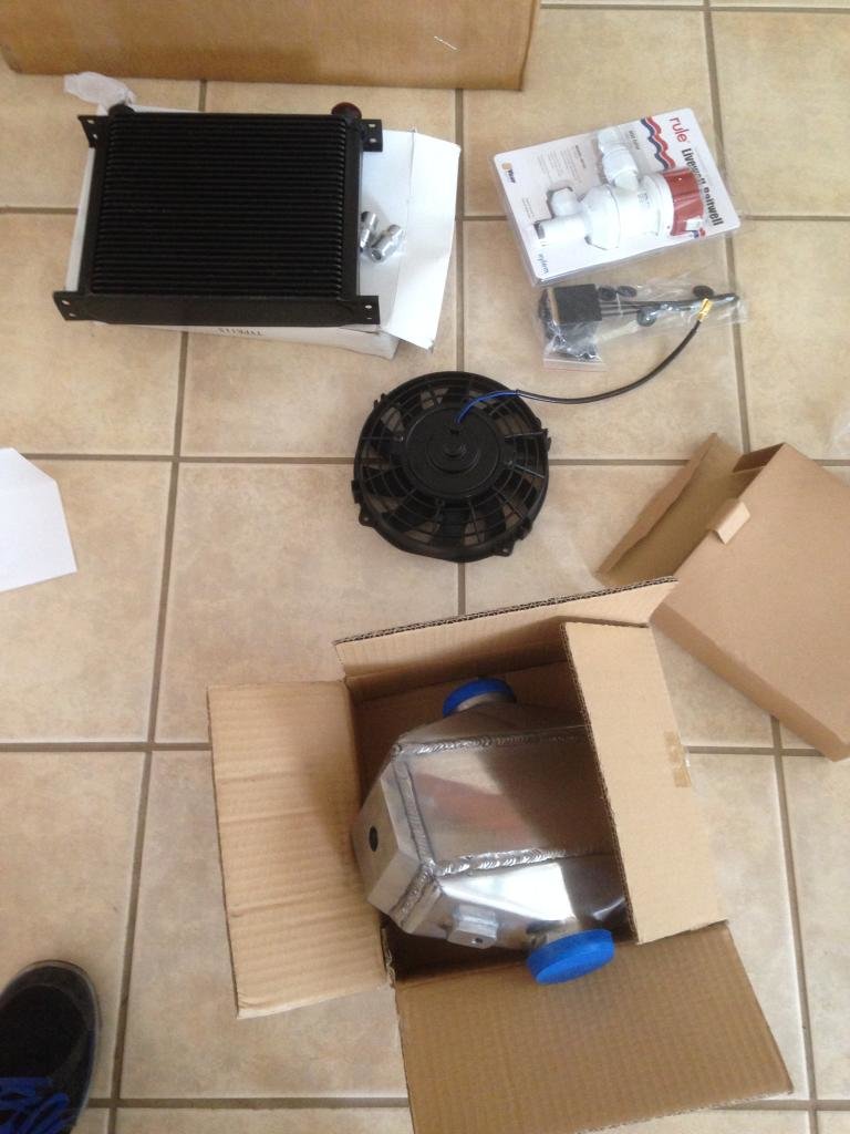

    Livewell pump, radiator. Looks like a air to water intercooler setup.
    From Frozenboost?

    Yep, www.frozenboost.com 350 HP kit
