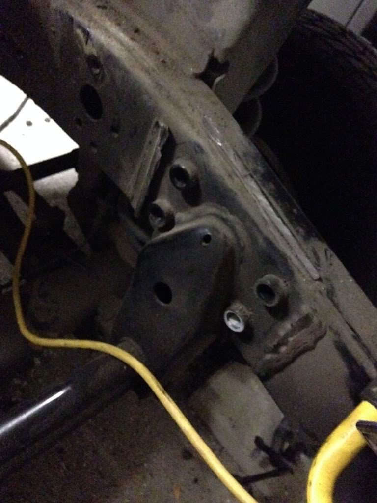

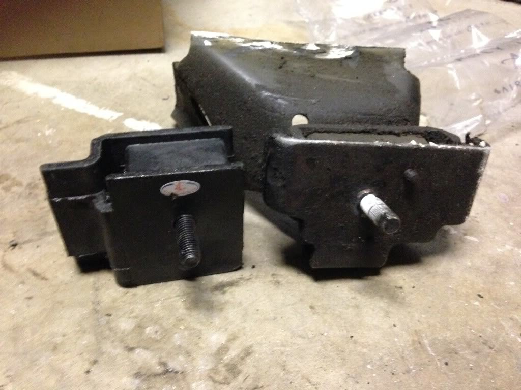

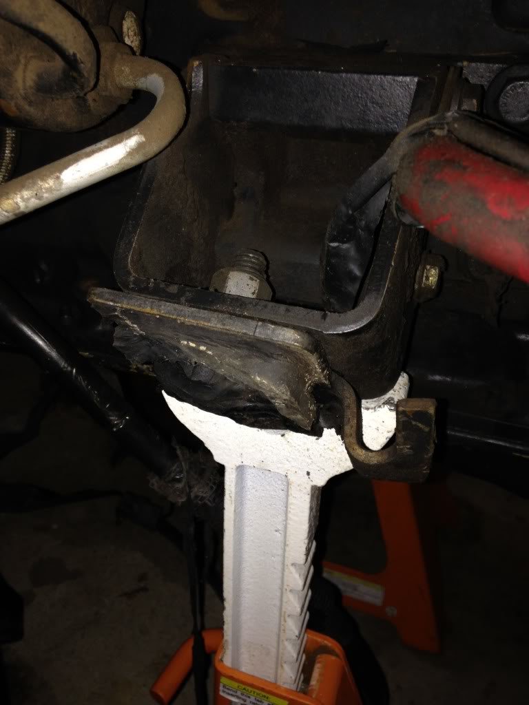

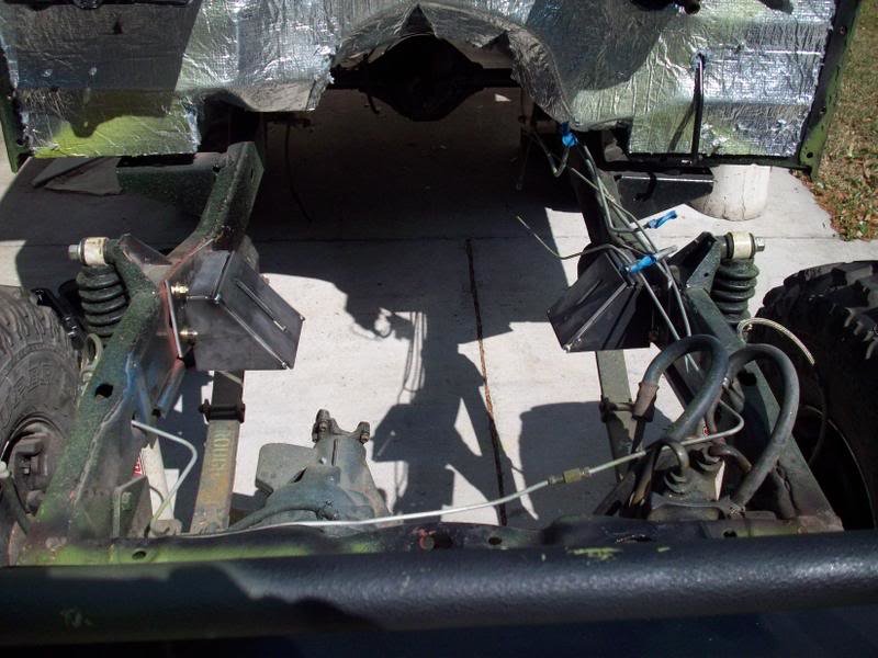

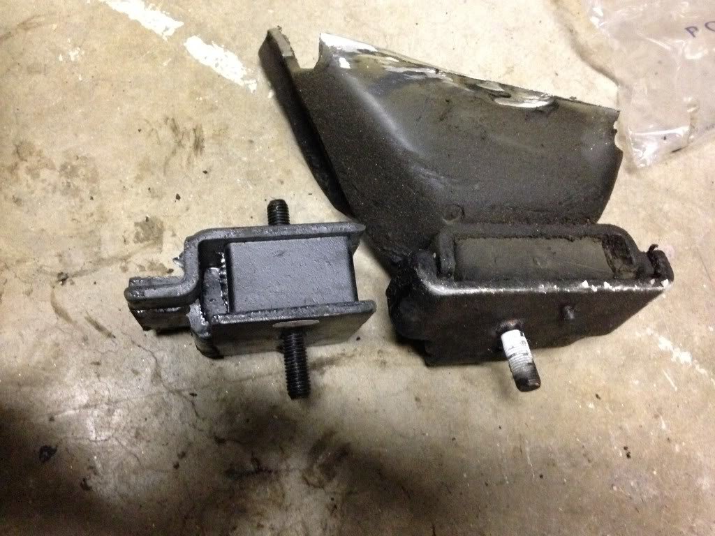

    So Eric (Relentless) is going to cut me a couple different plates to use as the top of my frame side motor mount. Hopefully I can make something work.
    Basically just a plate with a slot.
    Like this but hopefully cleaner.
    non-eventful but I need something to look forward to
