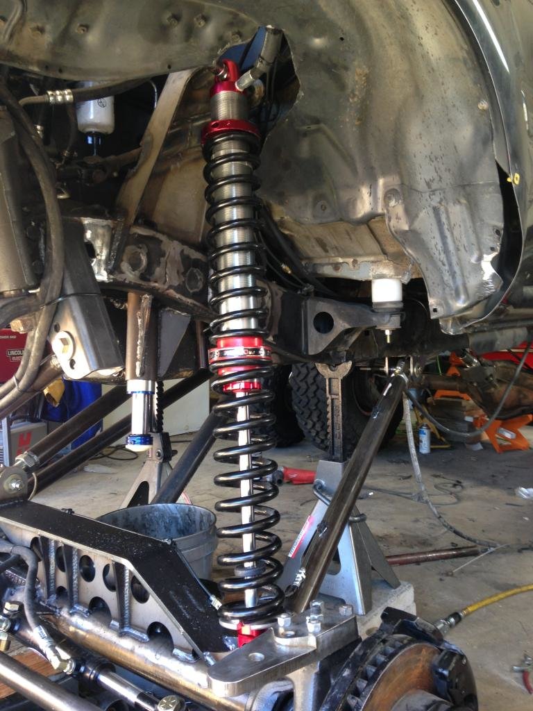

    So my spring rates are ridiculous, gotta send em back and get something... proper. That's about all I've been working on. NVWiggins came over and checked it out for a little bit last night. Got to see his 5.0 runner. Pretty sweet.

    Ridiculous as in high or low? What rates are you at?
  10. Oct 27, 2014 at 11:42 PM
    #390
    92LandCruiser
    92LandCruiser [OP] Well-Known Member
    Feb 20, 2010
    #31761
    8,324
    Nevada
    80 series Land Cruiser
    Cummins, tons, 40s
    204#/in rate
    aka 350/500 springs, aka almost 9" of up travel -- ridiculously high
    Going to about a 225/350 or a 137#/in rate
    Looking at 1100 lbs per corner and add in a little extra so hopefully this go round is a little better. Should work out, the math does.
    1233 lbs per corner with 5" of up travel and right now without skids or armor or winch or dual batteries or whatever I'm at around 1100 so, I think it should run nice.
    Now valving... whatever the fuck is in there I guess I'm running. Went with 150 psi nitrogen ?!?!?! BEYOND ME

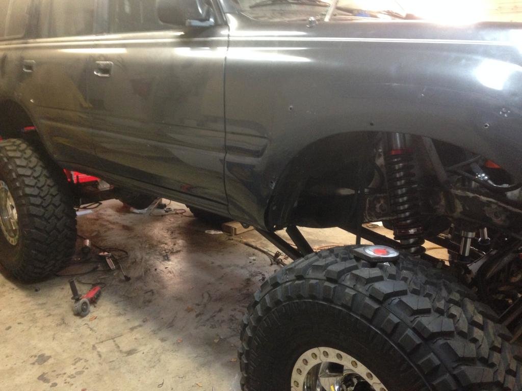

    Ooo pictures...
    DDE0BCB7-6587-486E-8B86-9E17E5E84731_zps_2a717675f1b27ad4662078e80d955042fc93e00f.jpg
    Chyeah brah
    Brapbrap brap
    0A5F5E22-A5F8-4A0F-8A65-1EF5D4ADFBF1_zps_4d0af80e94fce2cec750b838cabd285bdc08b167.jpg

    I like this.
    Why is there no like button.
