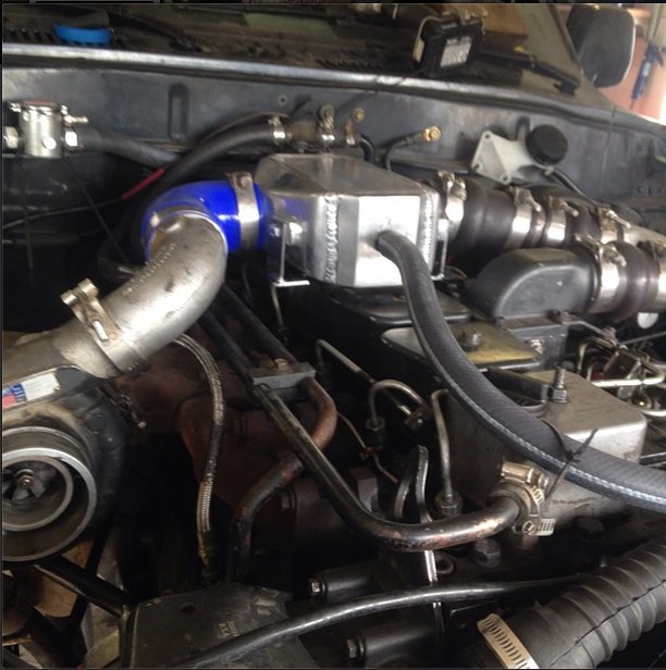

    Got a little done today. Hard mounted my intercooler. It even clears the hood. And then worked on plumbing it.
