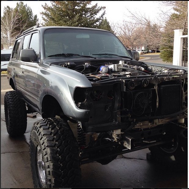

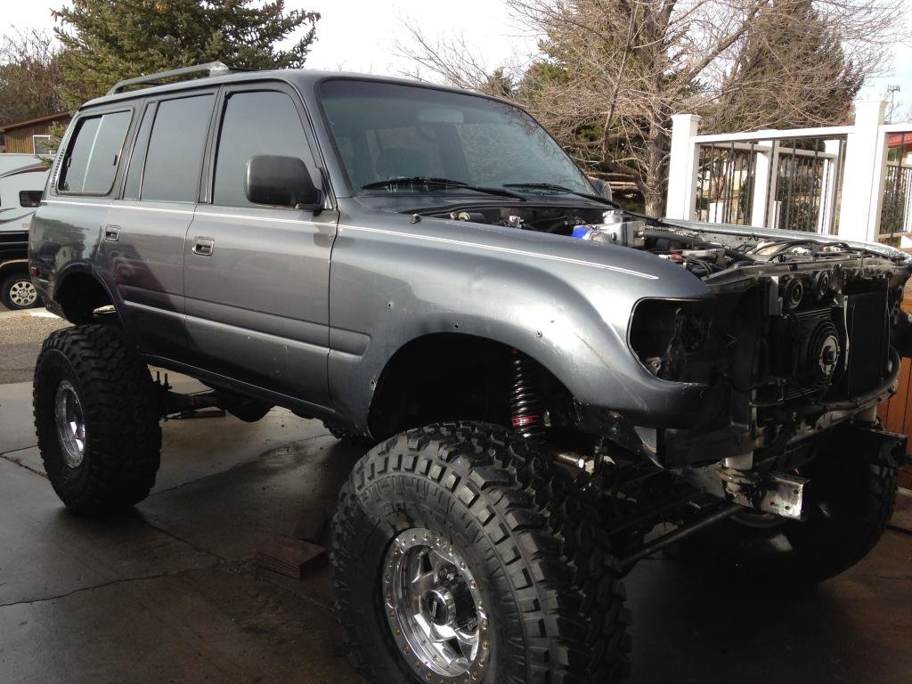

  15. Dec 7, 2014 at 7:30 PM
    #475
    92LandCruiser
    92LandCruiser [OP] Well-Known Member
    Feb 20, 2010
    #31761
    8,324
    Nevada
    80 series Land Cruiser
    Cummins, tons, 40s
  16. Dec 7, 2014 at 8:14 PM
    #476
    avw4x4
    avw4x4 Well-Hung Member
    Oct 20, 2013
    #114886
    2,414
    (M)Andrew
    Rochester, NY
    2003 Yota
    ...loading....
    :drool:
    It's a monster man!

  18. Dec 7, 2014 at 10:42 PM
    #478
    92LandCruiser
    Feb 20, 2010
    #31761
    8,324
    Nevada
    Cummins, tons, 40s
    It certainly is! :p
    I haven't even really played with fuel yet but the torque lean/roll is wicked already. Gonna need rear shocks and an anti wrap bar stat.
