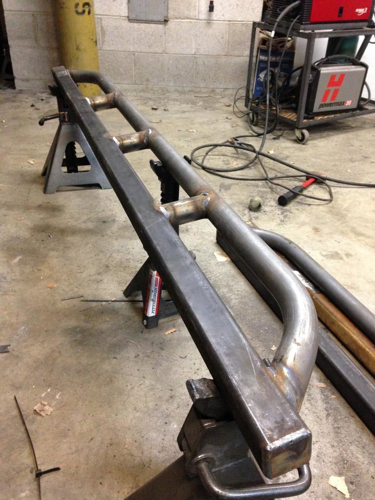

    DIY hybrid sliders from Relentless
    .188 2x2, .120 DOM outer
    B9F30FCE-3ED4-4FC8-AEFE-5EE469A2F8A6_zps_1b420c2a1fc9ca51737d0493df8b6e681b15f666.jpg
    641323A6-0020-4700-A084-138E305B3945_zps_415040df271bbb647712cef12a7122a2dc283800.jpg

    Invisible ramp. :thumbsup:
