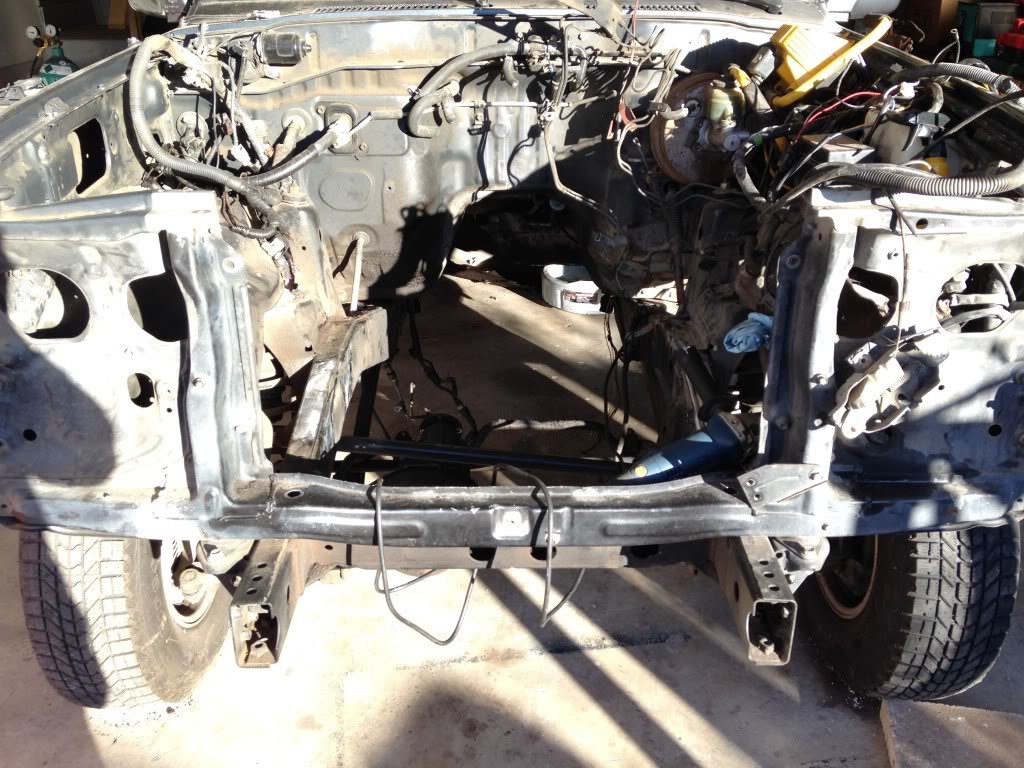

    Deleted rear heater, removed a bunch of crap, removed mounts. Now back to work.
