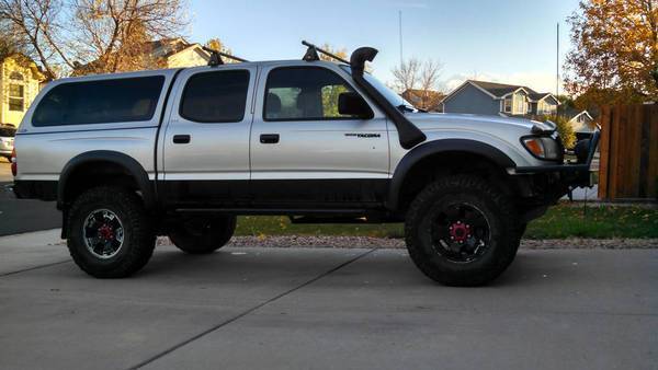

    on another note........ topper went back on today

    Your truck looks good with the canopy on it. I am about to do that too.

    thanks, the topper is really nice to have for winter.
