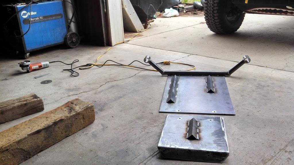

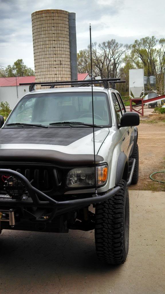

    Joey, i would extend the front of that support down the frame if u get a chance. the whole point in those is to support that bend in the frame, thats where the frame will bend..... yours right now just kinda made the frame twice as thick

    It is. It just looks funny in the picture. Goes all the way to the bed mount

    finished up the trans/belly skids today just need paint
    installed the cb a couple days ago too

    thanks man. these were a piece of cake compared to the ifs skid :eek:
    the cb mount is just a piece of scrap i had that i cut and ground into a tirangle-ish, and welded to the bumper. no fab skill required. just make sure its level.

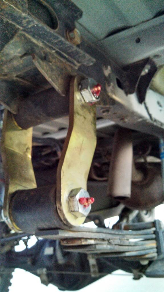

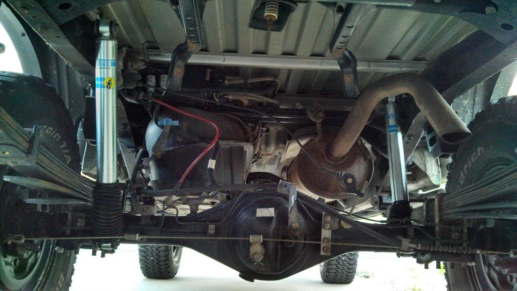

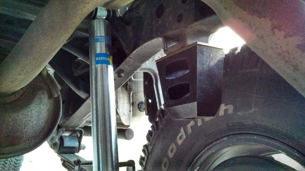

    A bumper here, some tires there..... you know, stuff.
    got some work done on the truck today
    5125's installed thanks to some grease and a BFH :D
    energy suspension bump stops
    greaseable bolts for the shackles

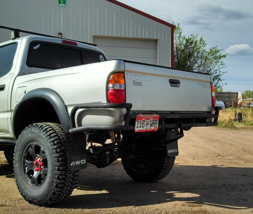

    trail gear rear bumper is on!.......finally
    still need to wire the license light but ill do that tomorrow

    Wow Joe, your truck is looking super tough! That rear goes well with the rest of your mods. I wish I had that much clearance in the rear. Can't wait for Moab. I hope we end up running a few together, but I haven't seen our names on any common lists yet :(

    thanks man. slice and dice and you can have that clearance!
