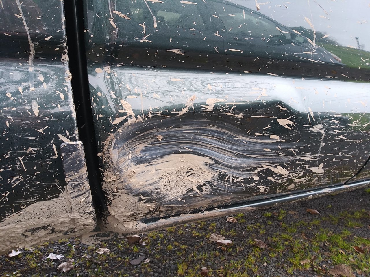

    Yeah, oopsie, you can say that again, Good day for wheeling, Bad day for my truck !!20211024_125919.jpg

    :itllbuffout:
    You might be able to get that pulled and sanded methinks

    That’s what I did when I rubbed on a tree at Mettowee in the same spot. I took a plunger to the door and pulled 80% of the dent out, then took the door card off and using some foam blocks pushed it back to 95%. I sprayed the bottom half of the door with a duplicolor touch up rattle can and nobody noticed when I traded it in on a rainy day (not that they look that hard at a 200k truck). It was a 20’ repair.
