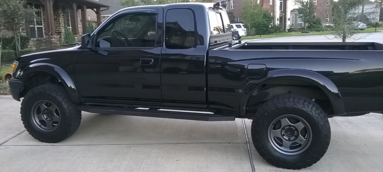

    Did it to my 2004, decals, emblems and all. No problems after 14 years on a black truck at that.
    Used fishing line for the emblems, old credit card for the decals. Grabbed some Remington Oil (WD 40 will work too) to loosen the decals, old credit card to scrape and an old rag to clean up. Afterwards, used Armor All detail spray with a clean cloth. BINGO!! There is a YouTube video with this little trick floating about, wont scratch your paint either.
    Post pics when you're done!
