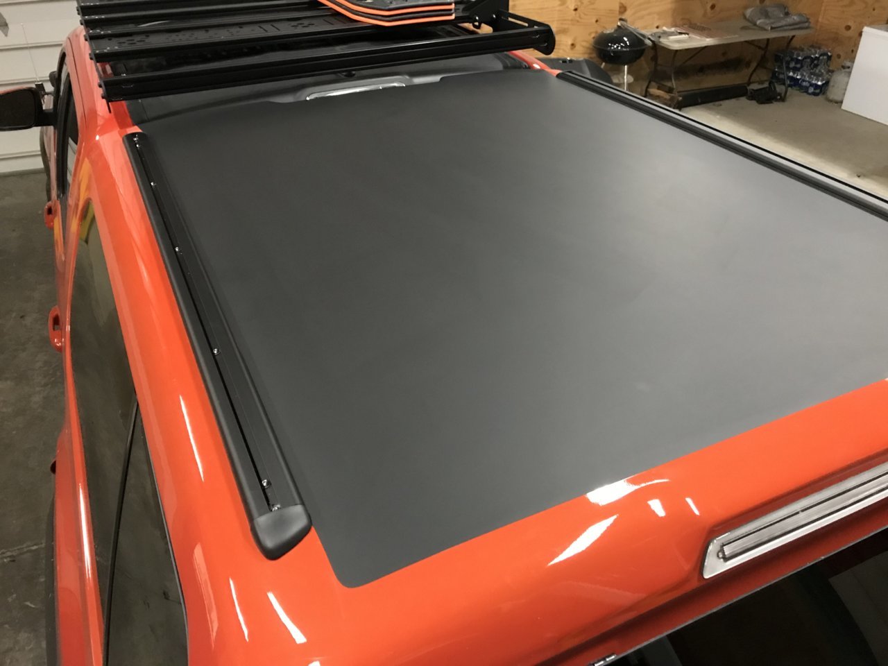

    Today I had my local vinyl shop match the top of the camper shell to what I had my roof done as. Turned out fairly good imo!
    Brought it back to my shop and put the feet on my Prinsu for the shell and ran into a slight issue. The tracks on the shell are wider apart than what the feet on the Prinsu go. I gave @CBI Offroad Fab a call and spoke with Nathan and they are working on a bracket solution.

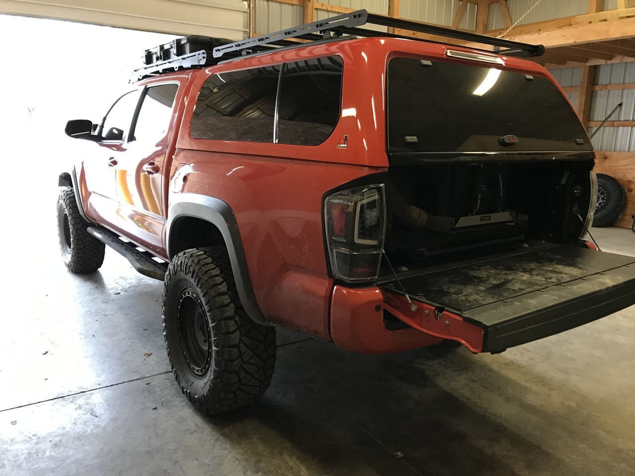

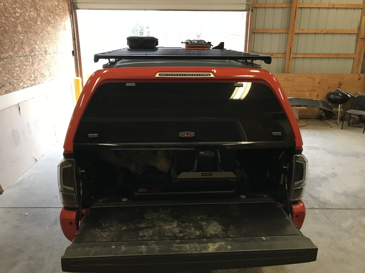

    So I went ahead and put the rack on top today just to see how bad off the brackets are. 1” to 1 1/2” too narrow for my factory Leer rails.
    I called @CBI Offroad Fab 3 times today and had no luck with getting anyone to respond. Hopefully this gets sorted out fairly quick. I ditched my last TMT rack because they didn’t make one to match a camper shell. Dropped $1800 on Prinsu’s and accessories and another $2k plus for the shell and the Prinsu doesn’t fit.

    Thanks, it’s a new 100XL. Prinsu website says it works with Leers. I called Friday and spoke with Nathan and gave measurements. Hopefully the figure something out soon. Puts a damper on the holiday camping plans.

    Whoever installed the tracks on your roof put them really far apart. Not sure their reasoning for that but that’s your issue right there. You could take it up with the place you bought the cap from but the only fix would be a new one and properly spaced tracks.

    do you know if tracks were installed by leer or at dealer?
  12. Dec 13, 2018 at 8:06 AM
    #72
    jrodyoung80
    jrodyoung80 [OP] MOBTOWN OFFROAD AMBASSADOR
    Nov 22, 2017
    #236623
    84
    Jerrod
    2017 Toyota Tacoma TRD Off-Road
    Total Chaos +2" LT - Radflo 2.5's - 14" Radflo with AG HH - Deaver Stage III's - OVTUNED - 35's - 5.29's Mobtown Offroad Fully Armored - Baja Designs Lighting - Snorkel - Sy-Klone - Prinsu racks Smittybuilt Winch - GOAT TRUCK ARMOR - ECGS Bushing - Bedslide - DOMETIC 50 TEPUI TENT - Tepui Awnings - Mountain Hatch Gate Board - I'll stop now
    Tried that. Factory installed tracks. They are all the same now.

    Try reaching out to Rocky Mtn Racks, they use the same extrusion and have a 'Z' shaped foot that would surely work

    I ordered some from the link above. Should work. Just disappointed that I have to do that and get the run around from Prinsu at the same time.
