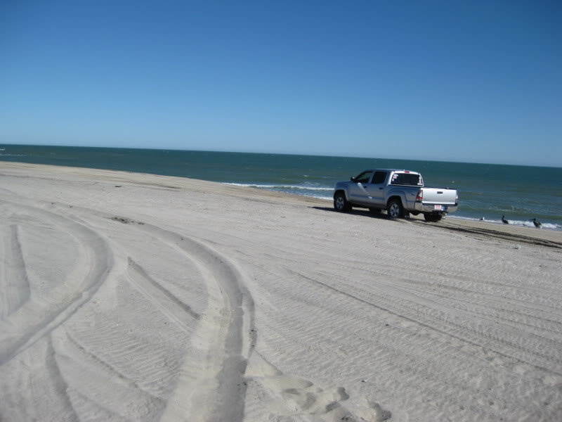

    For deep sand, H4 (TRAC on) worked great... no air pressure drop needed in the tires either.

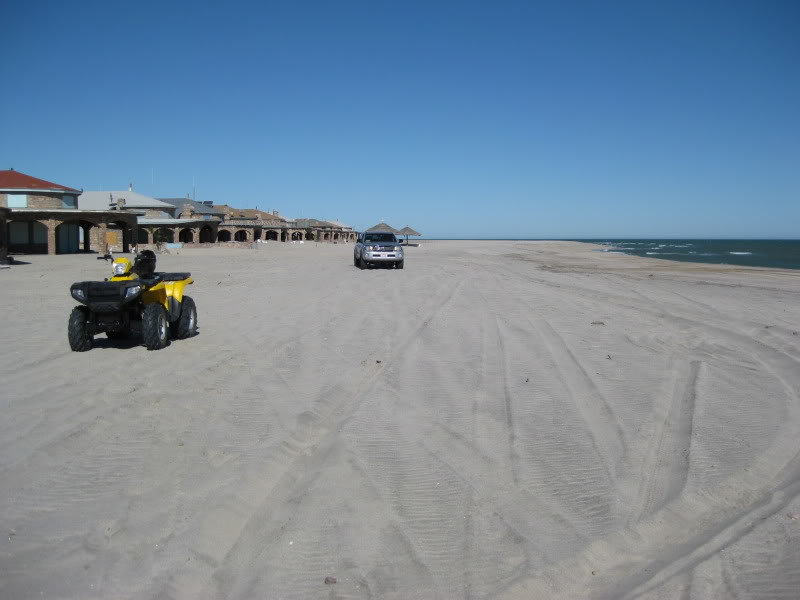

    VSC OFF:
    Perhaps if you are talking about running arroyos at speed, like Matomi? I say that because with TRAC (and VSC ) on, the buzzer goes off a lot and gets annoying as you squirrel around in the sandy dry washes!
    Happened as we were having fun exploring south of the sulfur mine.
    However, while driving around on the beach (with TRAC on), no buzzers... maybe because it was driving so easily, where-as in the arroyos I was puting my foot into it to keep moving (with tires fully inflated).
