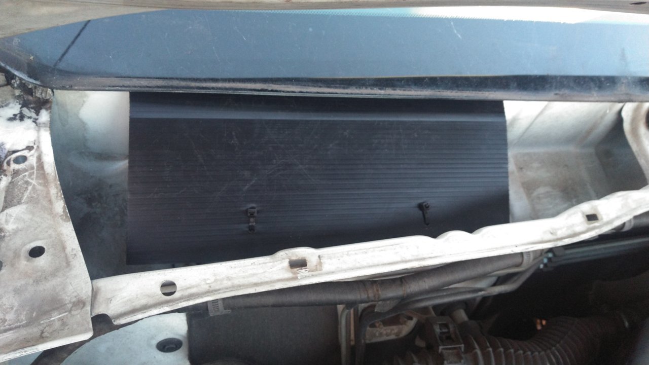

    But in the last week, coming into the truck every morning, there is an excessive amount of moistness. the windows are fogged up to the point of almost beading. The truck does not normally have this much moisture and neither does my camry or corolla.
    the strange part is, I checked for leaks in the windshield, windows, back window, there are no visible leaks, no water flowing down from up top. I even sat in the truck when a rainstorm started and watched for leaks. no water collecting behind the back seat, no obvious leak spots in the headboard.
    It almost appears that someone is boiling a pot of water in my truck like a wet sauna.
    I will have to take the doors apart and see if water is collecting in there.
    Maybe it is collecting in the air handler intake?
    Anybody else encounter this?

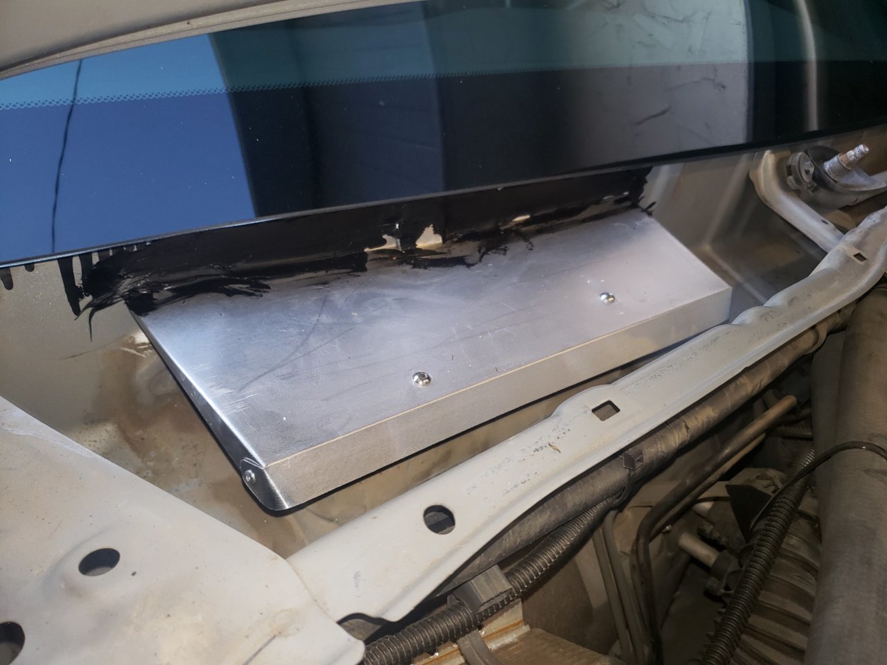

    Leaks are a normal part of car ownership, and can be frustrating to solve.

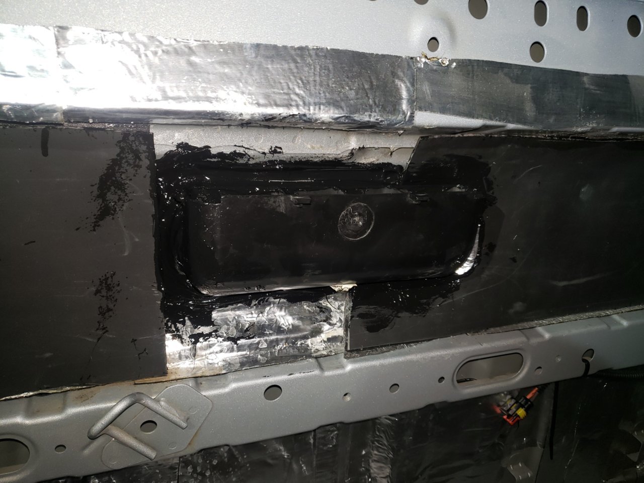

    On my Tacoma, the most recent leak I fixed was from the rear cab vent. I discovered it when changing the cab mount bushings -- the rear ones were waterlogged. I traced it back to the vent behind the rear-seat backrest, at the back of my access cab. Did my best to reseal it without removing the bed... no idea if I was successful, but for where I live, this is not a major problem.
    Another leak I think I might have fixed was in the fresh air intake, on the passenger side cowling. Here, I fashioned a "roof" from sheet metal over the air intake, to prevent rain dripping from the windshield into the hvac intake. You can find examples of this by searching the forum.

    Edit: A couple of photos from recent repairs...
    Here's the "roof" I built over the air intake:
    And here's the rear cab vent... not properly repaired, as I'd have to remove the bed to replace the original seal. (And I did not.) But I was able to push the vent rearward and inject sealant around the flange on all sides before popping it back into position... good enough for SoCal.
    There's probably half a tube of urethane body sealant dripping down the back side of my cab... but hey, the vent no longer leaks.

    Nice roof! I've got some material and some sealant. I'll probably start taking apart the intake when the rain stops.

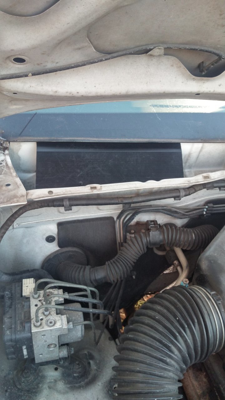

    Termites. Effing wet termites were piled up around the intake.
    I didn't have much time, so i cleaned the area up, sprayed flexseal and made a quick "roof" and put everything back together
