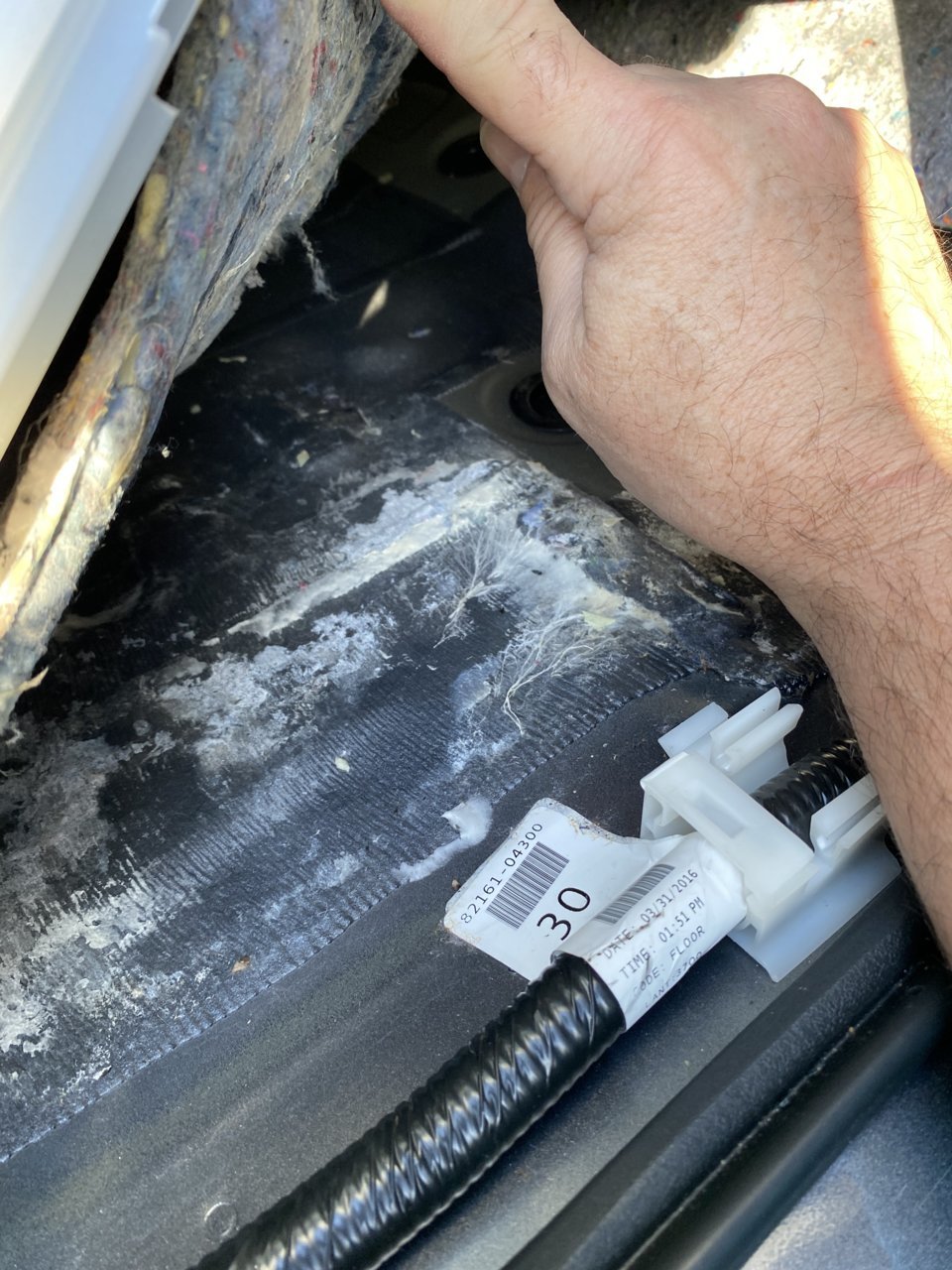

  5. Jan 5, 2023 at 6:19 PM
    #25
    Treerat
    Treerat Well-Known Member
    Jul 4, 2016
    #191185
    62
    Louisiana
    2016 TSS Grey 4 Door V6 Special Edition SR5
    Same issue with moisture here in Baton Rouge. Musty smell and damp moist interior especially at night. Did research today and found both the rear vents behind seats were leaking. Pushed tabs to get enough gap and used a tube of marine silicone to seal. Took out under seat storage and damp but not bad but moldy where floor meets back wall. Treated with bleach solution and let dry very good. Figured I detail clean inside. While vacuuming front drivers floor, water was coming to surface of carpet. Pull trim and looked under carpet, horrible smell and puddling water. It is the low point so I guess I have a bigger issue than originally thought. Called dealership and I’m just out of warranty and no help there. Will start with insurance company in morning. Carpet gotta come out!

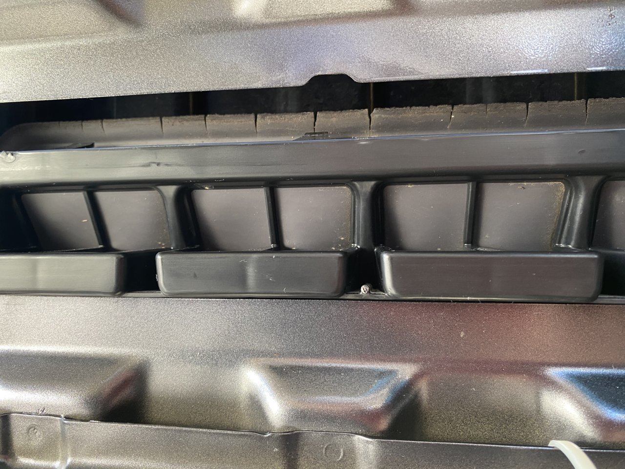

  15. Jan 9, 2023 at 11:16 AM
    #35
    DES2009
    DES2009 Minister of Truth
    Jul 22, 2014
    #134426
    1,000,539
    Southeast Louisiana
    2017 MGM Limited
    I'm a Millionaire! One Million Posts!!
    Is this the culprit in your case? Where is this?
    The picture is zoomed in so close I don't know what I'm looking at.. o_O
    TheWildMan likes this.

  17. Jan 9, 2023 at 1:55 PM
    #37
    Perfuseme
    Perfuseme Well-Known Member
    Feb 16, 2016
    #178419
    426
    Rick
    That’s what she said
  18. Jan 9, 2023 at 5:37 PM
    #38
    Jimmyh
    Jimmyh Well-Known Member
    May 16, 2012
    #78991
    14,206
    SC
    2012 Prerunner SR5
    Pretty sure you do have a cabin vent back there. It acts like a check valve and allows the air to blow out and prevent anything coming in. More like a flapper valve. If it wasn't there the doors would be hard to close/latch due to the air pressure buildup when slamming the doors shut.
    Looks like this on the inside of the cab.
    https://www.tacomaworld.com/threads/truck-cab-rear-pressure-vent-research-experiment.124909/
    https://www.tacomaworld.com/threads...essure-relief-vents-behind-rear-seats.503508/
